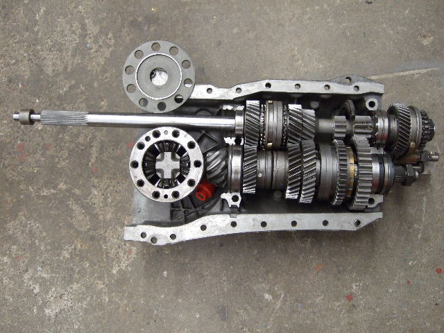

Hi Tony. Yes the high torque box has the different material for the CnP and a few other small things. But it still has the dreaded undercuts on 5th and the reduced spline sleeve coupler on the input shaft.
My shaft is a lot longer than the wellknown upgrade one as Ive used a chev bellhousing and put my adapter plate between the box and the rear of the bellhousing so the shaft needed to be about 2" more.
I took the original shaft, and a few ideas on paper to a good machining company that deals in shaft and gear design/manufacture. I showed the foreman some photos of a 1-peice shaft, we tossed around a few ideas, done a few measurements and he said "no problem!"
To make the new gears, they simply machined off the gears and shrunk and welded on a new billet, then cut the new gear teeth into the billet and hardened it accordingly. This saved a lot of remanufacturing of the gear. They do this as part of their business and have none ever fail.
The first gear is straight cut because of restrictions in size of the cutting head up to the reverse gear teeth. No biggie.
Ive attached a pikky of my gearbox so far. The diff unit is a 4-spider from a 369 box and the round plate above it is the spacer for it.

Tony, yep same stuff I had mine made out of en36.
Oh just one thing though, to make the shaft diameter bigger at the bearings, have the centre of the bearing bored out, say 1mm to give you a 2mm larger shaft size. There are no oversize bearings available, so hence boring the centre out. There are a few other parts like washers, sleeves etc that need to be bored to suit but again, no biggie.

Remember that reverse gear usually uses 3 gears to do the job. The first gear is using just 2. The straight cut is due to the size of the gear cutter. A helical cut one would hit the reverse gear teeth if it was used. The factory used some other sort of cutter, I believe to be very expensive and hence not stocked by too many gearcutting companies.
