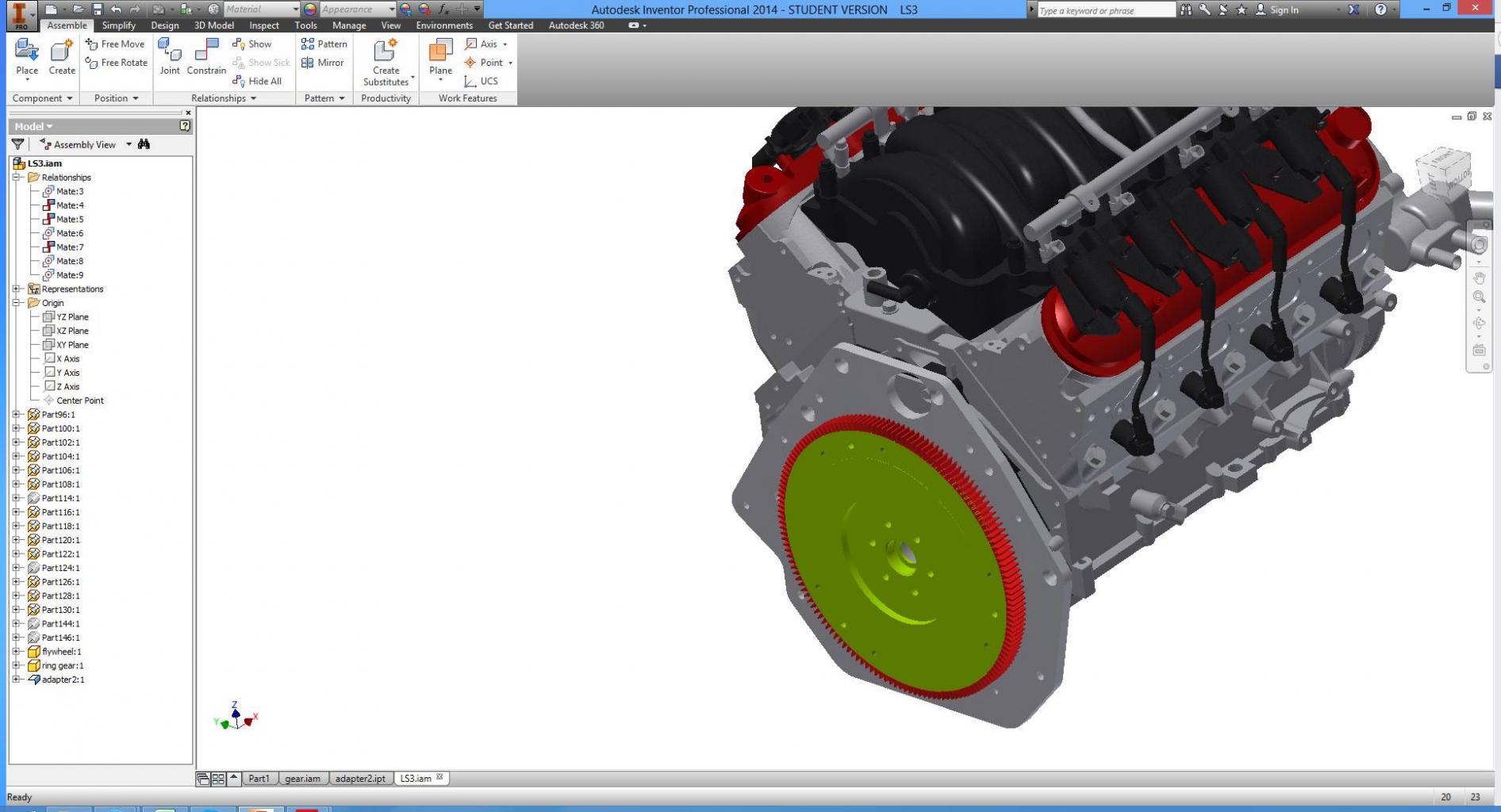

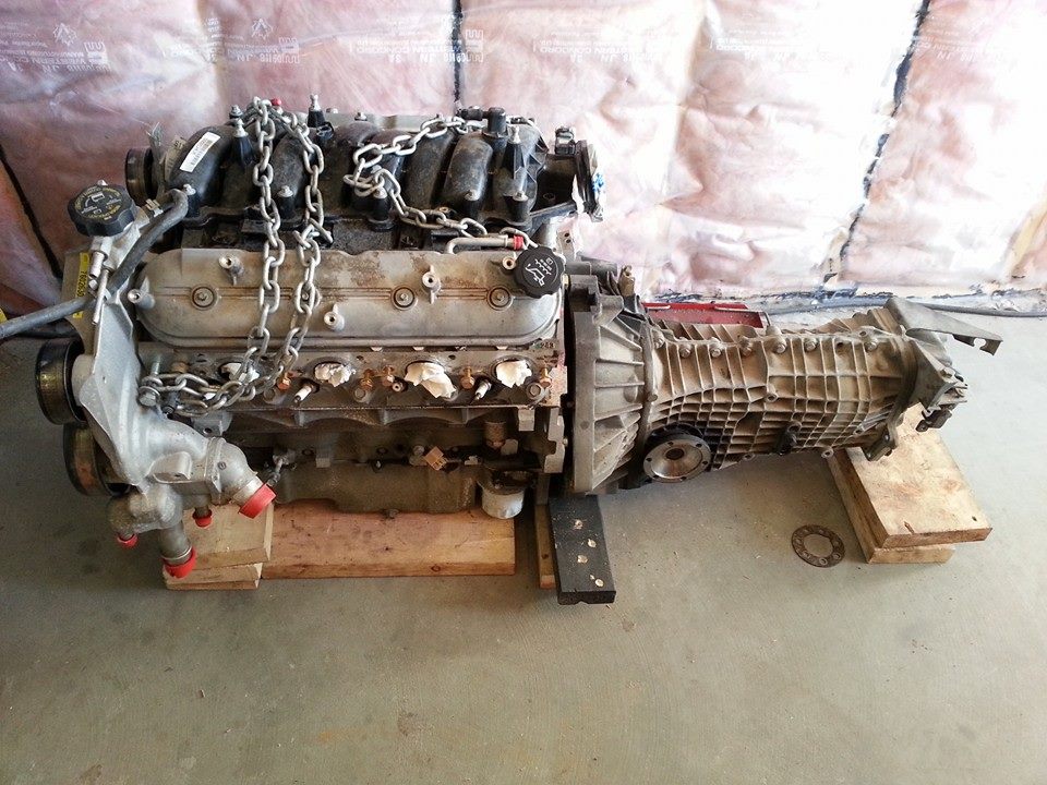

I am in the process of swapping in a LS4 (5.3L v8 fwd platform) in my 82 Delorean. So beefing up the transmission is a must.
I am planning on doing a refresh (seals, roll pins, bearings) and clean it up. However, to handle the power I need to upgrade the coupler for the input shaft I am told.
So my question is: Is there a central location to get a rebuild kit or all the components for a rebuild? Or even just a list of everything I would need. Also, a delorean vendor has an upgraded coupler for the input shaft but are there any other options?
Something else I have considered is getting a taller 5th gear. The delorean trans has a 0.82 gr and I hear there is a 0.76 out there. Would anyone have this gear?
I have early in this project, but I have included a few pictures of my progress for you guys!
Thanks in advance,
Josh
