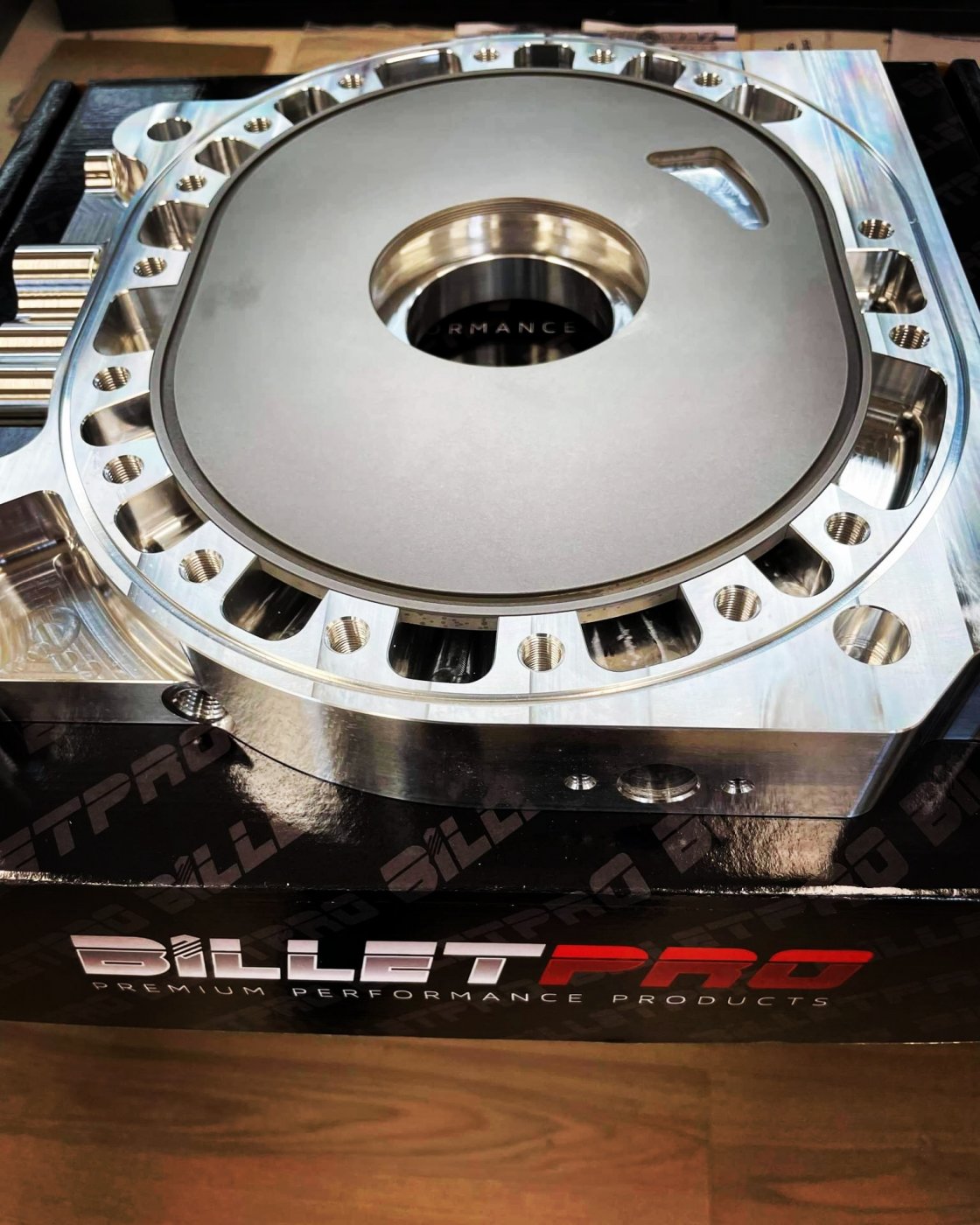

5 Rotor, first one in the world. Crank shaft is currently off for balancing. We plan to run a billet engine, full peripheral port, and a modified g57 turbo to achieve around 1500rwhp and produce a v10 f1 sound. Rotary fires 1x per rev, 4 stroke piston fires once ever other rev. With the 72* lobe angle offsets, and an equal length 5 into 1 collector with merge angle and collector design mimicking the 787b 4 rotor, we theorize it should sound identical to a v10 f1 at 18,000 when running at 9k rpm. Major third harmonic, 1 being root tonic, and the 3rd and octave above the root.

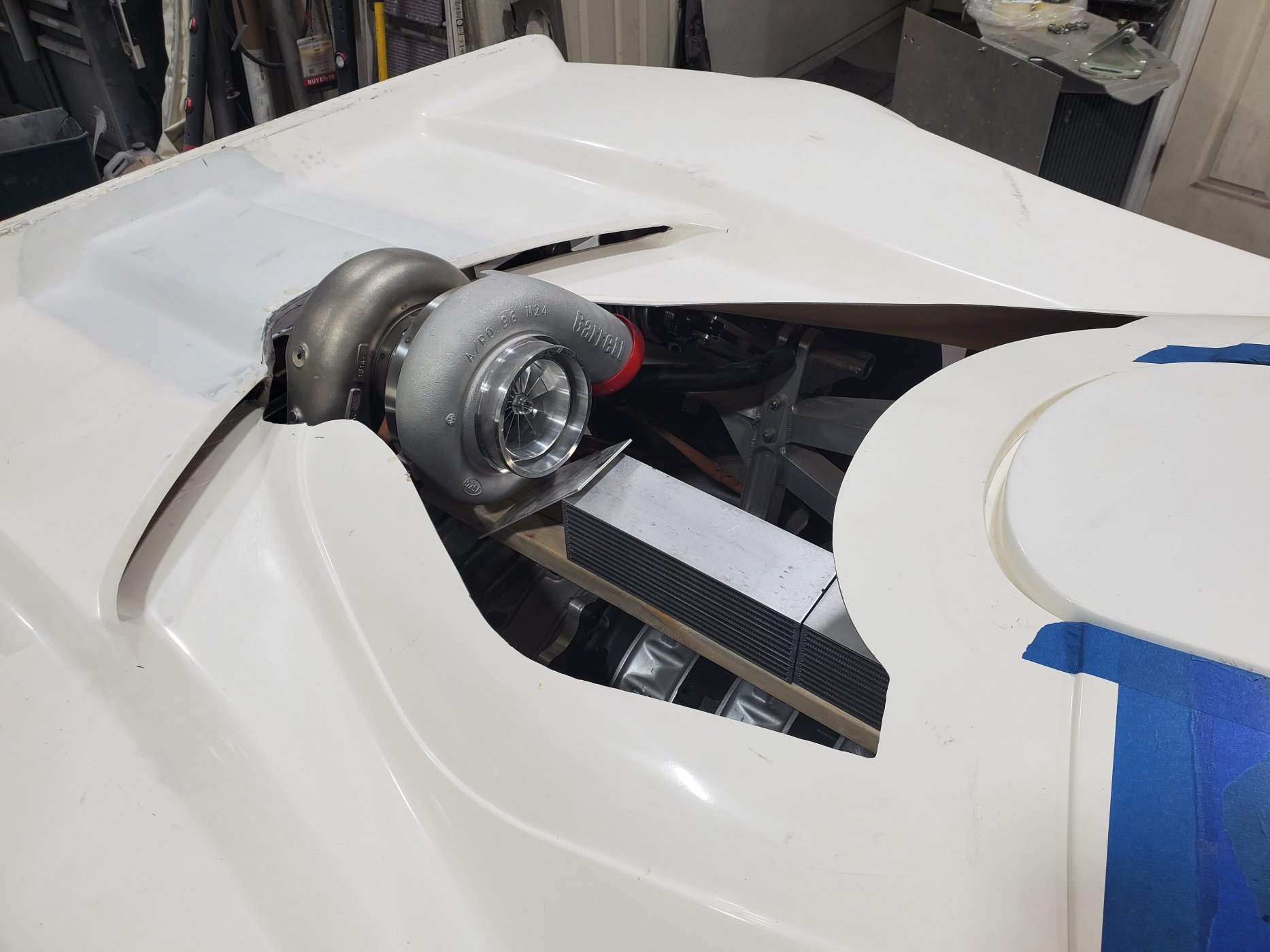

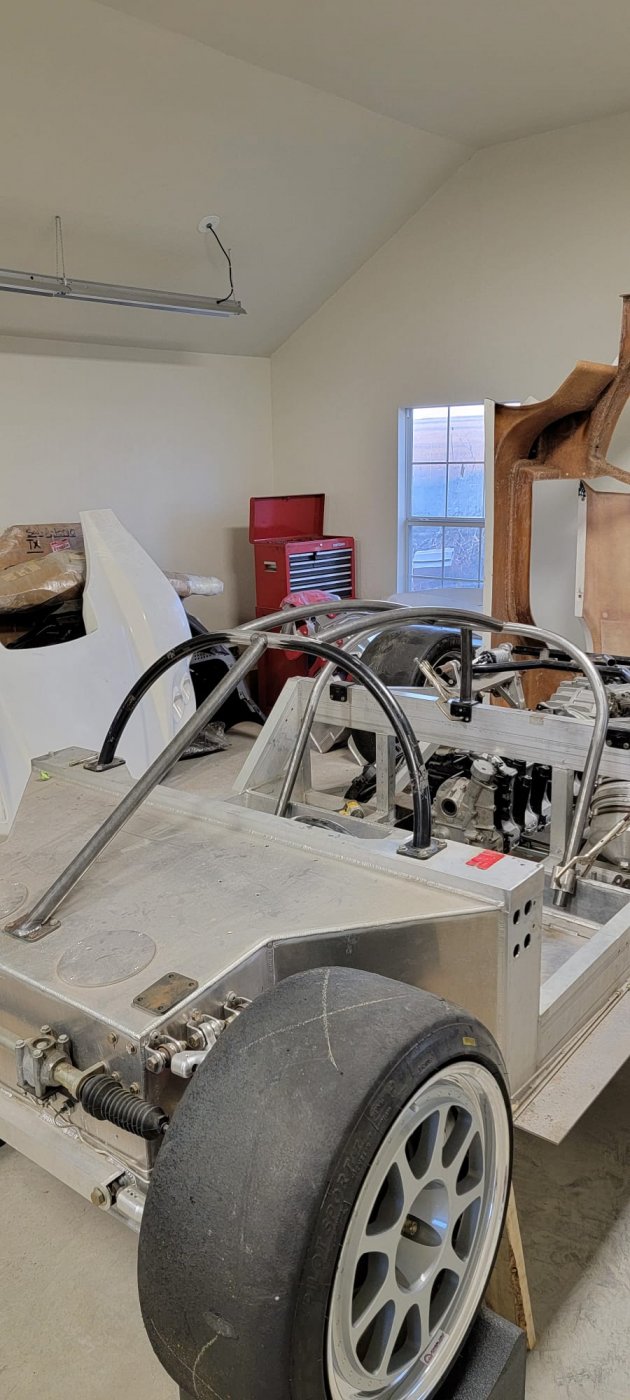

Current progress:

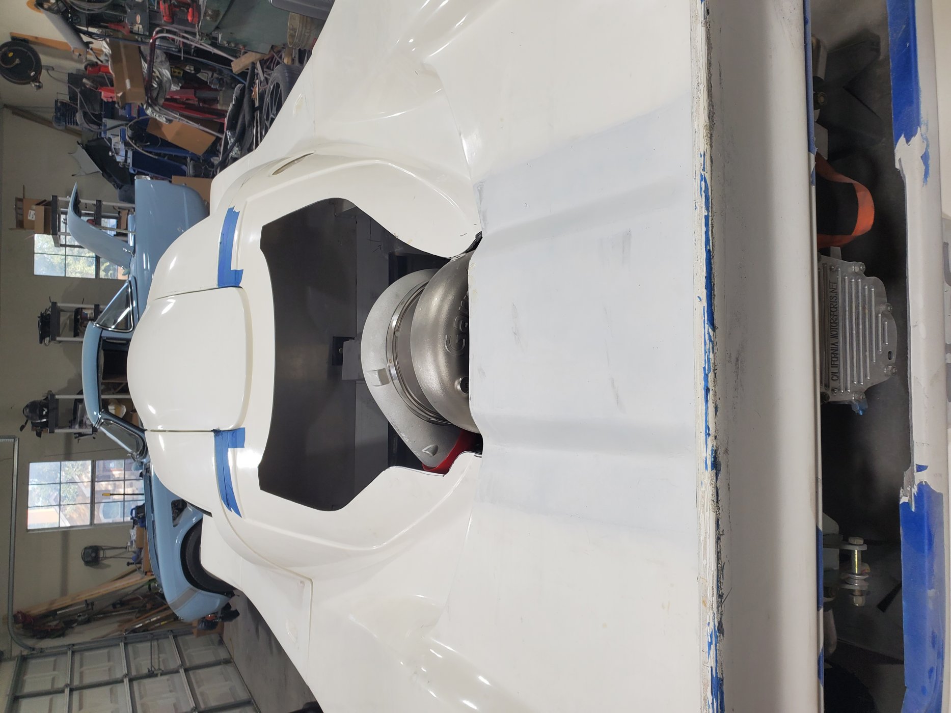

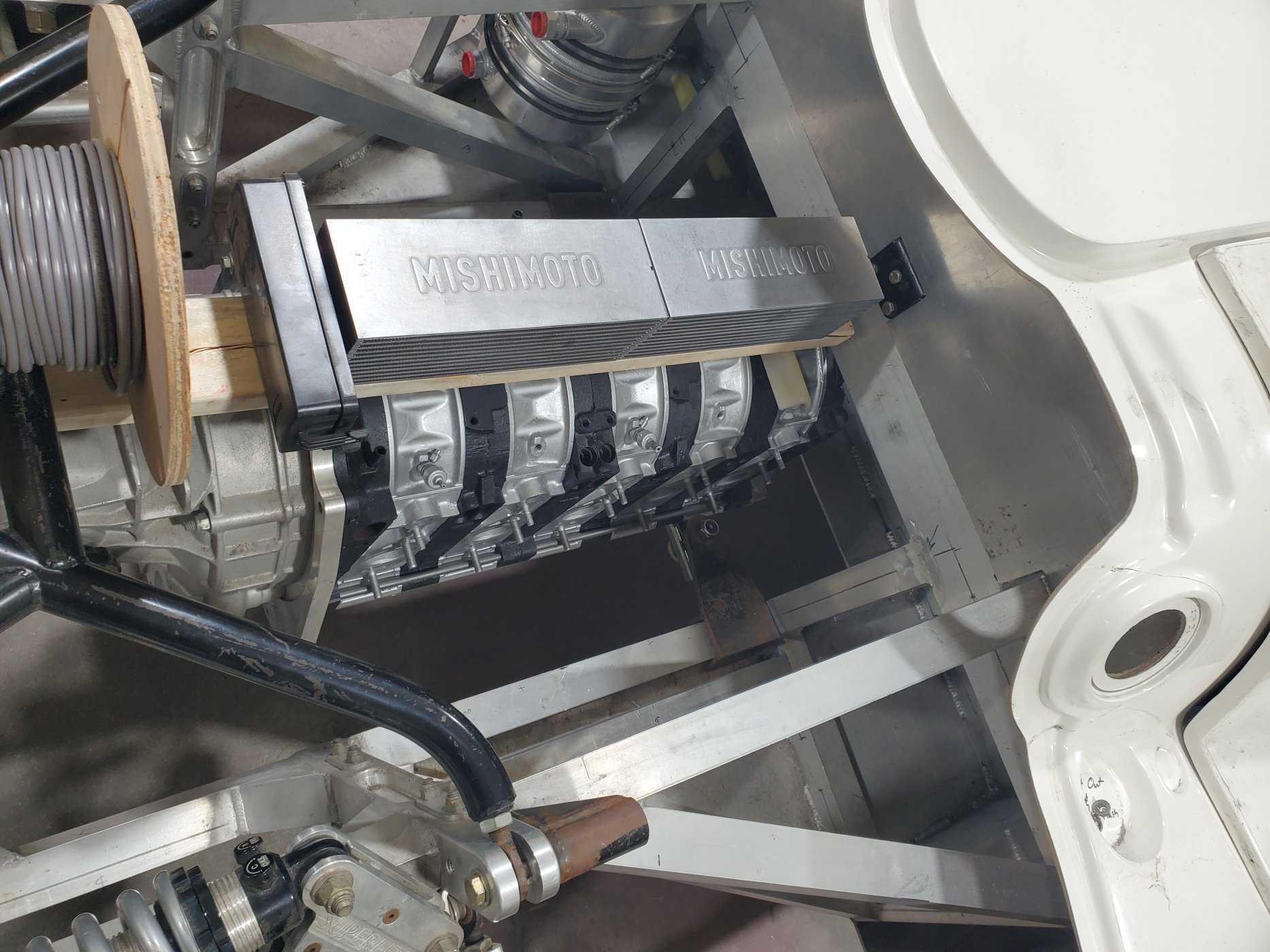

Firewall Cut, dummy block fitted with a g52 transaxle. Will be using the dummy block and transaxle until the MXT arrives from Hollinger. Dimensionally they're very similar so this should allow us to fabricate the fuel tank/turbo/manifolds etc
Body sitting on frame.

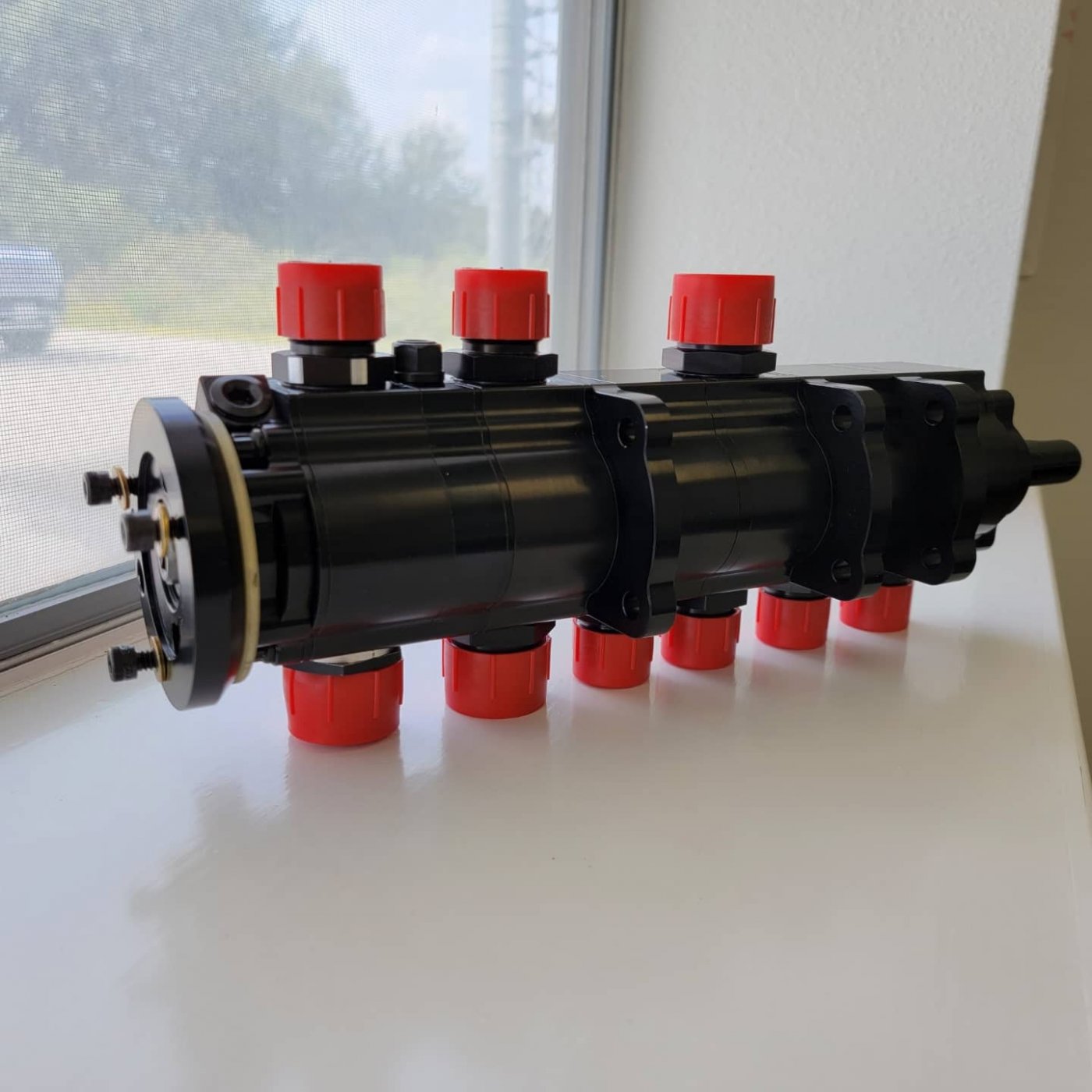

Planning to run a sump on bottom of custom fuel tank, that is equal depth to bottom of frame rail, and run a pickup up to mechanical fuel pump that will be cable drive off the dry sump pump

Is that the factory race cage? Or are you building a custom one?
Bob

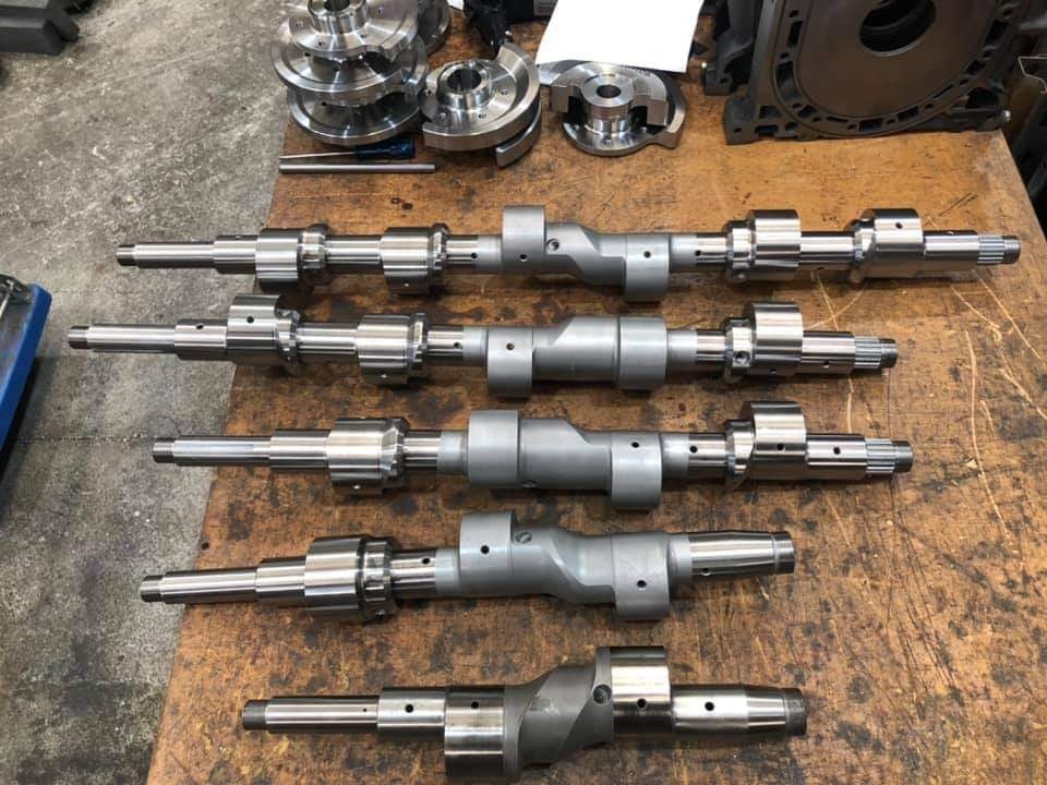

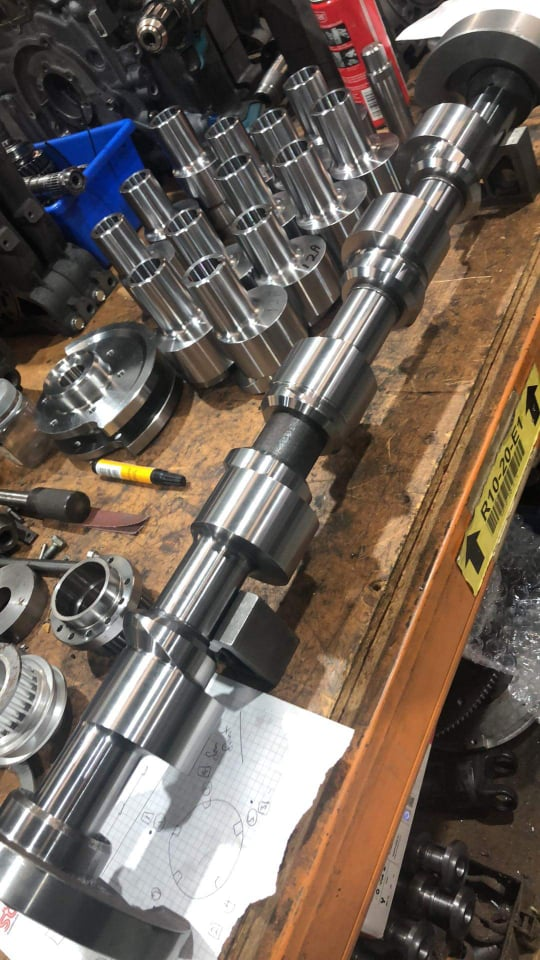

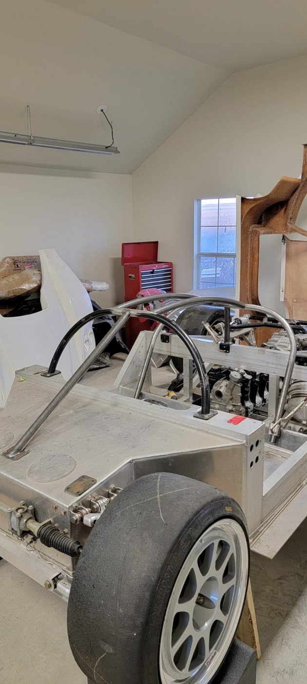

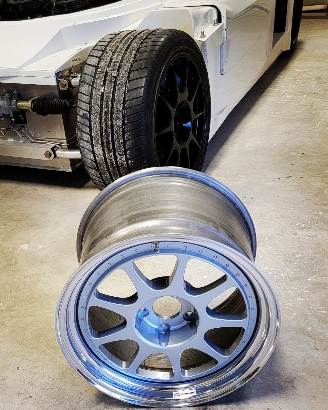

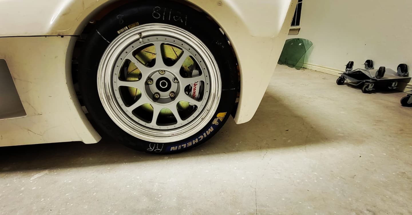

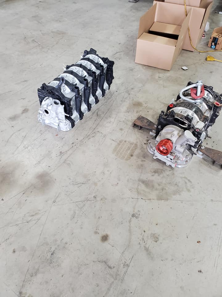

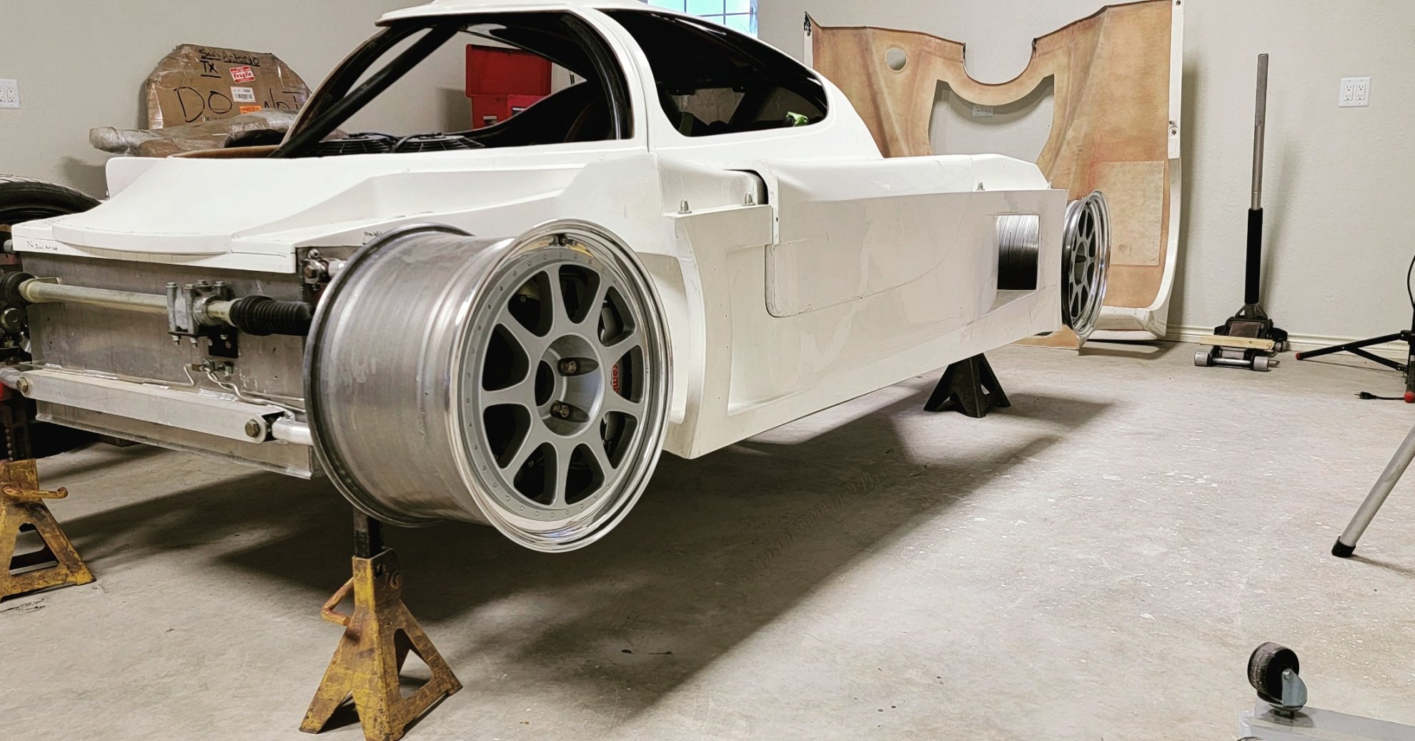

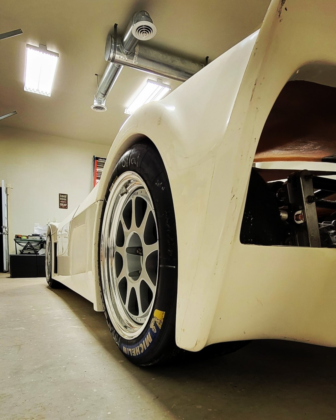

Wheel, floor pan mod for seats, prepping for new chomoly cage additions, crank shaft under development, billet plates development
