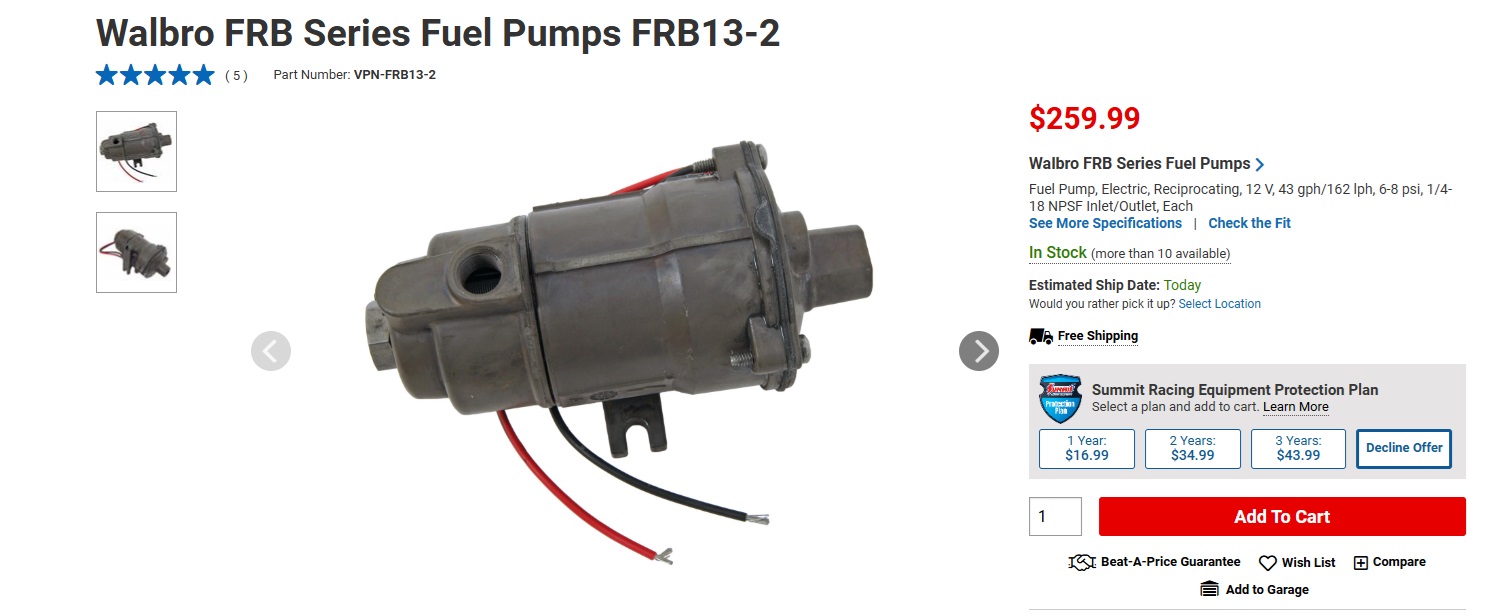

Howdy All!
Actively planning an RCR build while waiting on kit delivery.
I keep going back and forth on a fuel system design. I plan on using a simple "returnless" fuel system feeding a Holly 4bbl @ 6PSI. The engine is rated at less than 500HP, so theoretically 41GPM is required at continous WOT.
I have combed the various threads on fuel pumps - types / flow rates / arrangments, each with various pros and cons in regards to noise, performance, reliability, simplicity, and aesthetics.
During my planning / research I noticed no one has discussed this type of pump...
This Walbro pump is rated at 43gpm, has an internal 70micron suction filter, can dry lift 48in, and has an internal check valve.
While not period correct, I do think this pump would be somewhat aesthetically pleasing if installed in a similar arrangement to the original car(s).
Does anyone have experience with this style Walbro pump? Stewart Warner has something near idenitcal, but with less features.
I suspect the main reason not many have discussed this type of pump is likely the cost, check out walbro type pumps on your favorite auction site and you'll find plenty of options that will pump more than you need for about £35, I use just such a pump in my car with a coyote crate engine. I run a simple system that uses one submerged pump in the left tank only and has never faulted, it works for all your common BMW M types and other hi performance production cars for tens of thousands of miles so I don't see why it shouldn't suffice a GT40 that's going to be treated with kid gloves.
