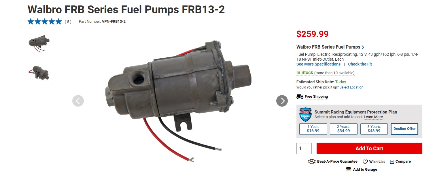

Howdy All!
Actively planning an RCR build while waiting on kit delivery.
I keep going back and forth on a fuel system design. I plan on using a simple "returnless" fuel system feeding a Holly 4bbl @ 6PSI. The engine is rated at less than 500HP, so theoretically 41GPM is required at continous WOT.
I have combed the various threads on fuel pumps - types / flow rates / arrangments, each with various pros and cons in regards to noise, performance, reliability, simplicity, and aesthetics.
During my planning / research I noticed no one has discussed this type of pump...
This Walbro pump is rated at 43gpm, has an internal 70micron suction filter, can dry lift 48in, and has an internal check valve.
While not period correct, I do think this pump would be somewhat aesthetically pleasing if installed in a similar arrangement to the original car(s).
Does anyone have experience with this style Walbro pump? Stewart Warner has something near idenitcal, but with less features.
I suspect the main reason not many have discussed this type of pump is likely the cost, check out walbro type pumps on your favorite auction site and you'll find plenty of options that will pump more than you need for about £35, I use just such a pump in my car with a coyote crate engine. I run a simple system that uses one submerged pump in the left tank only and has never faulted, it works for all your common BMW M types and other hi performance production cars for tens of thousands of miles so I don't see why it shouldn't suffice a GT40 that's going to be treated with kid gloves.

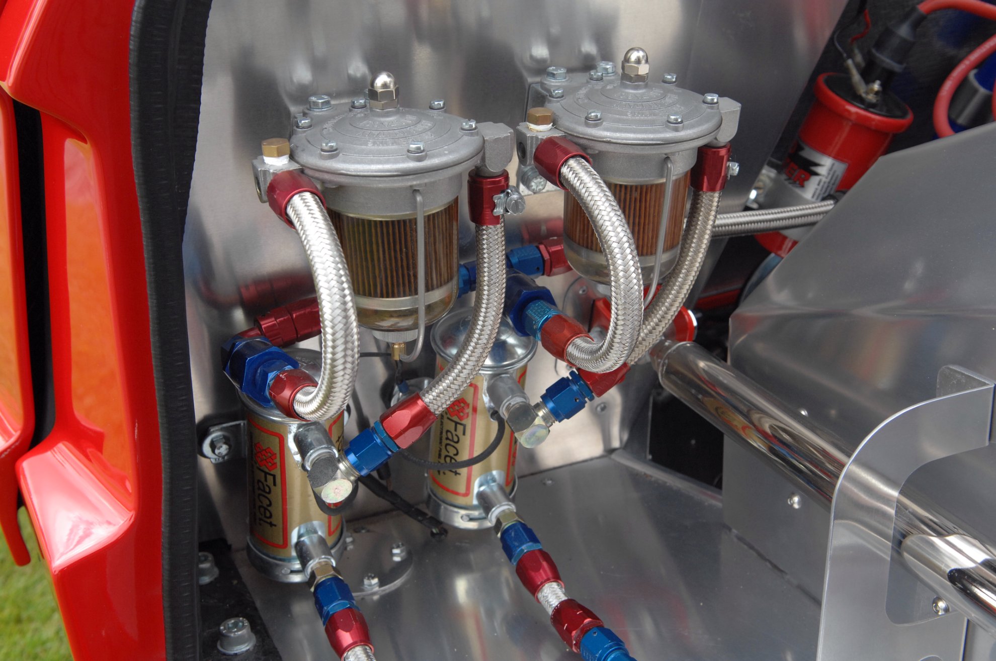

Here's a photo of my installation with 2 facet fuels pumps feeding Filter King filters/pressure regulators. There are non-return valves in the lines. Carb is a 4 barrel Edelbroke. Engine Ford 302. The engine is a full rebuild with lots of high performance parts. Fundamentally it's a new engine in an old casting. The engine serial number and therefore it's age are important in getting the car through our very tuff IVA requirements.
On the dash I have a 2-way switch to select either pump/tank and I have 2 fuel gauges.

Beware of those fuel filters. I had the bowl gasket blow out of one in my Porsche 911 and it burned to the ground. In a mid/rear engine car you are the last to know that you're on fire.
Hi Neil,
Just in case your comment causes readers concern ..... the installation was completed 15 years ago and so far had no problems. I guess it's like everything in life... stuff can fail. For your information I'm in northern Arizona in April, although not close to you. Me and my partner are doing a circular trip through southern Utah and then into Arizona to drive along Route 66 from Williams to Kingman. Sadly in a hire car and not with the GT40.
