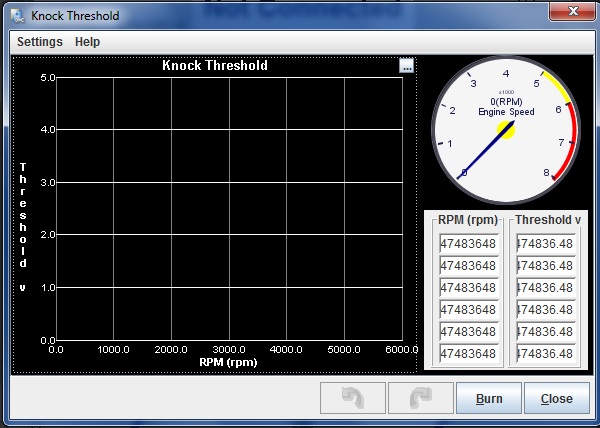

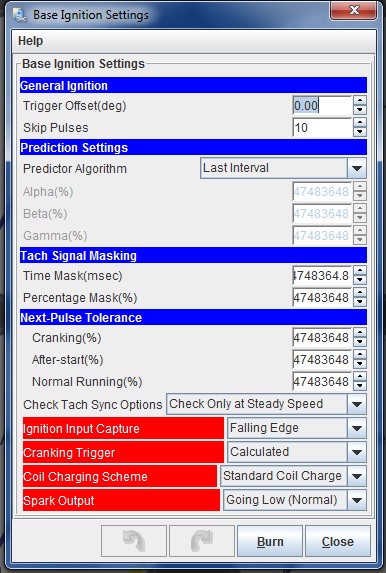

I have knock sensors and a wideband o2 - hardware is all taken care of. What I need though, is settings or defaults for that hardware. When I see something like the attached images (the values pictured are just gibberish), I have no idea what to put in. Now, what these setting do is explained well. But, that doesn't educate me on what reasonable values for these things are.
Thanks,
John

John, just from my experience turn off the knock and the closed loop control via the ego sensor, all these functions are great once you have your engine running but can be a nightmare if you don't have the initial parameters correct, and any acceleration enrichments till you get it running on the basic program. Use very little cold start enrichment and add just a little at a time till you find it starting and running. You may have to offset the the injector pulse width on the bottom if your max pulse width is high. Email if you have any questions, I hope you got the program I sent.
What each of those variables mean and how to calculate reasonable starting values is covered extensively in the Mega Manual. If you expect to install, program, and tune your own EFI system, it's advisable that you be very familiar with all of the parameters involved.
Also check out the previously linked Megasquirt forums. You're much more likely to find good Megasquirt-specific answers there than you are here.
