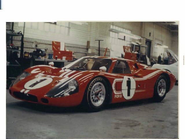

Mk IV in KarKraft shop 1967
This is actually Mario Andretti's Mk IV that crashed and was repainted to look like the Gurney/Foyt winning car. Note lack of bubble.

On a more serious note, the damaged honeycomb was replaced by plywood laminated with aluminum sheet. If you'll remember, Andretti was involved in a crash just after leaving the pits. He forgot to pump the brakes after the pads were replaced, consequently late braking was too late.

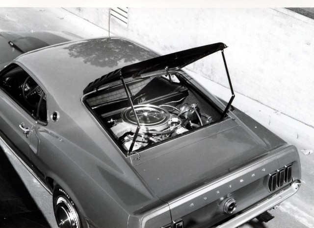

Rick... I would then presume that this is the "other" Mach I mid...? :-)

Rick: There were three Mach II's. One was a show version. The one you see in the background in the above photo of the Mk IV was the super-light race version at just a bit over 1,700 lb. Power was a Bud Moore 302 driving through a ZF transaxle. Pictured below is the bare chassis of the third car. Shown is a torsional rigidity test I was doing on it, which indicated we needed to add a few diagonals in the rear section.
Car was faster than the Mk IV on the short Dearborn test track. Alan Moffat test drove the car while he was playing third fiddle in the TransAm series.

Speed 220, that's cool that you have first-hand knowledge. What's your first name, anyway?
attachment.php
From this picture it looks like the engine is sitting directly over the rear axle, suggesting it's an engine/transaxle combo. Is that true or was it another ZF?
My first name, I can remember that, it's Tom.
About your second question, I wasn't that involved in the car you pictured, albeit somewhat familiar. The transaxle was similar to a FWD like that used in the Olds Toronado. Further than that, I don't know.
Regards, Tom

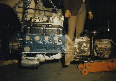

Rick: Here's the Bud Moore 302 with ZF attached ready to be installed in the white Mach II. The legs belong to Alan Moffat. He's intensely interested because he be making hot laps in the car soon after this engine and transaxle are installed.

I notice the ZF is installed in the "GT40" posistion rather than the "Pantera" posistion (flipped).
I never knew how developed the Mach was, I always assumed it was just a rough "mule" and more of a show car than a development unit. I have seen some Ford "mules" that were really rough and cobbled together.

The Mach II was about handling, so we got the engine as low as possible, thus the transaxle orientation.

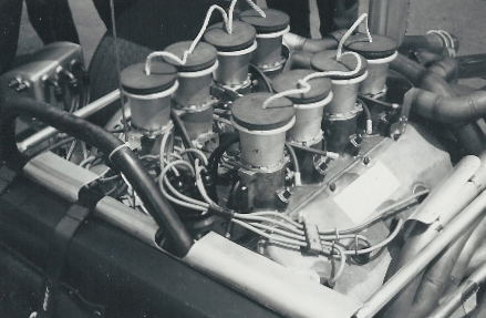

Here's another picture, a MkIV on the surface plate with the Mach II show car in the background. The MkIV was undergoing a coversion to a G7-A CanAm car. The second photo shows the three-valve engine in the G7-A.

I thought Andretti said that the brake pad was put in the wrong way round!

Allen: You're right, that's what Mario said. I believed the same thing until I talked with someone who actually knew what happened. Again, Mario neglected to bring the new pads up against the rotors by pumping the brakes before he actually had to use them. Keep in mind, those were the days drivers found excuses for crashing that weren't their faults! You don't suppose they still do it?

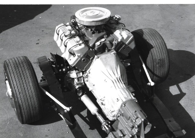

Gents.... here's a drive train pic that I have. What I know is that they were KarKraft PN-xxxxxx transfer cases. I actually know of one of these in a guys garage, even has the "xxxxx" numbers on it. Anyway.... hope you enjoy the pic.

This setup was done after the Mach II I pictured. The car was done in an effort to reduce costs using a C6 automatic with a transfer case. T&C (Transmission and Chassis division) nixed the deal if a transaxle was used, i.e., the ZF. And Ford wouldn't build a car of any kind that didn't use all Ford driveline components. It would cost them too much to tool up for a low-volume car. We ran into this all the time when dealing with the degreed pin-head Product Planners. I can tell you of many such stories. Cars we had on the boards and in prototype were killed by the planners. The mini van, FWD T-Bird (became a Toronado) and 90-inch wheelbase, Cosworth powered two seater are three examples.
Bob Bracey told me a couple years ago that the ring and pinion from the T44 was from the FWD T Bird or the rear engine Mustang, I can't remember. From the pictures it looks like it was probably the FWD T Bird. Weisman was going to use them in there own transaxle but never did.
Mario's bronze car did have white Ford lettering. Wonder why they kept it when the repainted it red?

I have seen that trans set-up in pictures of the prototype/mule 1961 FWD T-Bird. My understanding is that T&C didn't have CV joints that could take the 390 FEs torque with out "warranty" issues so the program was nixed. The T-Bird FWD was pre-C6 era so it used a medium case MX trans (or possible the large case from the Lincoln, in the pictures i saw you could not tell)

Notice that the carrier is a "N" (nodular) case unit....taking no chances.....
