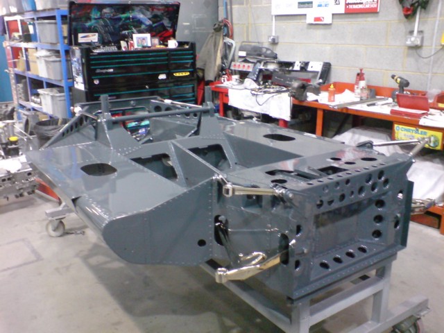

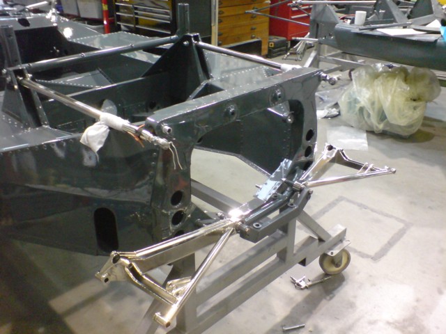

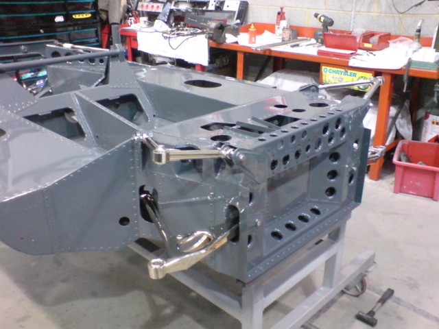

As its so quiet, I thought I'd post a couple of pics of what I've been up to at work this week. A bit of inspiration for all you budding Spyder builders out there.

Some very nice work there!!! Is the chassis powdercoated? The control arms are just works of art! :)
It is superb ! Tell us more ? I am curious as to the prep of the aluminum prior to the gray coat...
Also, did you use purple rivets ? (wink)

Randy, Not powder coated just good old paint. Johan, all ali was 120 grit DA'd and etch primed. And yes, lots of purple rivets. Oh and it's SL71/24. Just had a full chassis resto and being reassembled by another preparer. Should look stunning when it hits the track this season. Gregg, the chassis in the background is a Mk3 SL73/110. haning a major overhaul before this season and the LM Classis.
