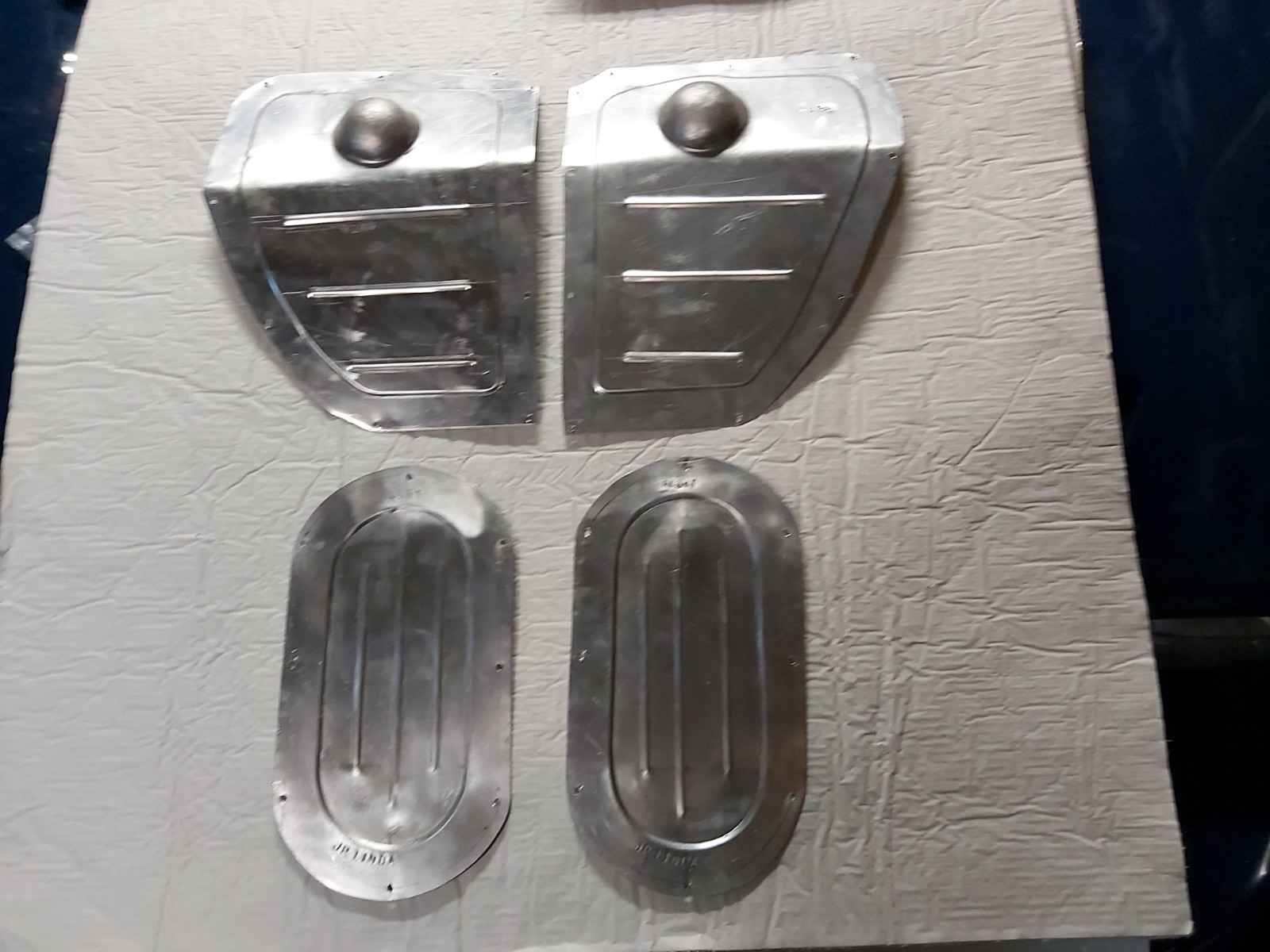

Hi
Looking for images of the two panels forward of the front wheels and behind the headlights, specifically for a mk2 (if its different from mki) Photos of the panels are rare and some have bump to clear headlight connector.

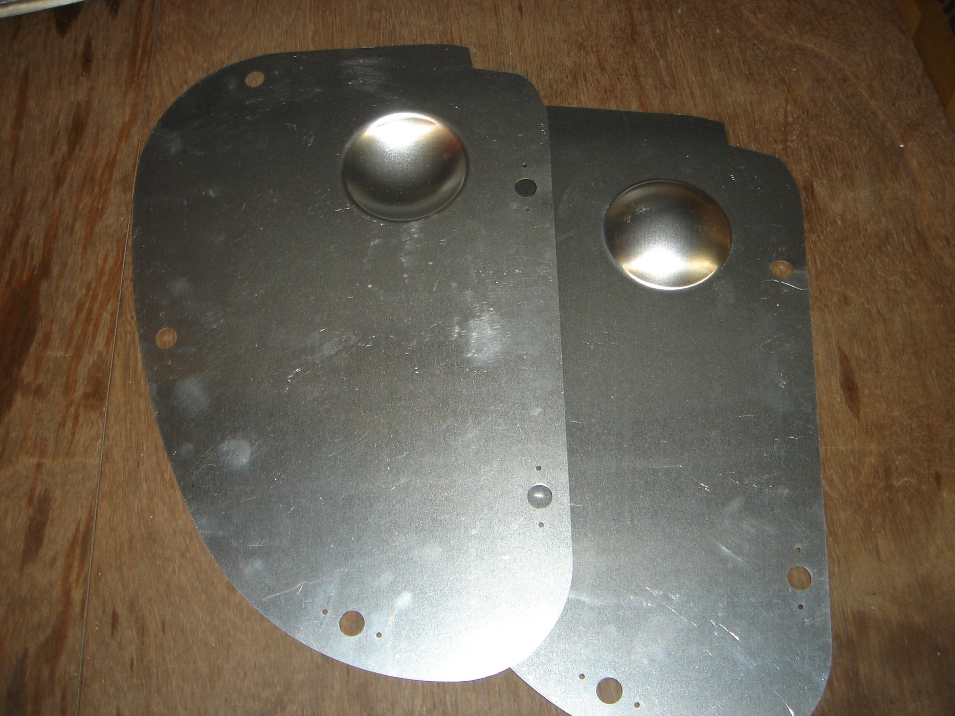

Do you mean these..... (for my Mk 1)
I used MacGyver tape as a template and as a form. The inner carton roll as template as it has the perfect diameter to I drawed the circle on a piece of alloy panel.
Then I used the full roll as a form to hammer the half tennisball into it. It has the perfect circle and dept.
I used an egg shape mallet and heated up the spot several times to soften the alloy.
Both pannels where made within 30 minuts, I let my own creativity go. Created from 1mm aloy sheet. The half tennisballs are very thin now..
