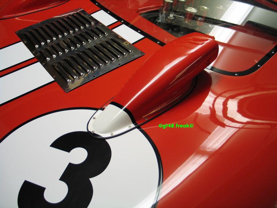

MKII Rear Brake Scoops, my summer project
Very Nice Work! One minor point. On the street you probably don't want to hook these ducts up. On my MK-IV I've found that for street driving if anything the brakes over cool.

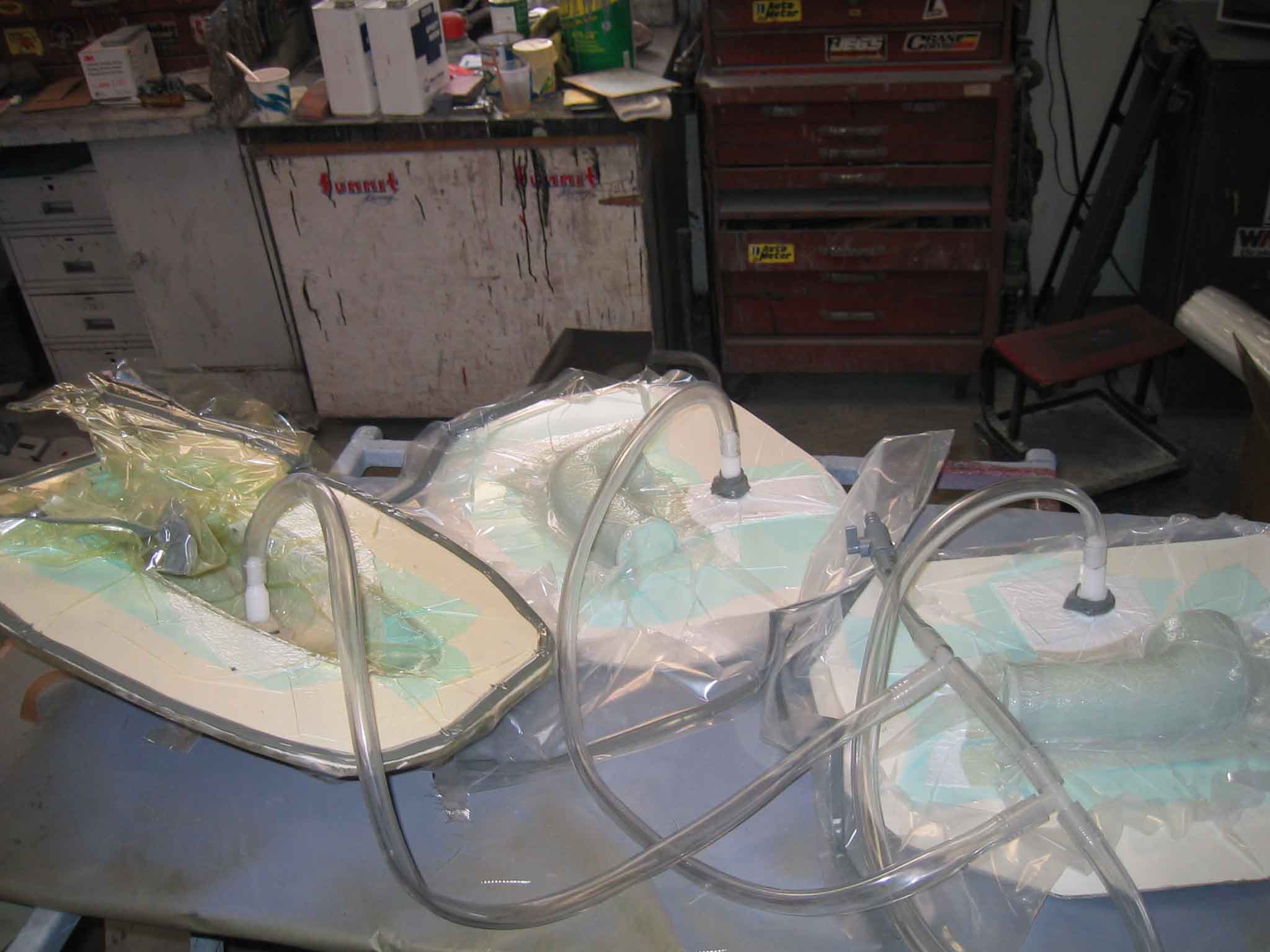

Of course other body parts can be vacuum bagged as well. I'm not sure if anyone does it. That brings up one good point. You shouldn't buy bodywork made of carbon unless the parts are vacuum bagged. It is a waste of money. The greatest weight savings is with using fabric instead of chopped strand mat, (fiberglass or otherwise) and vacuum bagging it to get rid of the excess resin. If the part still isn't light enough, then you can use carbon.

Rick, you really need those large flanges (3 to 6 inches) on your molds to have a place to seal the bag. For the inner duct pieces, we just bag the whole mold using polyethelene tubes. Just tape up the ends and your're done, no flanges really required. The problem with this though is the rough back side of the mold can poke holes in the bag.
I am sold on vacuum bagging. There is more material cost, and the preparation is a little longer with the cutting of all the fabrics though. The nice thing is that you just kind of get all the material wetted out wihout worring about air bubbles or voids. Then you just bag it, pull a vacuum, and forget about it.

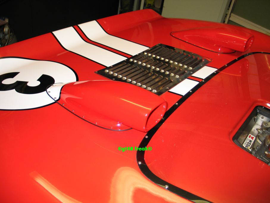

Here are pics of the first car to actually wear a set of our scoops!

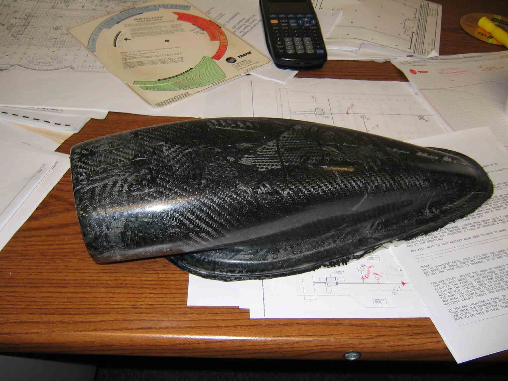

Well we took a break from making these things because they are such a pain. Enough time has passed that I think we forgot, so now we are back at it. Here is the first carbon scoop out of the mold. This thing is STUPID light. /ubbthreads/images/graemlins/grin.gif The carbon is a little different to work with. It doesn't like to be cut into small pieces. It just falls apart. With the twill weave though, this stuff can follow shapes even easier than the plain weave fiberglass that we were using.
