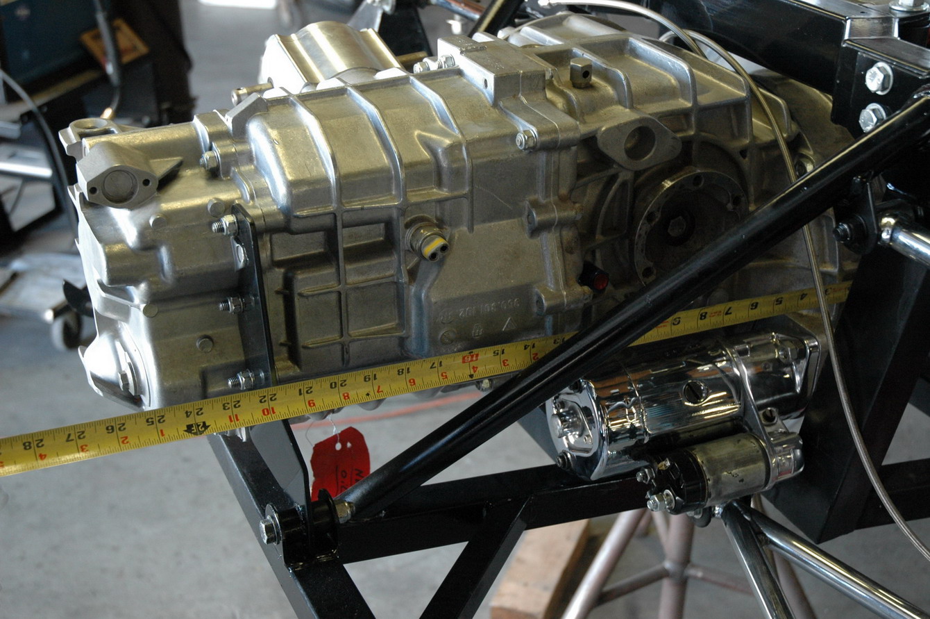

Mendeola sequential 4 speed, every bit of 32+ inches long.

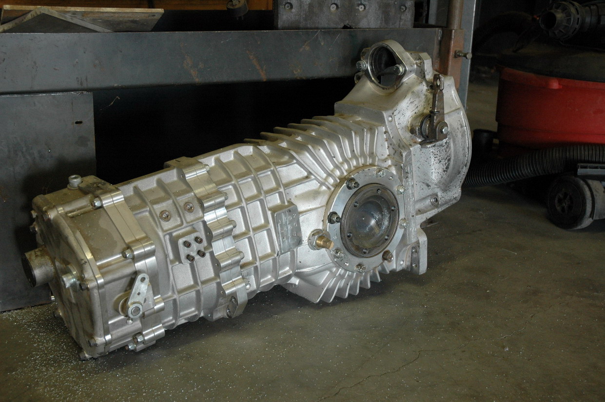

My g50\52 at 26" long. Picture adding another 6" to fit a Mendeola /ubbthreads/images/graemlins/lol.gif

And if length wasn't the issue, if you look closely, there are other issues involve with the Mendeola that won't allow use in a GT40 without major modifications.
