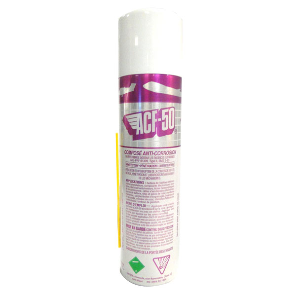

What kind of environment are you in that you need that much corrosion protection? Are you storing this outside at your beach house?
If you already have rust, then clean that off certainly.
ACF-50 is well-regarded in the aviation industry to get into tight areas through capillary action on both aluminum and steel:
