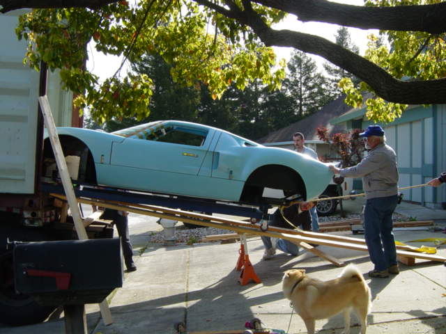

Simon, is there room on the main chassis rails for you to temporarily attach some Caster Wheels?? I unloaded my chassis from the back of a container truck (~ 5 feet above ground level) by using large "U-bolts" to go over the frame rails and thru the caster wheel plates. If this would work for you, then simply put them on before the fork lift puts the chassis on your trailer - - then take some LONG wooden ramps and you should be able to roll it out,
