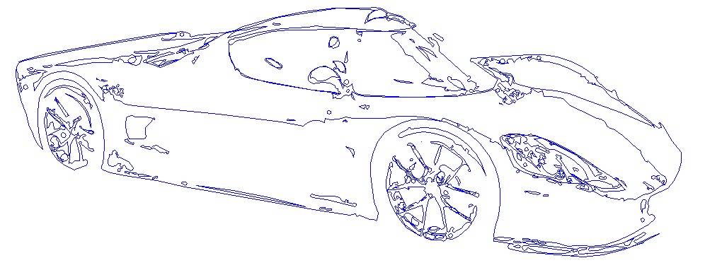

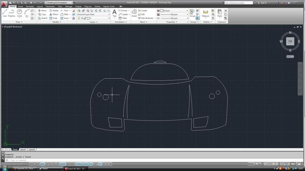

I know the left air intake is a little messed up. I am also not sure on how to do the windshield area. The pic on which I traced. Has the doors open. I just was not sure how it would look. So I left them out. I could always draw some doors on later. I just wonder how I can make it better.

An easy tip is to only to draw half a symmetrical subject and mirror the image around the centerline. That would take care of your air intakes and other irregularities. Save yourself a sh!tload of time in the process too.
Also, the car profile in the link you posted would be WAY easier to do in Illustrator or numerous other graphics oriented programs instead on AD's Autocadd.
Sorry I am getting back so late. I did try the mirror. For some reason every time I would try it. The pic would vanish. After goign in to photo shop. I used the brush tool to trace the out line of the car. Then imported it in to cad. I think it looks pretty good.

I own my own CNC Mill and work with CAD and CAM all day and use Bobcad. It has an add on called Bobart that is great at getting toolpath off pictures. I grabbed a picture of an orange SL C and dragged this off it. Took about 15 minutes with a little cleaning up (one of Fran's babys)
Send me am email and I will send you a DXF for you to use...

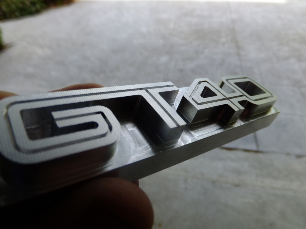

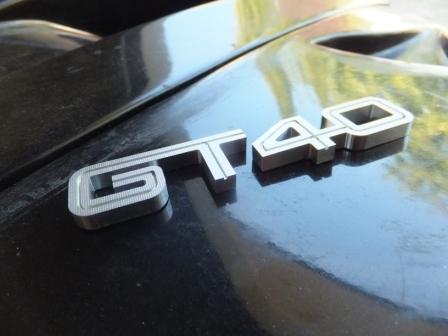

Second picture is of GT40 logo that I came up with to use on my own project build log to start in a little while...

The GT40 is made from a small billet of aluminum. I used 4 tools to make it.
8mm ball end 4 flute carbide, 1mm, 2mm and 4mm carbide. It took a little while as with such small tools I have to be gentle.

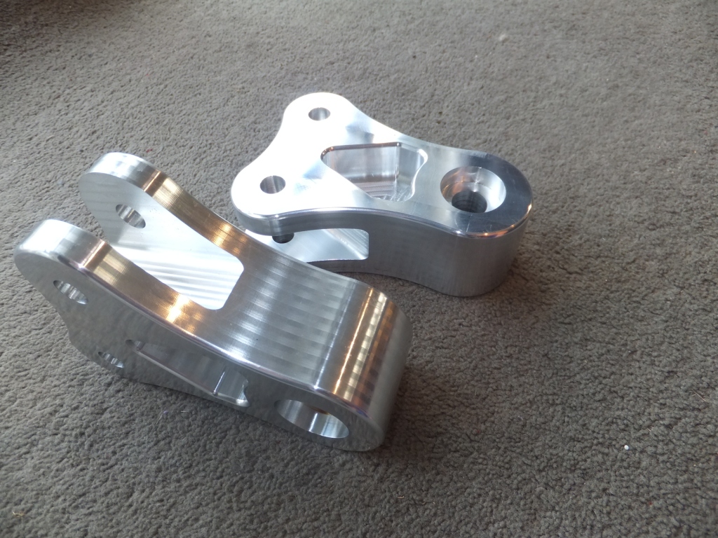

The other pictures are some of the parts I have been making for the GT40..

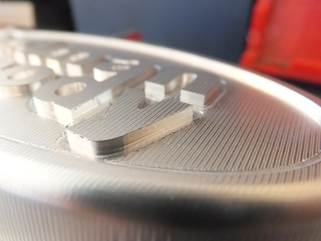

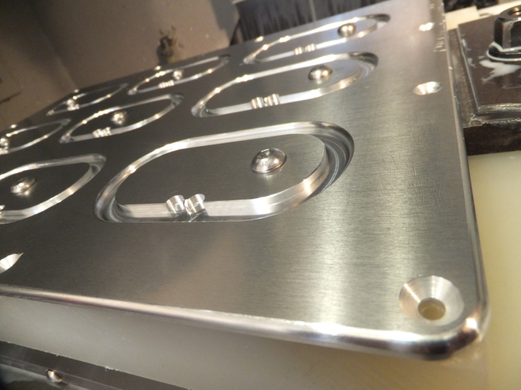

My question is about pic two. It looks like you can see your steps. From every depth of cut. Why not add some cutter comp? We usually add any were from 10-20 thousands. Then our final cut is a clean up cut. So the part is smooth.
Hi Tipptruck1
The parts in the second picture are the rockers for the in-board suspension.
It looks like there are ridges but when you run your finger down the faces it is really smooth. The tool used was a Taegutec 50mm cutter with 5 polished carbide inserts running at 2500 RPM and moving at 1000mm per minute. I usually leave 0.2mm to take off as a finish cut and have done that on these parts.
If I required a super smooth finish I could have used a 20mm long series carbide (Max 76mm cut length) at 1200 RPM but when you get a large amount of flute engagement often you end up with harmonics through the tool which doesn't help the surface finish. Not to mention it is a lot slower and requires extra toolpath and tool offset setting.

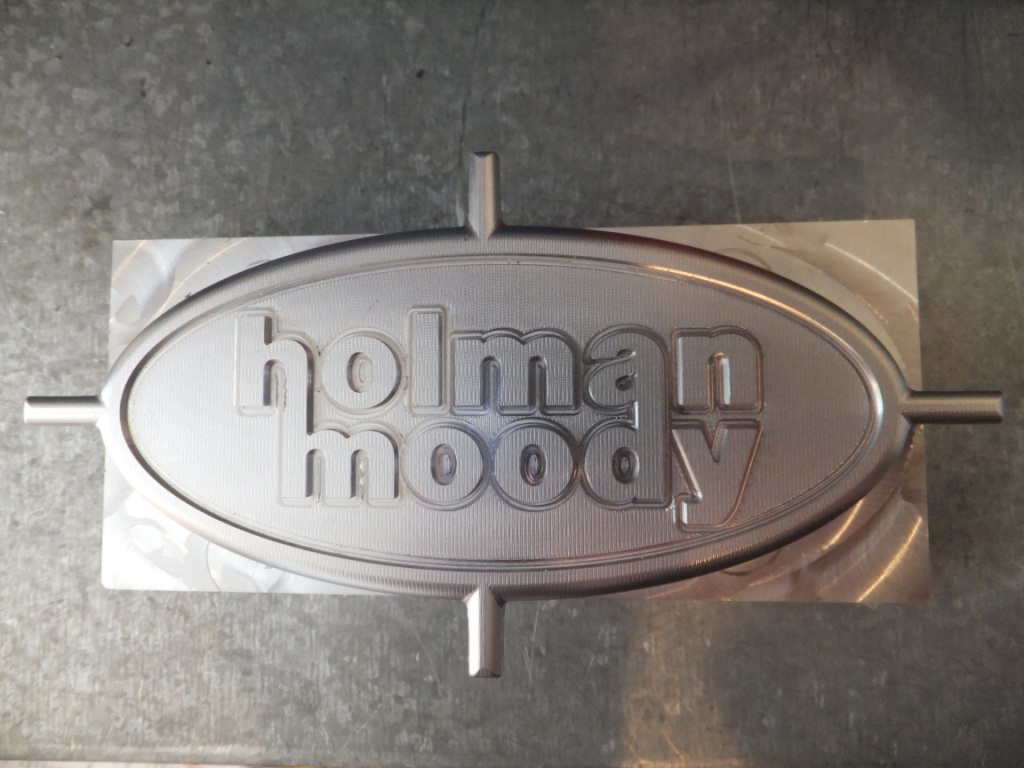

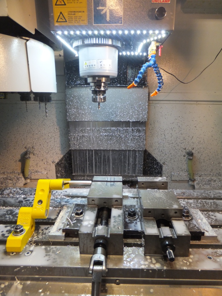

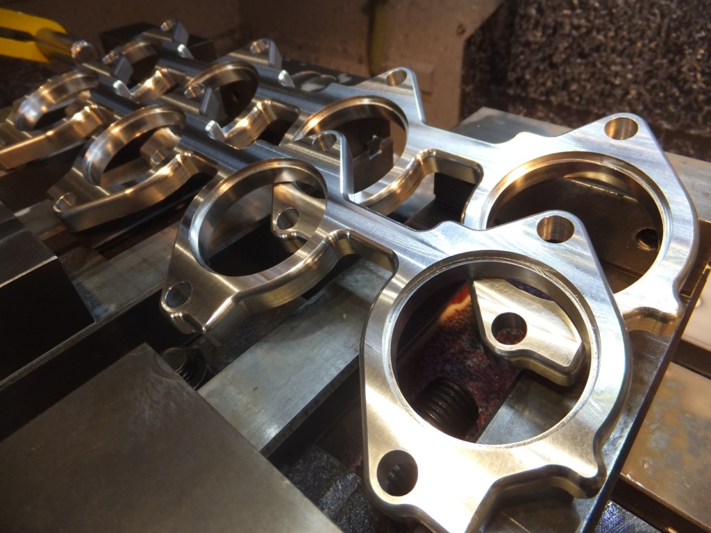

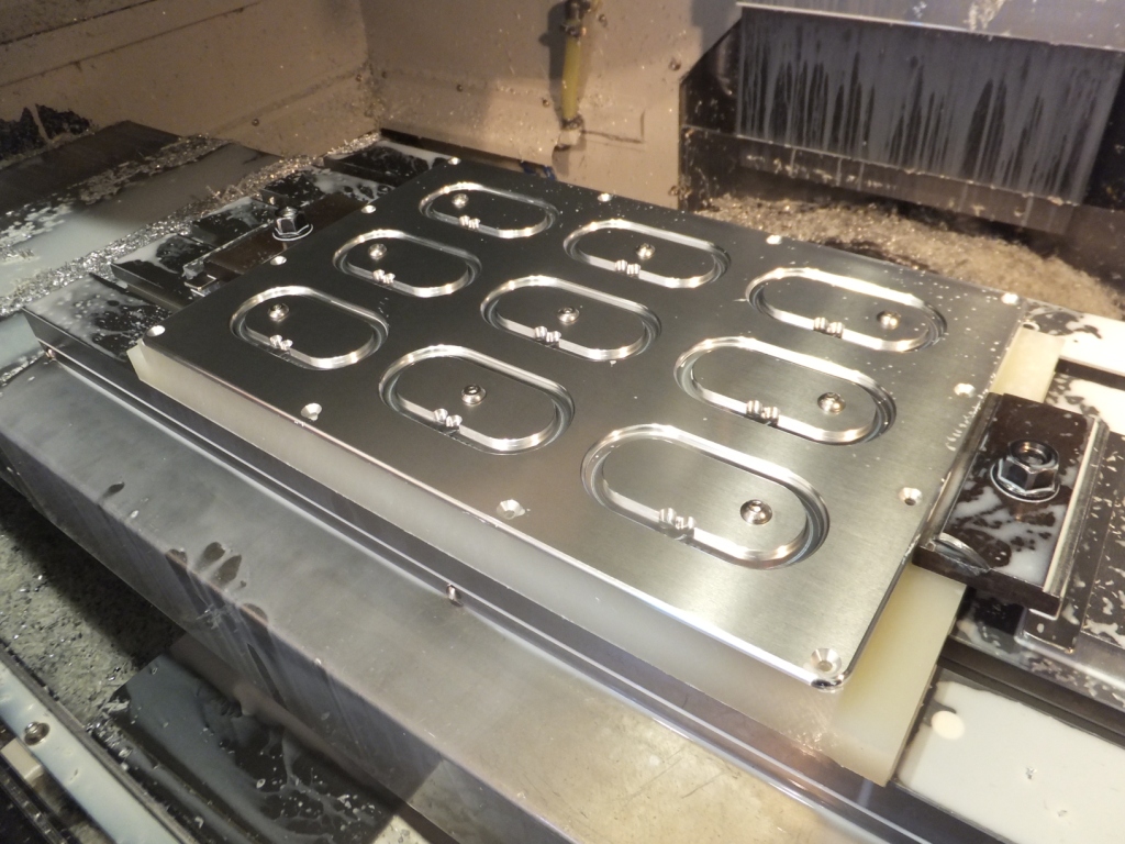

I thought i would add a couple of extra picture. The first is my machine and vices. The second is some flanges for intakes and the third and fourth is a custom-made badge for a friend with a 1964 ford galaxie.
Cheers Craig Young
