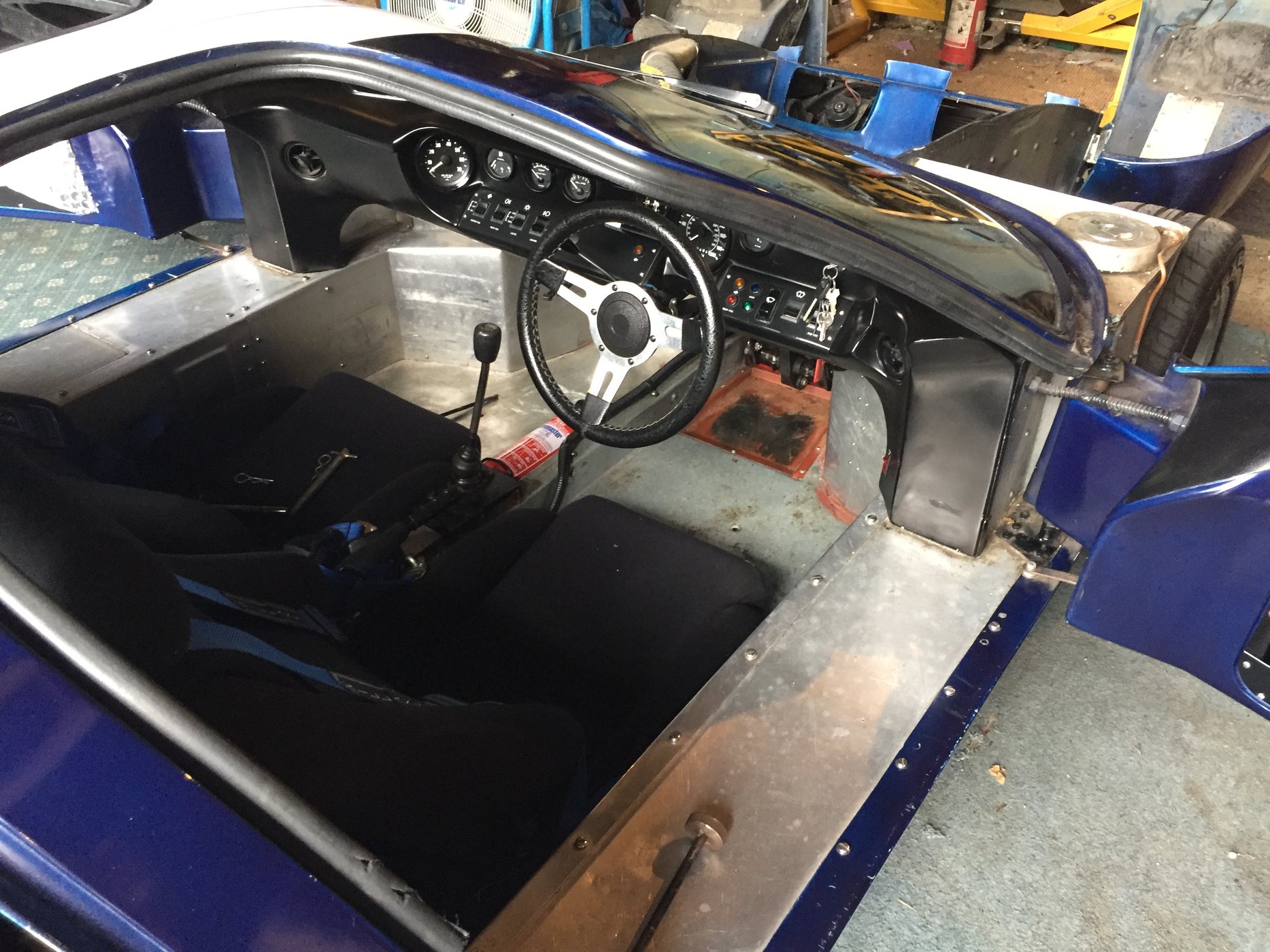

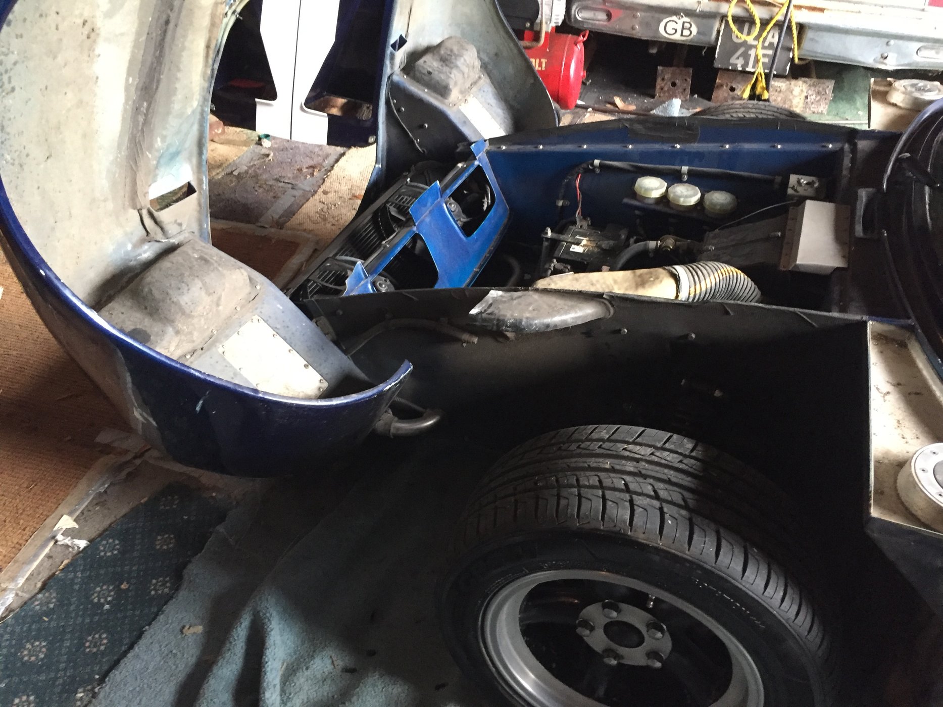

Hi All,

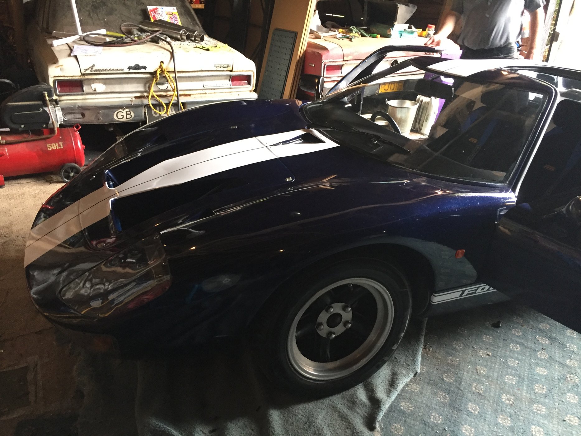

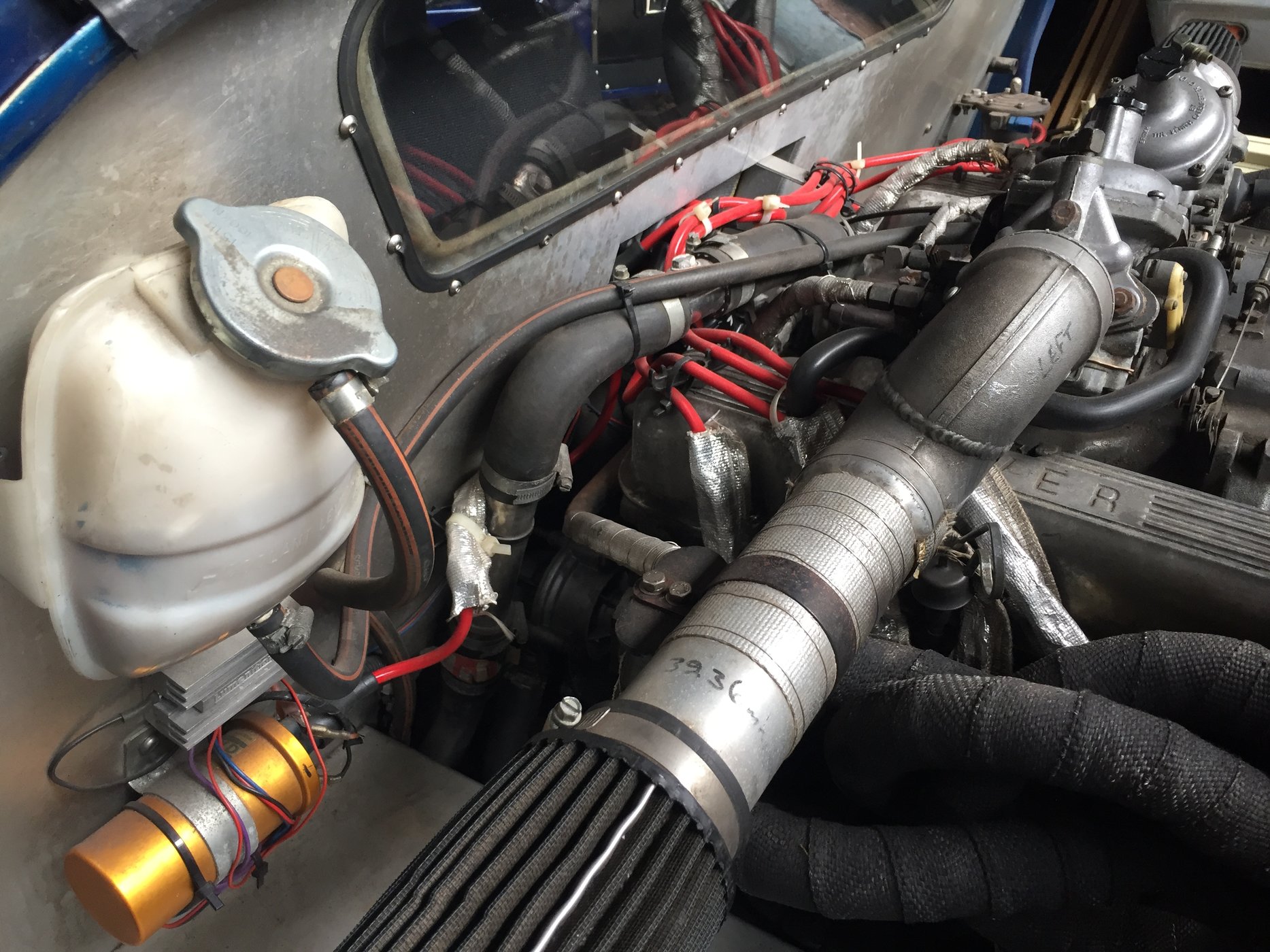

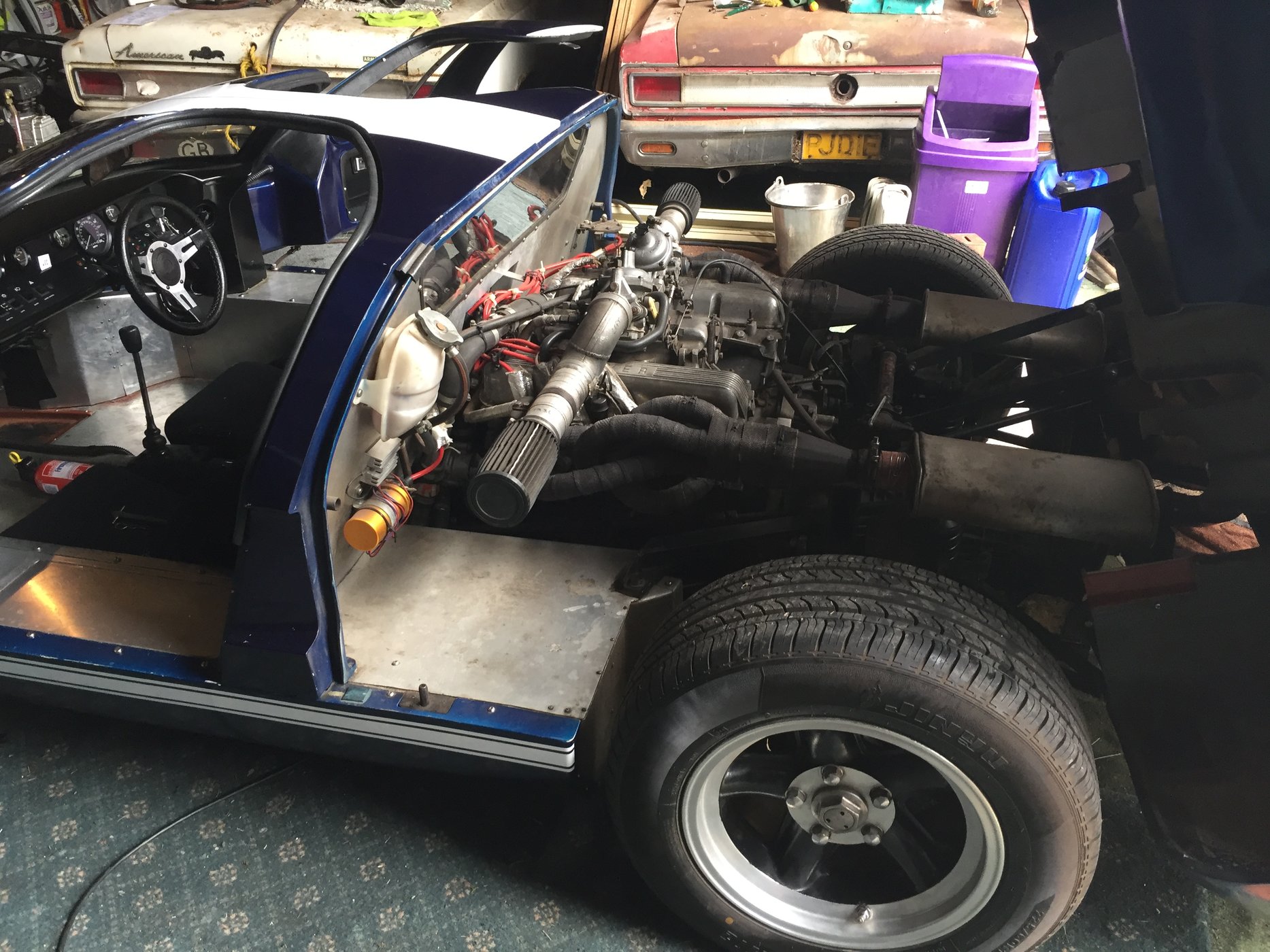

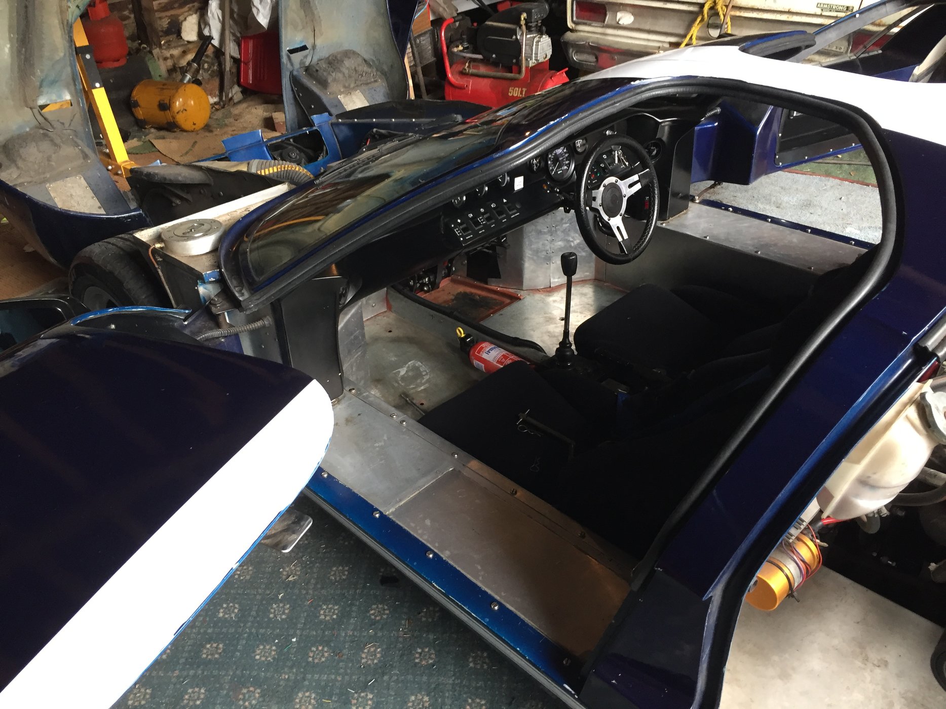

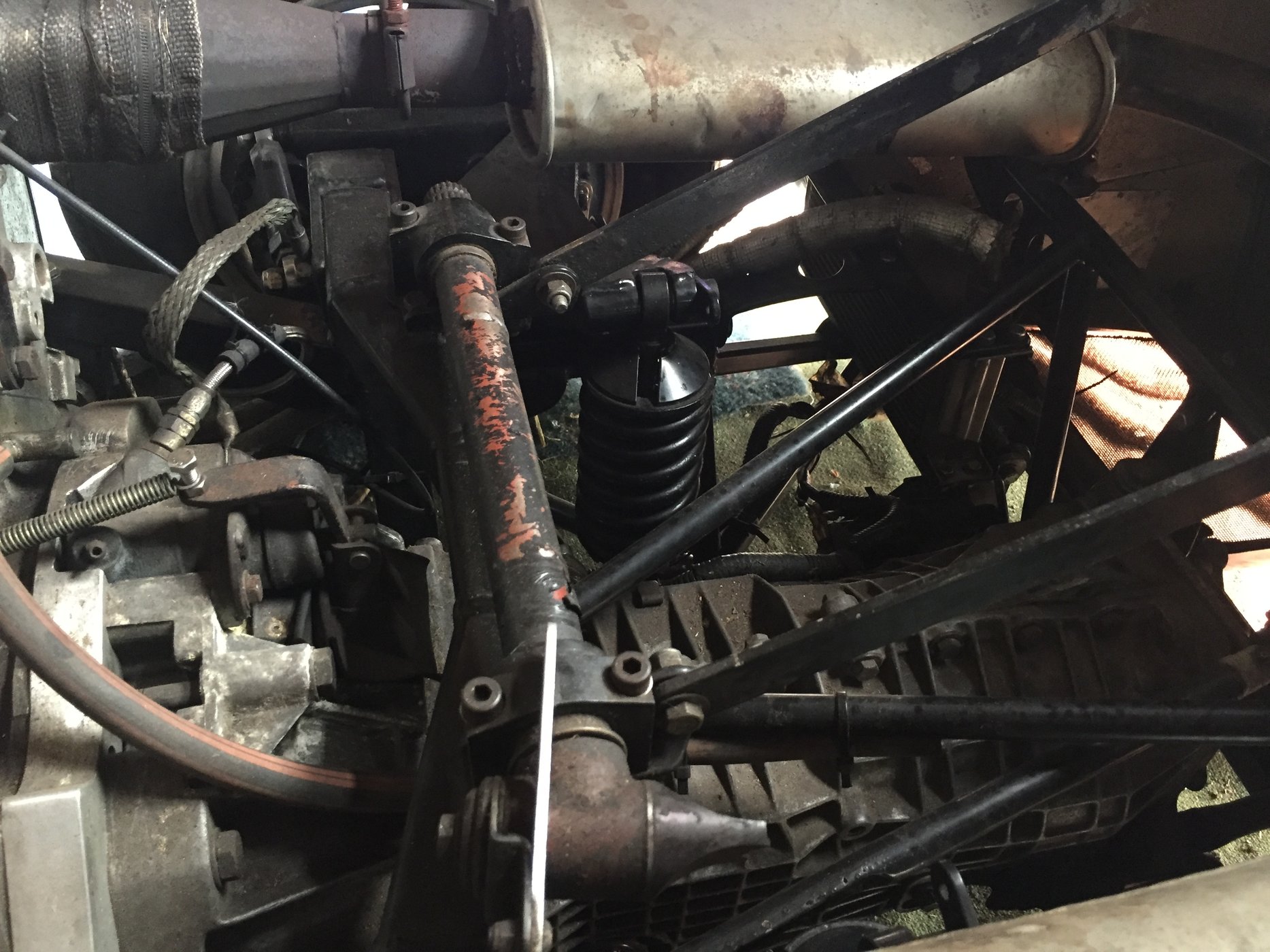

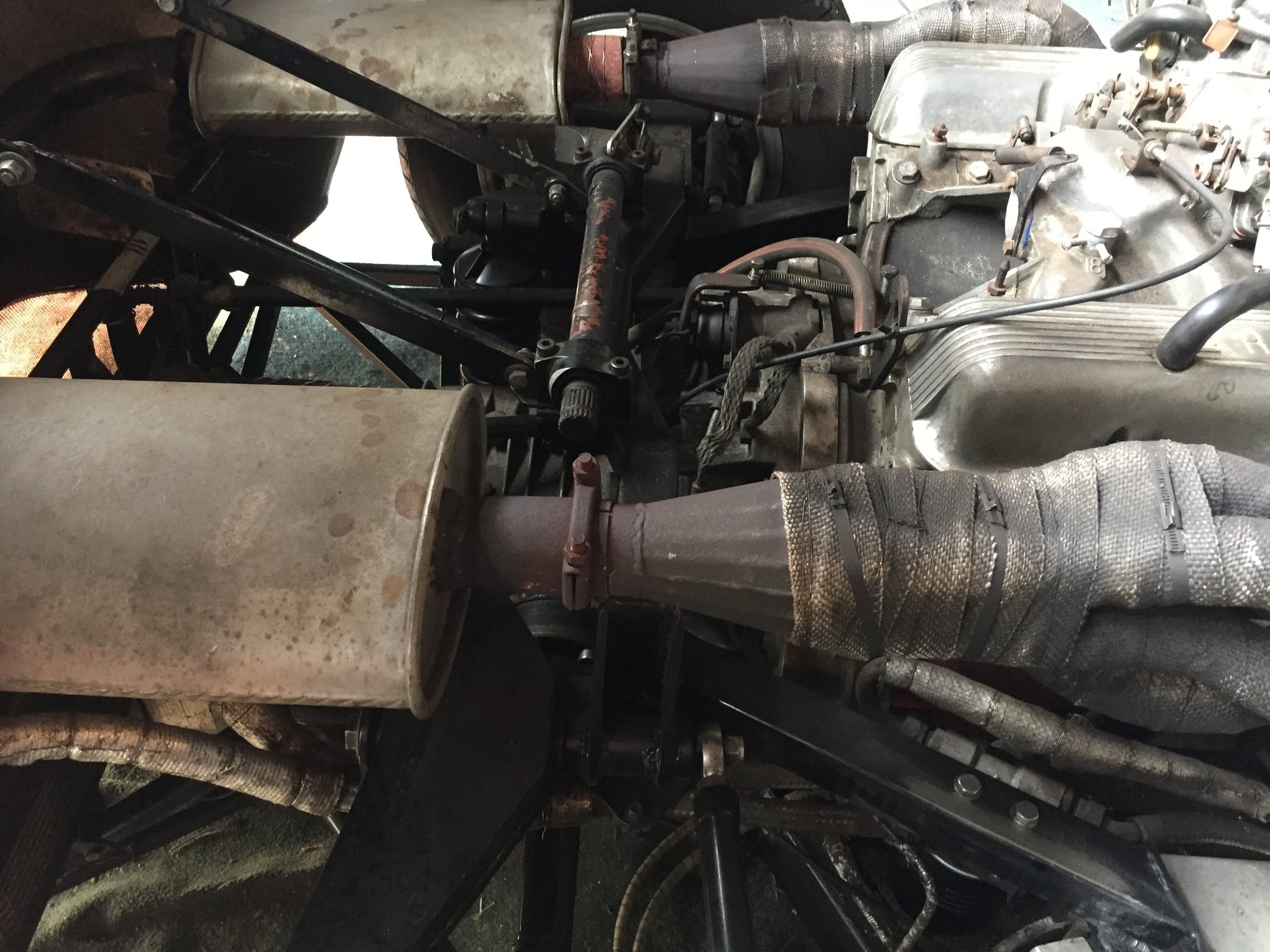

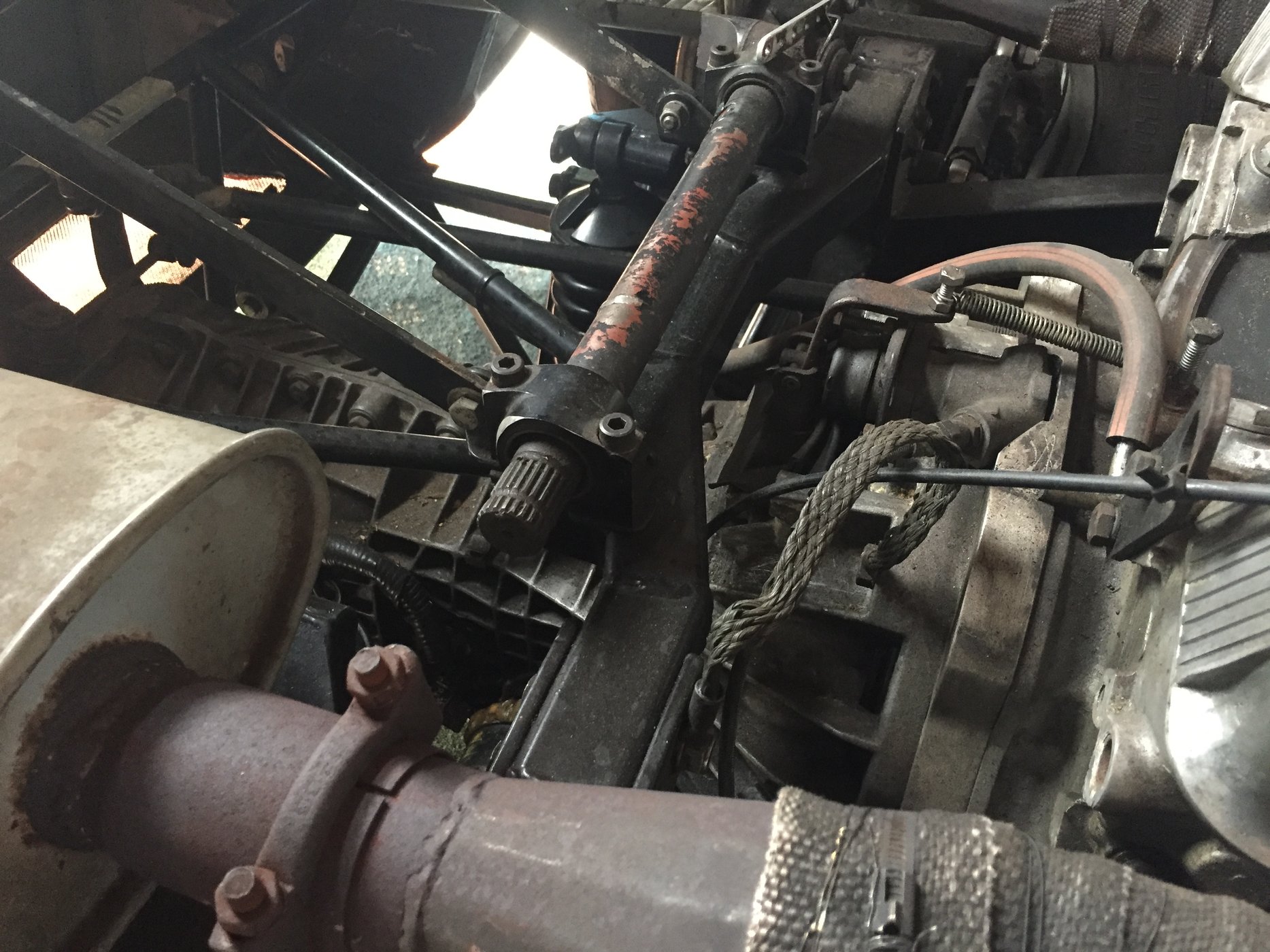

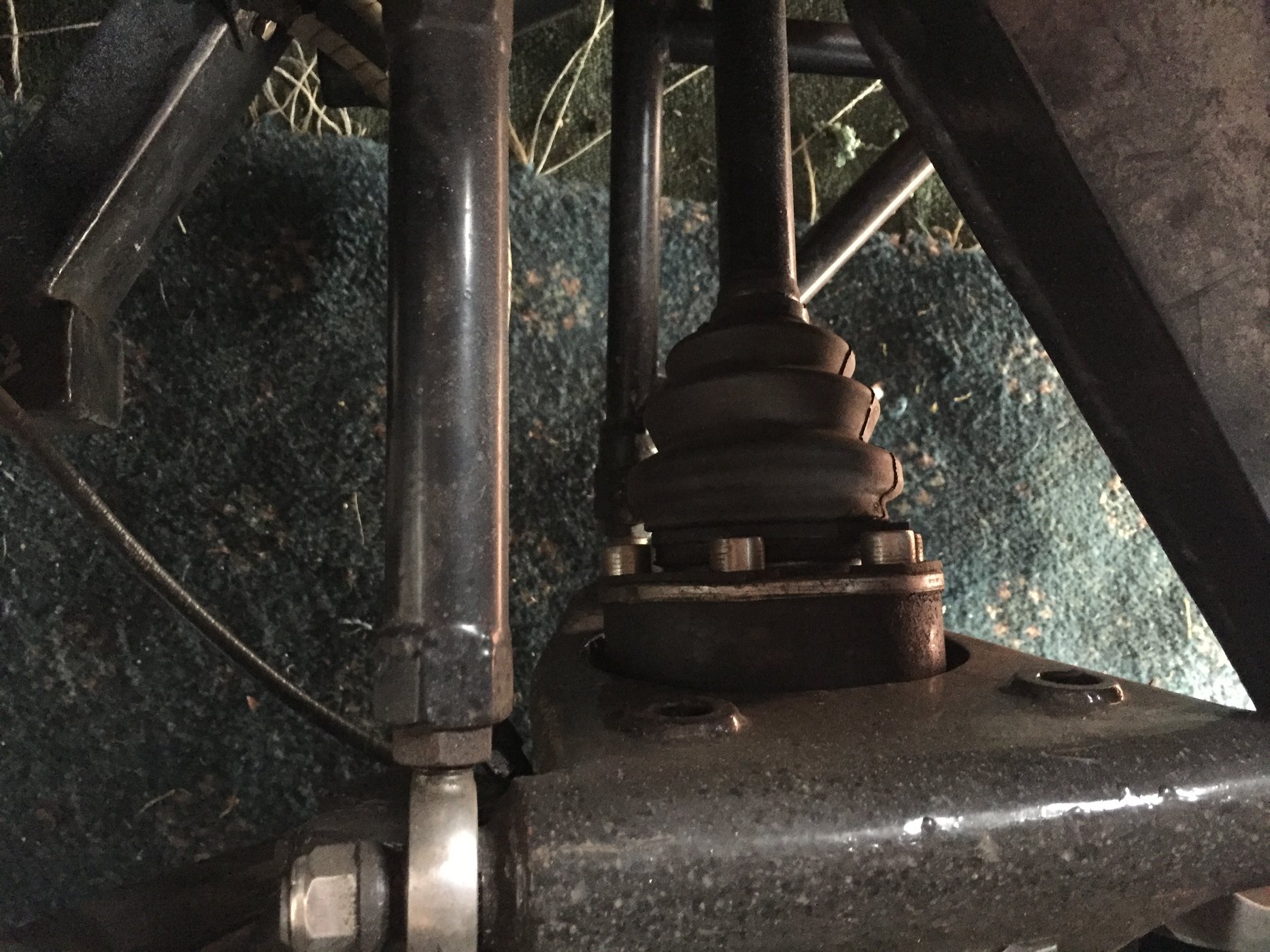

Instead of buying a Porsche 996 C4s I ended up buying a gt40 KVA MK1 with a Penske racing suspension. I want to upgrade some key mechanicals such as engine and gearbox and would like to share this journey as I am learning as I go along. I have attached some pictures of the car. It currently has a river v8 and a 4 speed Renault box ( I plan to replace these with a RICARDO and ford 302 ). Let me know your thoughts on the challenges ahead. Thank you

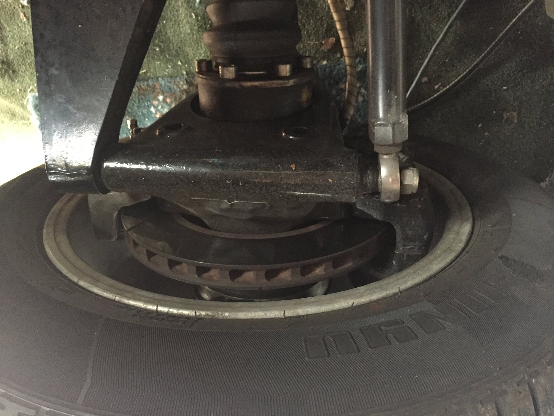

From looking at your pics it is difficult to see exactly what KVA elements you have. Some pics of the front and rear suspension and chassis would be very helpful. Is the car road registered and in possession of a V5? This will determine what you do in terms of upgrades.The Ricardo box is huge, heavy and will stick out of the back of the car. It is overkill and there are better options available and at less cost with readily available adaptors and gear linkages. Your car has a centre gear change so I am guessing it uses cables.
It will be easier to help with the most relevant info if you say what you intend to use the car for. I have sent you a message via this forum (see Inbox at the top of the page).
