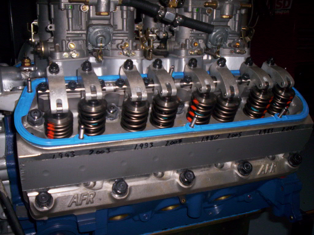

Well, as some of you folks know I re-thought my philosophy on a GT40 engine and of course some of that was influenced by my favorite topics, transaxles. Since I am committed to trying and Audi box and learning once and for all "does it work or does it not" I was stuck with the gear ratios and needed a motor that can turn RPM. Also, in the last couple of years I've become involved with wheel to wheel racing I have sort of changed my slant on the car from street to track, hence the sell of my build and purchase of a turnkey minus more suited to track work - brakes, cage, etc.
So, to that effect I decided to rebuild and be done with it all in one fell swoop. I speced out a high RPM motor that had all the goodies and bits to handle the 7500-7900 RPM range and not fly to bits. I picked up my motor from my builder this morning, paid a hefty bill, and took off! However, I think the motor is a good one and here are the basic specs:
342 inch SB Ford
AFR 185 heads, custom CNC porting job
Forged crank, now zero balanced
Forged Eagle H beam rods
DDS main support and windage tray with crank scraper
Comp Cam cam Specs:
0.676" lift IN, 0.673" lift EX, duration at 0.020 287IN 295EX
Timing @ 0.050" IN Open 18 BTDC Close BTDC 58
Timing @ 0.050" EX Open 61 BTDC Close BTDC 21
110 Lobe separation
Comp Cam Valve springs and titanium retainers, 600lb open, 260lb seat
Jesel Comp Series Shaft rockers
Jesel Pushrods
Jesel Keyway solid roller lifters
Ferrea Hollow Stem Intake and Exhaust Valves, 2.02/1.60
Total Seal rings
ARP 1/2" head studs, ARP hardware throughout motor
ACL 3/4 grove race main bearings

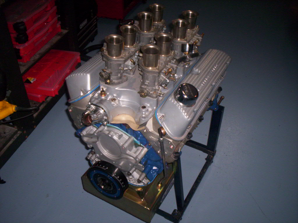

I am worried that the 48mm webers won't cut it for flow though. I think I'd asked that before and folks indicated that it'd be on the edge at round 7000RPM and choking beyond that.

I am basicly /ubbthreads/images/graemlins/ooo.gif running the same set up on my Shelby. You will need to change the chokes to 50 mm. you will definatly run lean with 48mm chokes.
They won't take 50mm chokes though, correct? I was thinking that was a fairly serious modification to webers, but can't remember, maybe that was 52mm.

A picture of motor number 2
This particular one has not been dynoed, but the one that Billy built that was just like it two months before (but with less nice valve train) made 538 fwhp at 7400RPM. However, that engine used a Demon carb and I am thinking the Webers will not perform as well as the Demon. Don't know why, I just have a feeling.
So, right now I'm sort of thinking of various options on how to fuel this thing. Getting webers large enough (seems everyone thinking the 48s won't be enough) would be expensive as the 52mm and larger bores are all custom jobs that cost a bunch of cash.
Injection is looking like a reasonable option since it'd be no problem to get large chokes like what Paul and Roy have on their monster. But, as I've said before, I just don't want all the wiring and mess cluttering up the engine bay as well as the associated pumps, returns, selector valve, etc. I'd love the tunability because I really like messing around with injection systems, but not sure if I want one. Seems I like working on other people's injection systems better!
And lastly, a 4bbl would probably work well and offer great drivability and hp. But, they just don't look the part. Hate to say that, it is a silly reason and I know it, but looks are a large part of this car and the 4bbl doesn't complete the package.
So, now what? Someone convince me of what to do!

Ron sounds like you already answered your question. Gotta have the stacks, dont want wires , but dont want to machine them up. Looks like your done with the top of the motor. LOL

It looks delicious!! I am happy to hear that you succumbed to Bling and kept the pierce’s 8 Stacks. I have the same exact set up, also 600+ lift and short duration. Wait till you jump on it, it will be awesome.

I am with you on the issue of Webbers Vs demon/holley . But trust me, you open that engine bay and they are gone go wild over those Webbers. /ubbthreads/images/graemlins/cool.gif

They might have to be machined, I just haven't looked at the cost. Then, there is the IDA vs. IDF thing, might be best to get the IDAs, although the same size oriffice would flow the same through either I think.

Great looking motor! - treat it right - go injection.
Yep I'm biased, but you really don't have to have a messy engine bay just cos you go injected. If you batch fire the injectors, the loom comprises just 5 wires for injectors, plus another 5-7 to cover sensors. The loom I made for Daves R42 terminates in circular Multipin plug so an engine removal requires a twist of the wrist to disconnect all injection electrics.
As for plumbing - if done at start, its easier. Fit a balance pipe between the tanks, draw from one, return excess to the other, if tanks have not been made you can even incorporate a swirl pot area at the rear of the tank you draw from, so no pot needed between tank and engine.
Ignition can be as simple (but still mapped) with dizzy, or as complex (8-coils) as you like. We used to fire an MSD 6AL using the ECU output. Worked well right up to 8000rpm limit we used - no worries...
Look upon the injection as a long term investment, you may rebuild the motor a few times, but you can always tweek the ECU to suit changes to spec, or even characteristics depending on what type of event you enter. If you don't want to go down the Kinsler indvidual throttle body route, then look at a billet 4 barrel body. Daves Edelbrock item fitted to his R42 will flow up to 1000cfm, is low profile and is so simple in design is very unlikely to fail.

I'll also forward this thread to Rodger as his stroked 351 (408)/AFR185 motor runs 48IDAs with I think 42mm or 44mm chokes at present which must surely not flow enough at higher rpm??
Sweet setup, Ron. Are you using a stock block? If so, how comfortable are you that it'll hold together at 7500 rpm? The main support, zero balance and light valvetrain will ease the strain on the block, but still...
