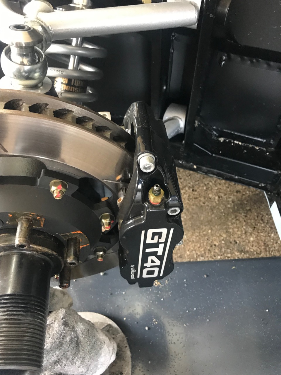

I have a newer car, #2388, sequence 339. I have the GT40 branded calipers. I'm assuming they are the same as the old Wilwoods and use the same brake pads. But you know what they say about assuming.
Does anyone happen to know if they are the same as the old setup and only new graphics?
Thanks in advance
DaveM
I think the new ones are Wilwood FNSL4R Forged calipers versus the previous billet ones. Otherwise same dimensions and pads.

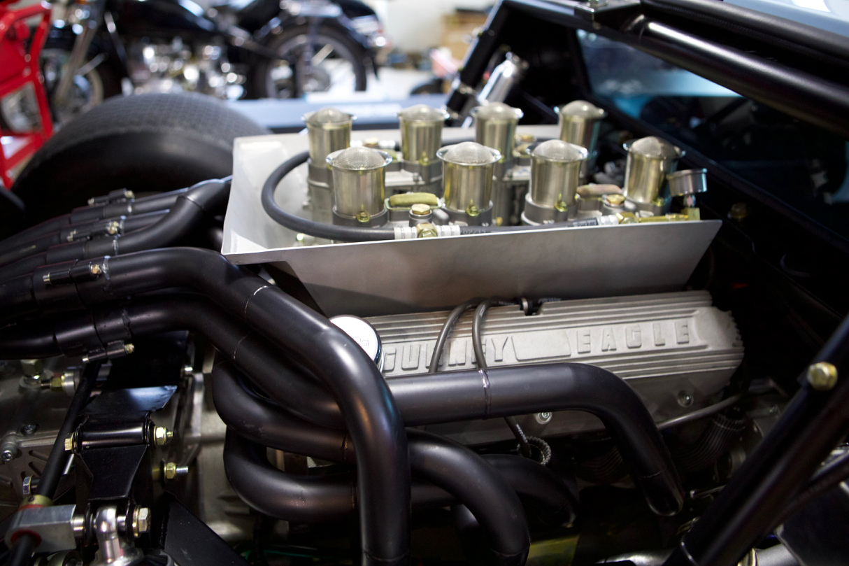

Richard, I took a look at the posts from your acquisition of the car. Great choice BTW ;) Thinking about your use, I thought you might like to consider a turkey pan set up to to minimize the fuel boiling potential in those webers and to shield that crossover fuel line. Here's what I did. I don't have before and after reference for performance or heat mitigation, but it sit flush with the clam shell and also prevents road debris from landing up on top and making it's way to the top of the engine. These cars are never done, so add this one to the 'maybe' list.
Richard
Beautiful! That is definitely on my list. Luckily, I have not had that issue, so the turkey pan is a project for another day.
