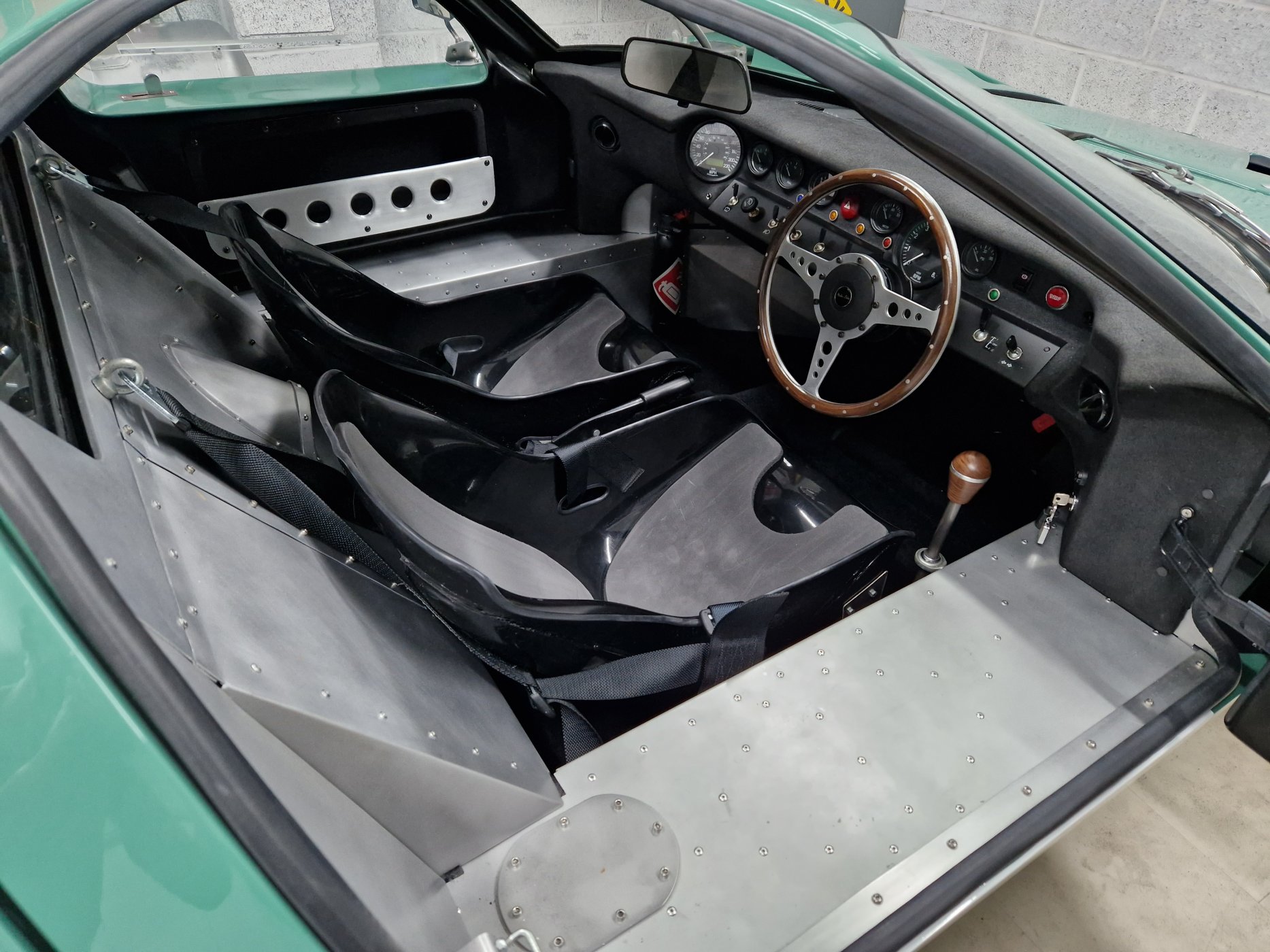

G Justin Jan 14, 2023 #1 I see a lot of pretty much the same seats in GT40s. Is there anyone on here using non traditional seating? I’m looking at some Tillett B8 seats for my current project along with a host of other small updates.

Ian Anderson Lifetime Supporter Jan 15, 2023 #2 Check your dimensions of the space in your car between side pod and tunnel. The front of the seat is the critical dimension I seem to remember on my DAX the only ones I could have got in were the B2, but ended up purchasing some RCR seats that someone was selling Ian

Udo Supporter Jan 15, 2023 #4 I am using the W1i for 10.000 km now. Works nicely, ventilation is the issue in summer (when it‘s too hot in the car anyway)
