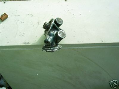

I have just what you are looking for. It is off a 97 Explorer 5.0 hiperformance 302. I have it listed on ebay, and it might have a pic on the for sale section here. If not here are the pics and ebay location.

The remote adapter is plan B at this stage. I have it in mind but I think an adapter like the one Mistral gave us a picture of is the sort of thing I was talking about. If anyone knows of any more of this type, I would be pleased to hear from you. As most of you are aware, space is of a premium in these engine bays so the smaller the better.
The oil cooler Bill has is meant to go forward so the angle on the adapter is about 90 degrees. Unfortunately my alternator is in the way. If it is oriented down the oil cooler and filter hits the sump. I know this because I have already got one, so sorry Bill but no sale this time.

The large pipes are water pipes. The cooler attaches to your oil filter mount facing toward the front of the engine. Your oil filter goes back onto the threaded end of the cooler. You then plumb the cooler into your radiator hoses so it is in between your radiator and engine.
John
That looks promising Bill. I will investigate it further.
