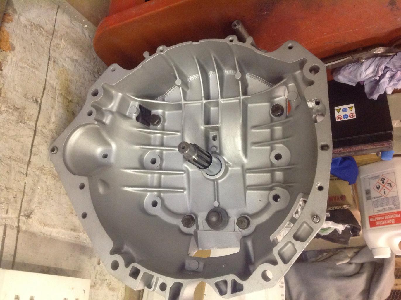

I'm using a Renault UN1 transaxle. Does any one have an UN1 transaxle out on a bench and tell me if there is a bung or something in the cover plate that seals the transaxle. If there is, I have a suspicion I may have forgot to install. A pic would be great of the input side of the transaxle.

I know there are 2 speedo take off points for the UN1 - one counts the teeth on the crownwheel and the unit thet fits to count the teath and seal can fail and oil comes out (Ask me how I know)
This is a hole on the case looking from rear right hand side above and slightly ahead of the right output flange
And when the gearbox is used a lot of oil can escape in a very short time (about a half litre in 10 miles!)
Of course if yours is the other variety and more common UN1 this will not apply
Picture as requested

Thank you for your responses. I removed the transaxle today and it look like Mike is correct, the tube that the input shaft sits in, appears to be about 2-3mm to short and when the bellhousing is in place there appears to be a small gap and not sealing properly.
Is the tube supposed be pressed into the bellhousing?
