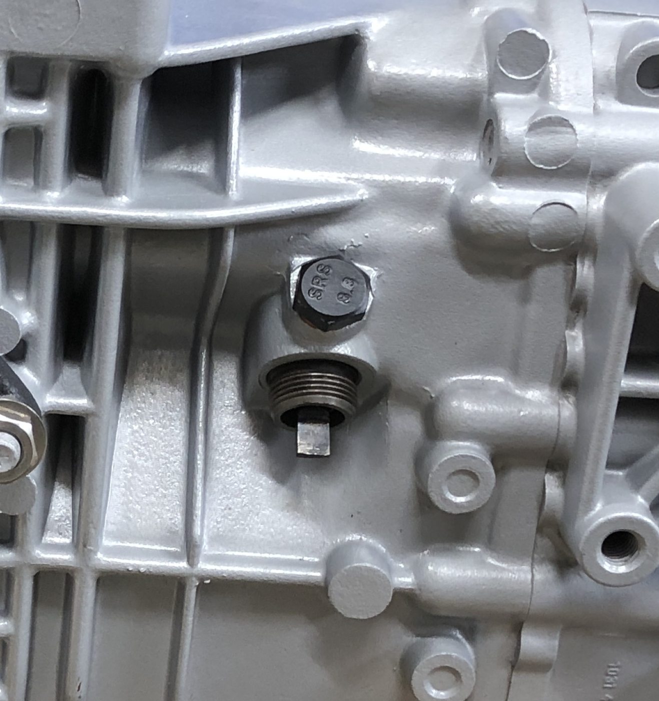

So your RBT 5 does not have a speedo output fitting and shaft? Like this:

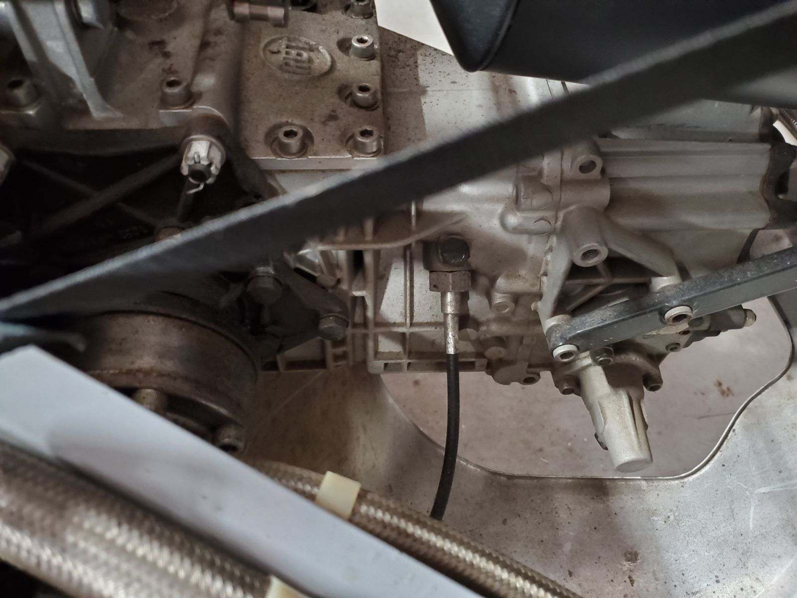

You should be able to install a hall effect unit like this or something sim !!
It is a long way to run a drive cable.

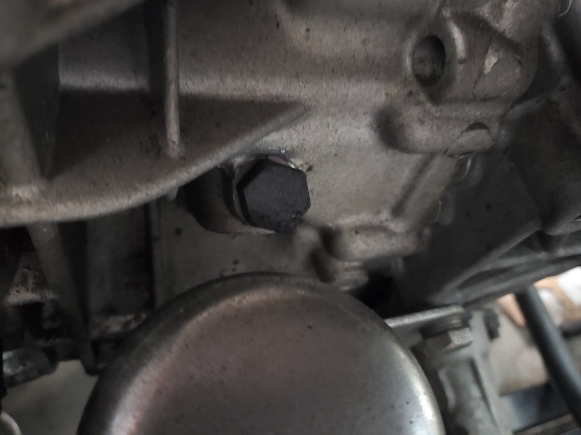

Are you certain the drive is not installed? The ZF casting has an opening there and the bolt holds the drive assembly in place. If it's not there and there and the builder did not install it, I am not sure you can install one without disassembly of the ZF. You need to ask one of the experts like Ron McCall
