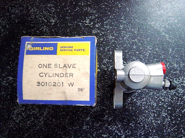

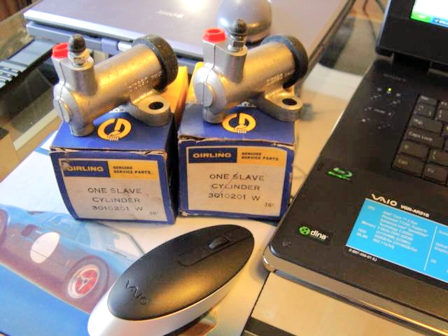

I worked for GIrling in the 60's and 70's and have the original installation info.
The correct slave cylinder is 3010201.
The system used forged banjo 352241 and banjo bolt 376102 on both master cylinder and slave cylinder, to bring female threads up to 7/16 UNF for the use of 1/4" bundy tubing.

We have stock of the 3010201 slave. Can also supply the correct size master cylinders, the clutch line banjos, bolts and other bits. We also have a few pairs of original Girling BR calipers, as used on the rear of the cars.

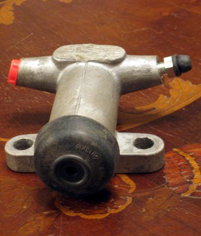

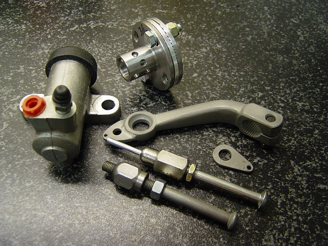

The original clutch slave cylinder is shown in the attached photos and it's quite different from the catalogue drawing which Mike posted.
I am fairly sure that I purchased the slave in question, to the Girling number and it came in the correctly numbered box so something is amiss here.
To help there is a pattern? number on the casting - 313290 which could be a Lucas number.
You will see from the photo of the original set-up that the inlet and outlet nozzle orientation is at 90* to the boss face on the bell-housing. There are a lot of similar slave cylinders out there with the pairs of nozzles at 45* and 135* and I have loads of them but the correct one is the one shown and thanks to a German friend of mine for putting me straight years back.

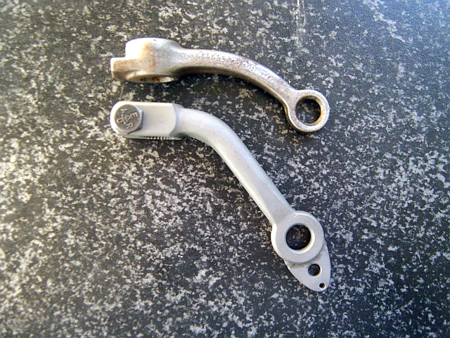

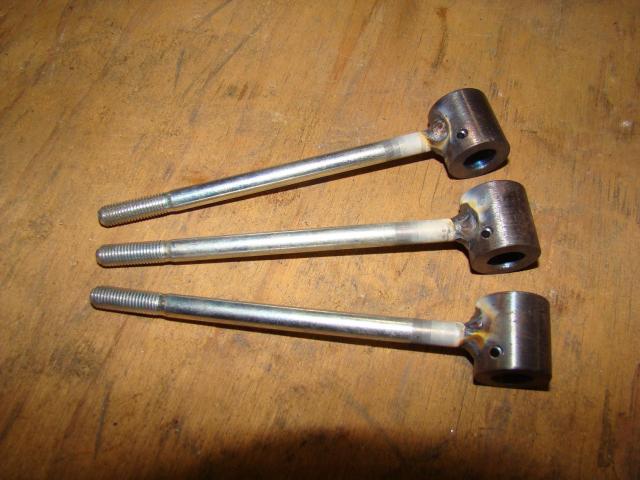

The adjustable push rod and return rod are also quite different from the standard Girling parts and need to be machined (see the middle shot) These are clearly shown in the JW Automotive catalogue.
The best way to get the length of the rods is to fit the slave and the clutch lever and measure the stroke and return from the slave to the lever tang as it will depend on your bell-housing casting geometry.

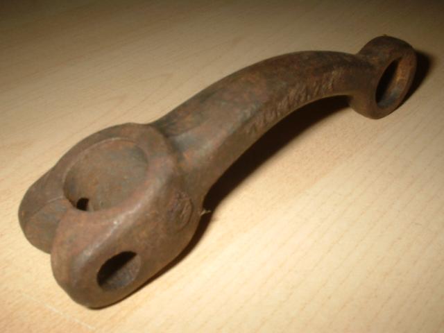

Obtaining the splined lever will be another problem as these are pretty rare these days.

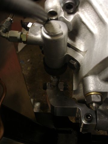

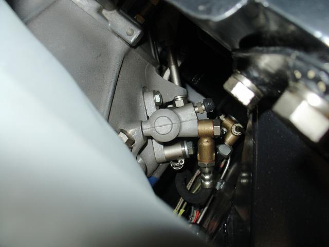

A note on the slave cylinder installation pic in yours of January this year.
It has a 3/8" banjo and small-bore hose, leading to 3/16" bundy tubing to the front.
We originally installed a 7/16" banjo (352241) and large-bore hose on both master and slave cylinders, with 1/4" bundy in between.
The reason for this was that the diaphragm spring has to pump the fluid back to the reservoir so it can clamp the driven plates. The small-bore hoses and tubing cause too much restriction to flow. On a hard change this restriction can cause a bit of clutch slip, because the d/spring can't get the juice back quickly enough.
The hose was 12 1/2" flat-to-flat - 3703925. A really useful bit of trivia is that the early Girling convention with hose part numbers was to use the last two digits as the number of half inches in the flat-to-flat length! Other digits referred to end series and bore. We could see a part number and know all about the hose!
Cars No 6 and No 7 went to America, I think. They used the same hose in the feed line to the master cylinder, because the pedal box was adjustable fore and aft. I don't know whether current cars being restored or built are using the adjustable pedal-boxes, so this para may not be relevant.
For crisp clutch operation, you really need large-bore plumbing.
As a point of interest, it's not needed on brake systems, because brake systems are hydrastatic. Once clearance is taken up, there is not much fluid travel. In fact, large-bore tubing is undesirable in brake systems. With the very high line pressures, small-bore tubing gives much less expansion loss and therefore a better pedal.
I hope you don't mind the comments on your picture!
