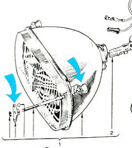

Hi, Can anyone point me to where I can get the headlight adjusters indicated in the photo ? I guess they were standard fitment on a vehicle of the period.

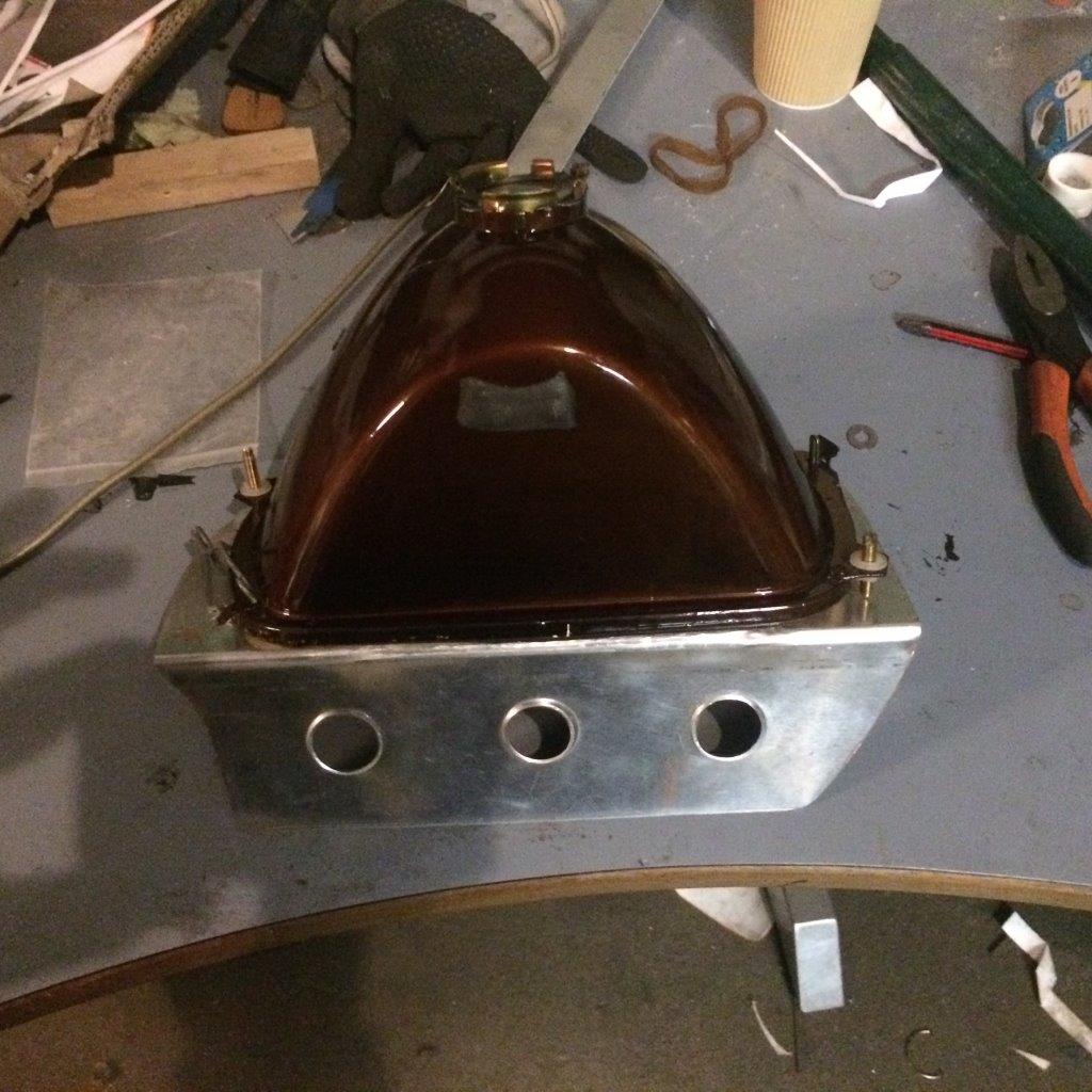

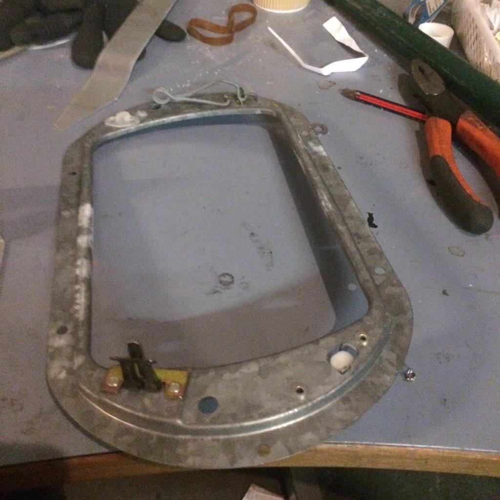

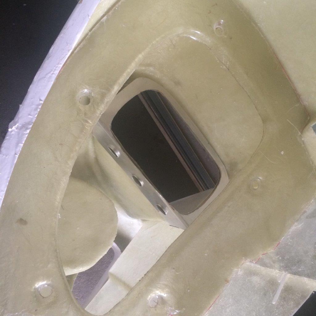

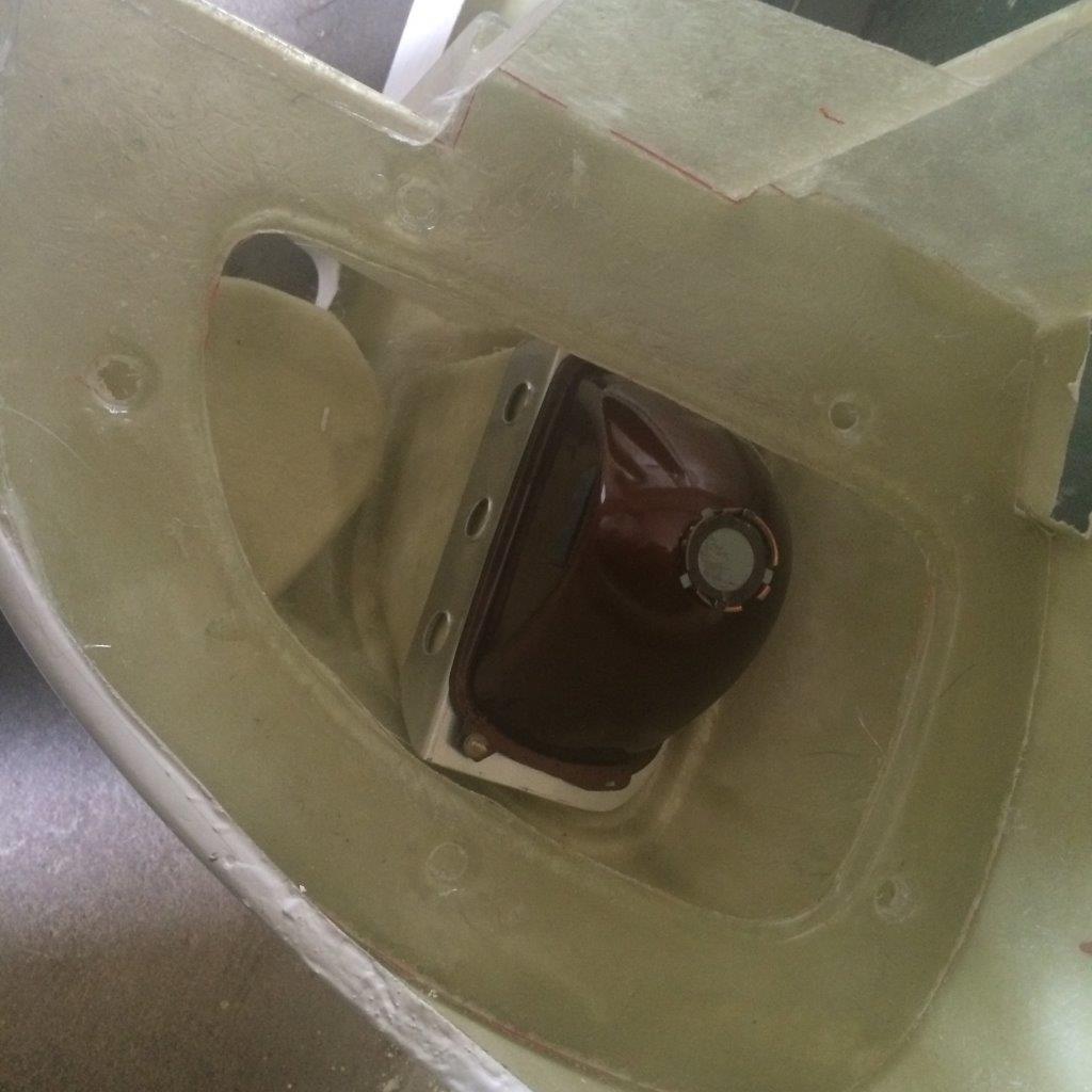

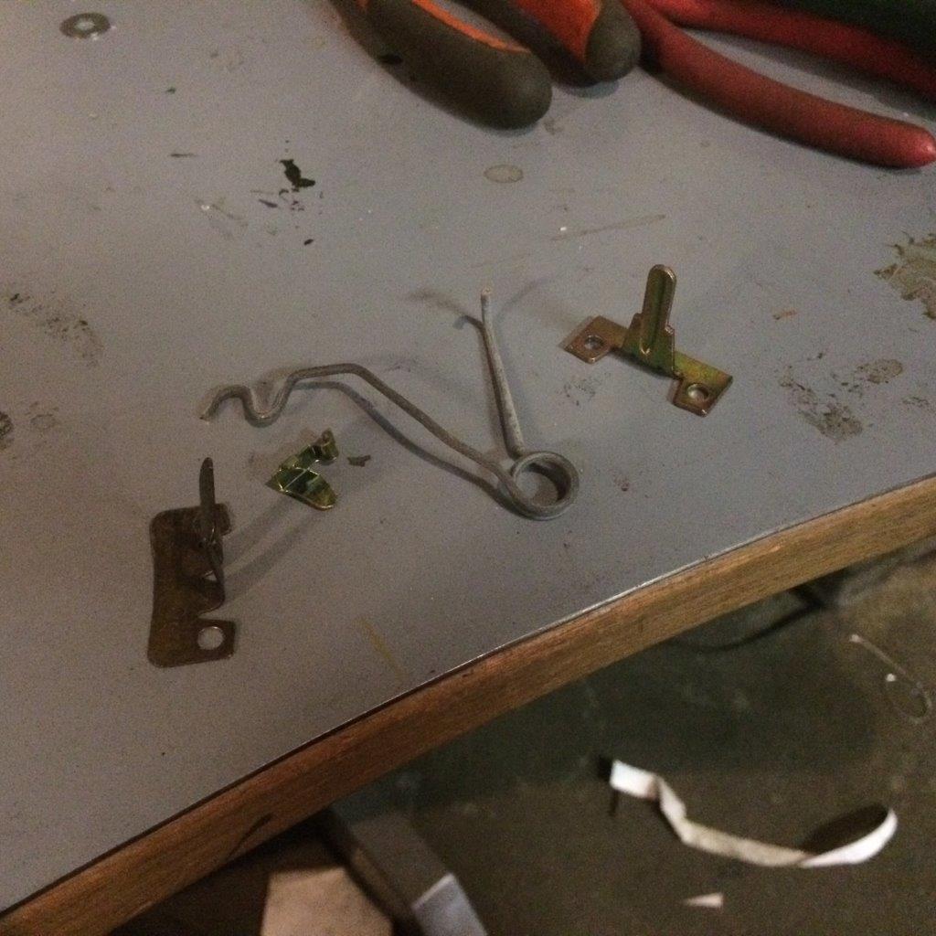

Hi Peter . I took a slight different approach when installing my headlights. MySquare headlight came from Renault R12 headlights with the originals Marchals holding plates. Then I transferred all the bits holding the lamp to at homemade alu holder plate,which was the fibered into the front clip. The lamp can be adjusted, as originally intentet. Se pictures. Not absolutely original,but it works very well.
