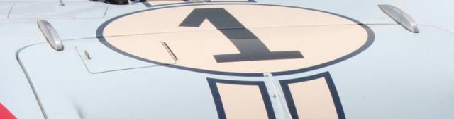

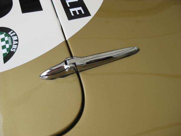

Hi Dave
Thanks for the quick reply
Here are some better pics ( does it look familiar ?)
the triumph hinges have a more triangular section shape. The MK II are more rectangular and sqare in shape. Don´t you think ?

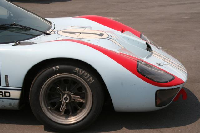

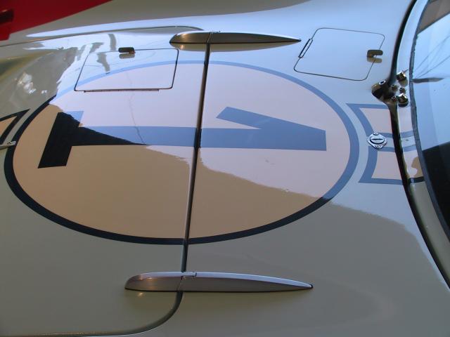

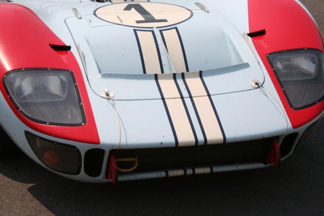

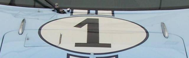

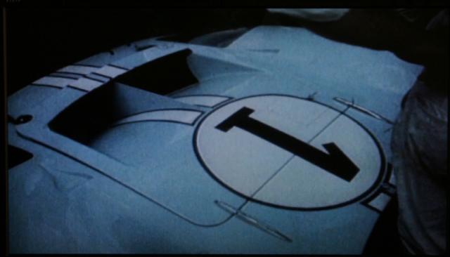

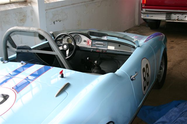

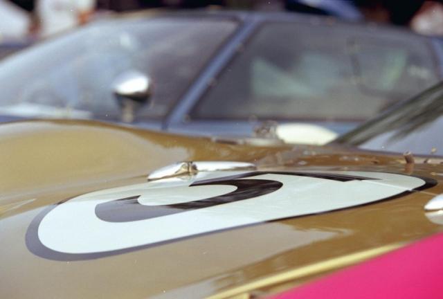

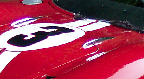

I searched through my various pictures and came up with the following selection. Only period shot that I have that shows the hinges in any detail is a poor one of 1015.
Rest of the shots are from 1012,1015,1016,1046,XGT-3
Based on the selection out there on original cars my view is use whatever you feel gives you the closest look.
Dave

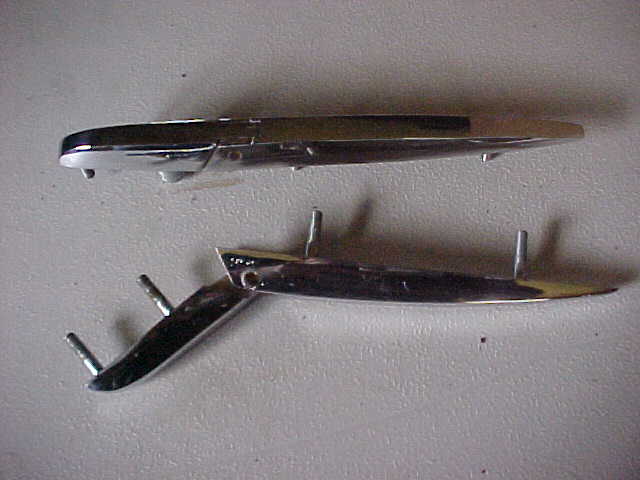

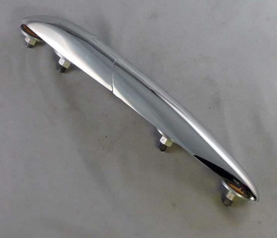

JimmyMac
Tom,
Here is a close-up of a NOS one
I think the streamline taper is the wrong way round to work on the MKII
