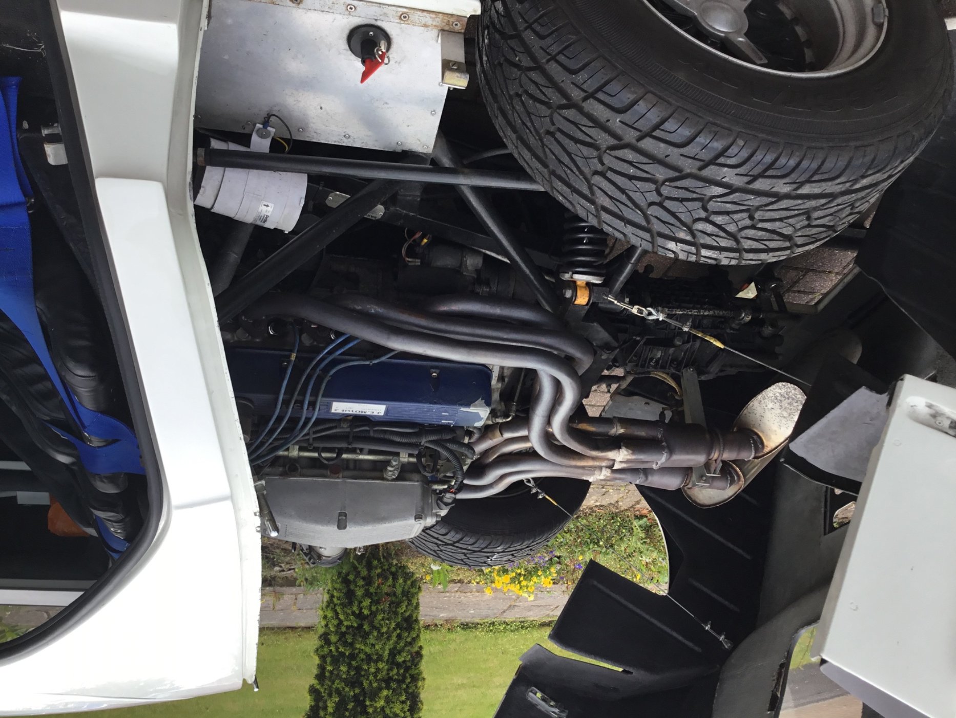

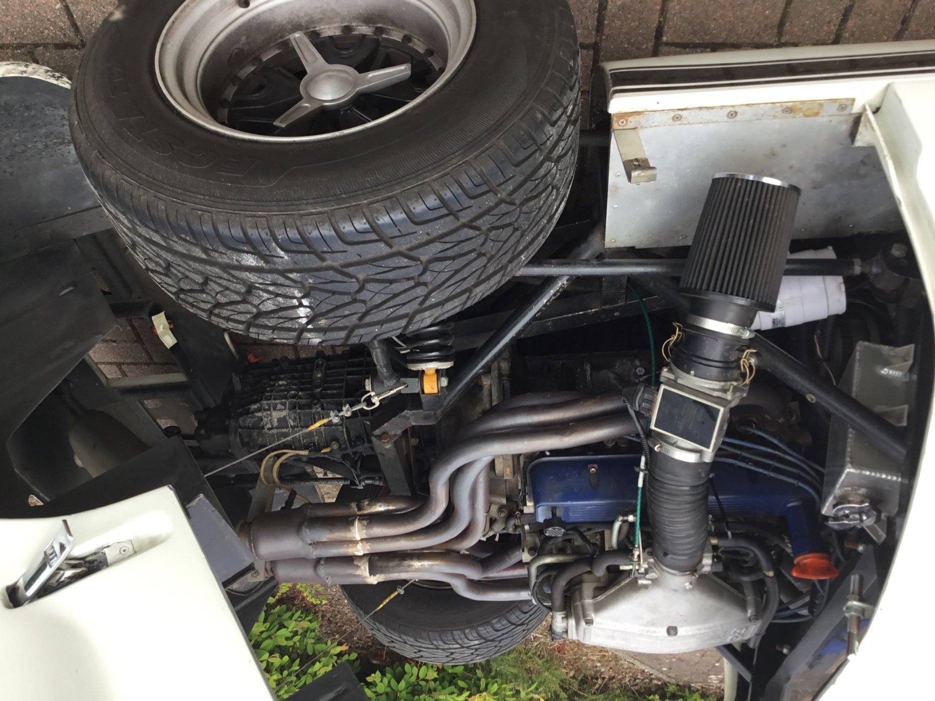

On my DAX (now sold) I used dogleads made of stainless cable
Only photos I can locate are attached and as the rear clip was closed they just looped behind the suspension…….never touched anything spinning!
