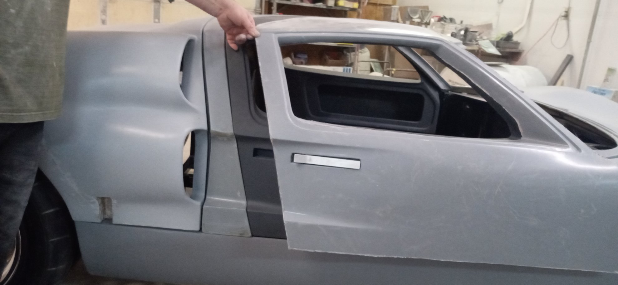

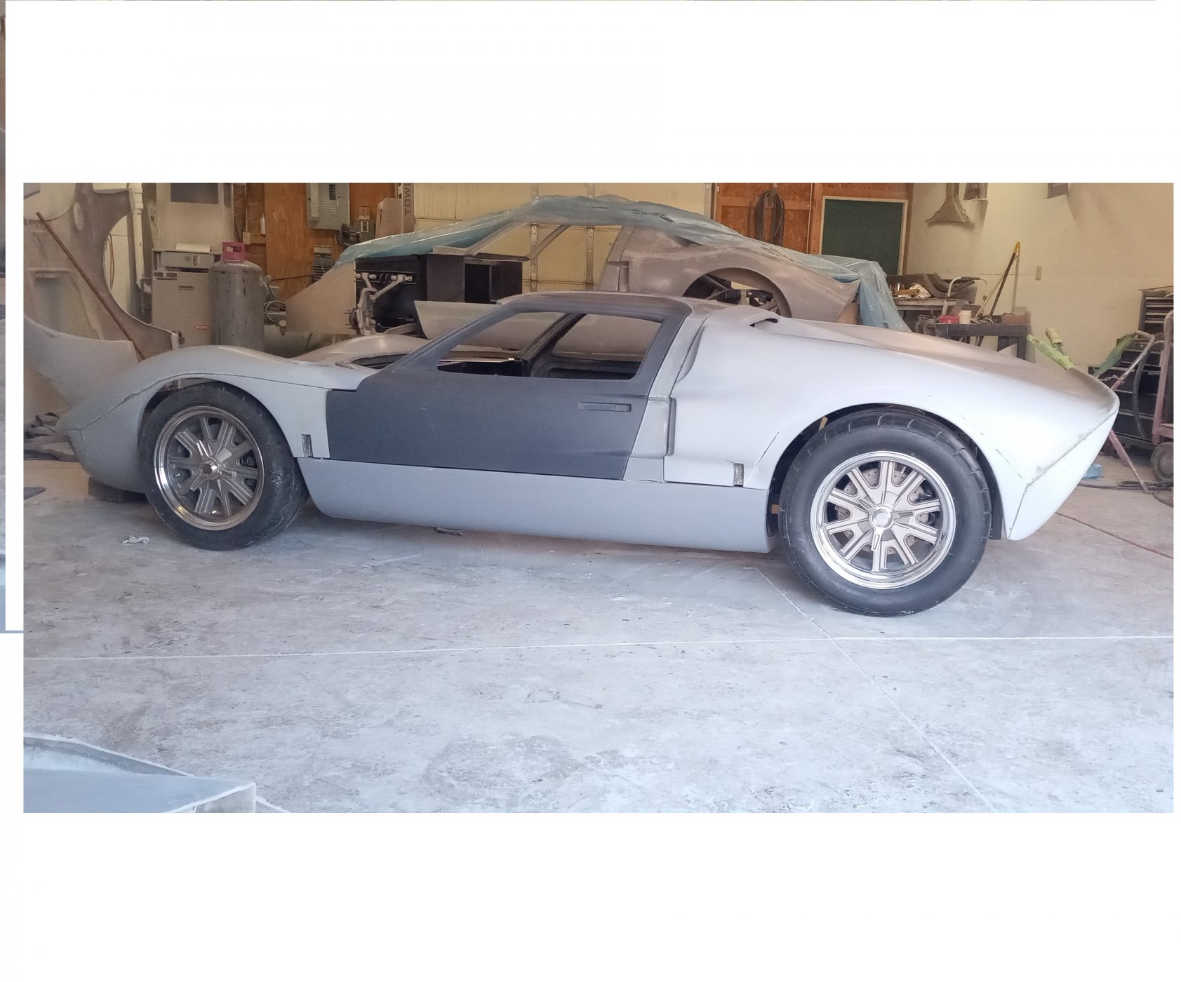

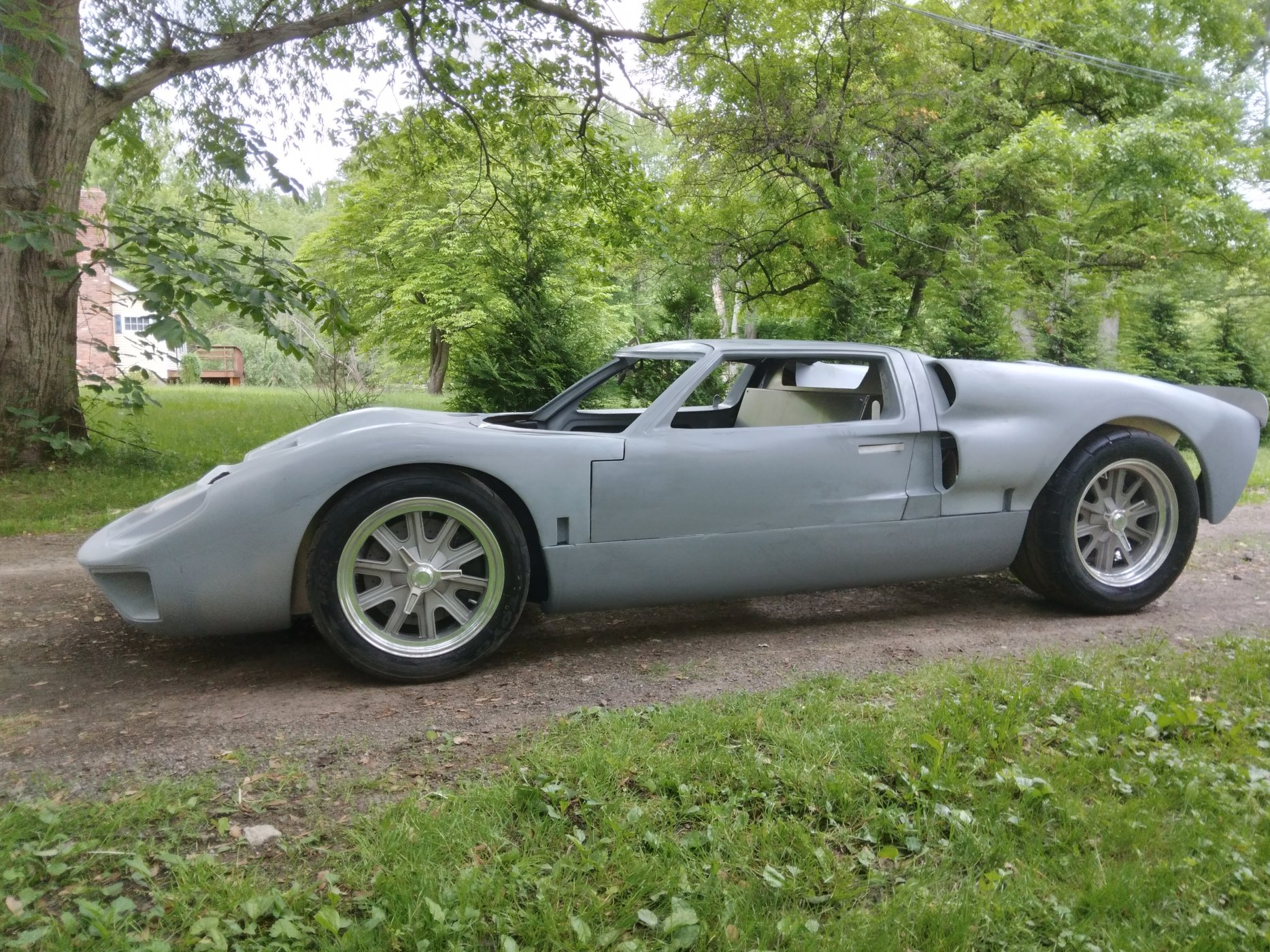

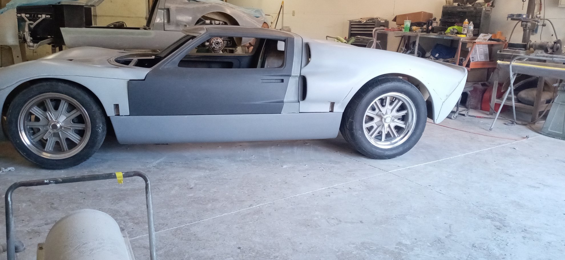

Our plus 4 Stretch model is ready
We added 4" to the passenger compartment to accommodate the tall guy. Taking orders.

What a brilliant idea! Obviously looks slightly different, but only to those “in the know” and not in a bad way anyway. This will open the market up I’m sure. Very nicely done.
Ian Anderson
I had DAX and they also made changes to fit in the larger driver.
the foot part of the front and rear clips were lengthened by an inch and a half ish and the doors, likewise had this amount added. That way the front and rear clips were at slightly more angle than a genuine 40 and the total height about 41.5 inches
At 6 foot 3 I fitted in easily and even had it on track with a helmet on… no Gurney bubble!
I actually like the look of yours and as Simon says only those in the know would spot the difference.
Andres

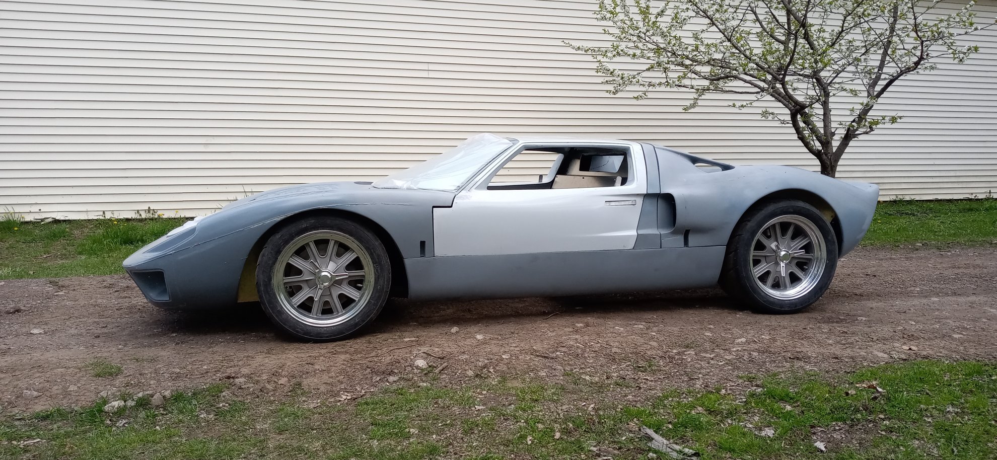

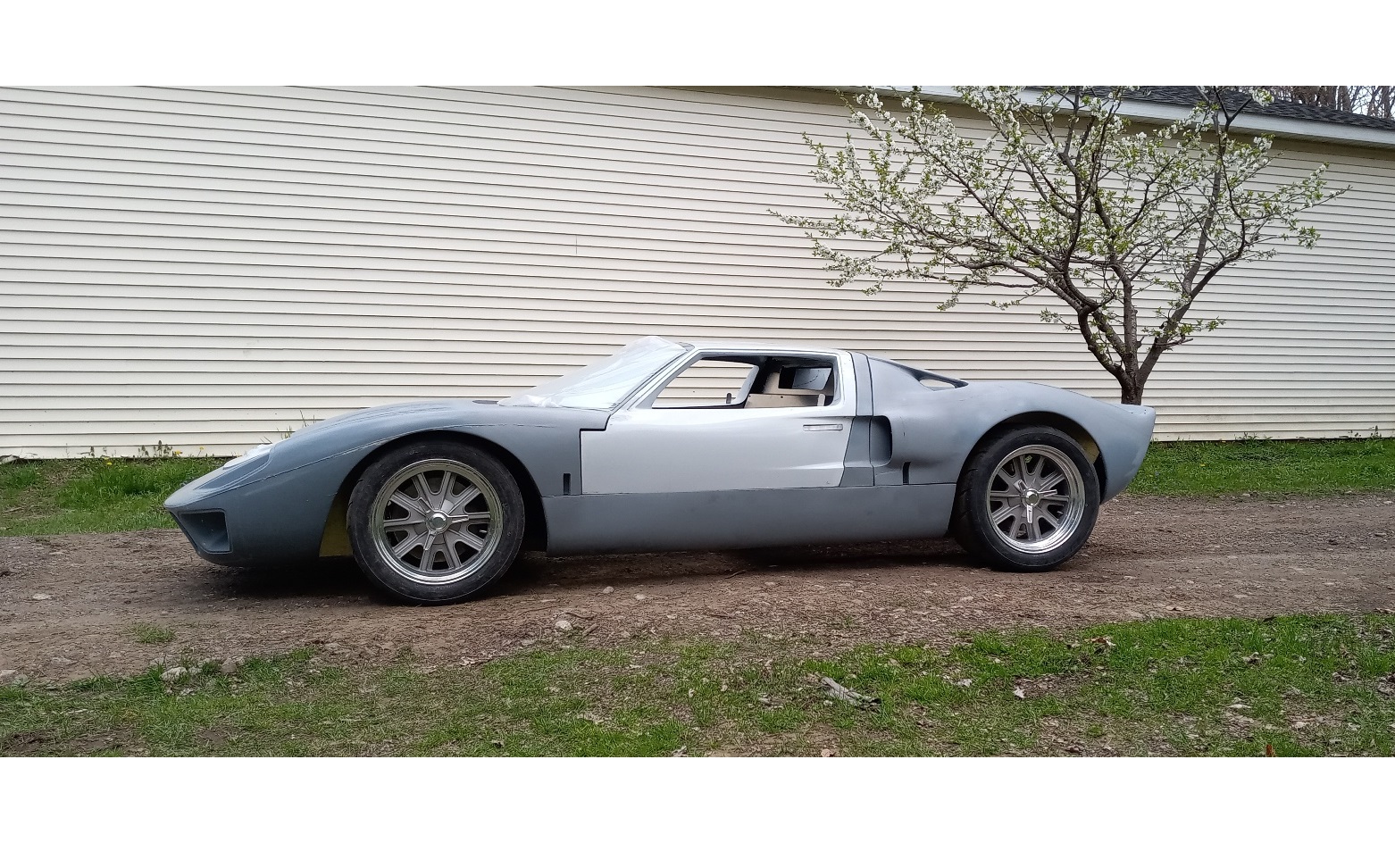

I'll sure keep updates going as I get them, these first rollers are getting built right now. As I get updates fromcustomers I'll sure post them here.

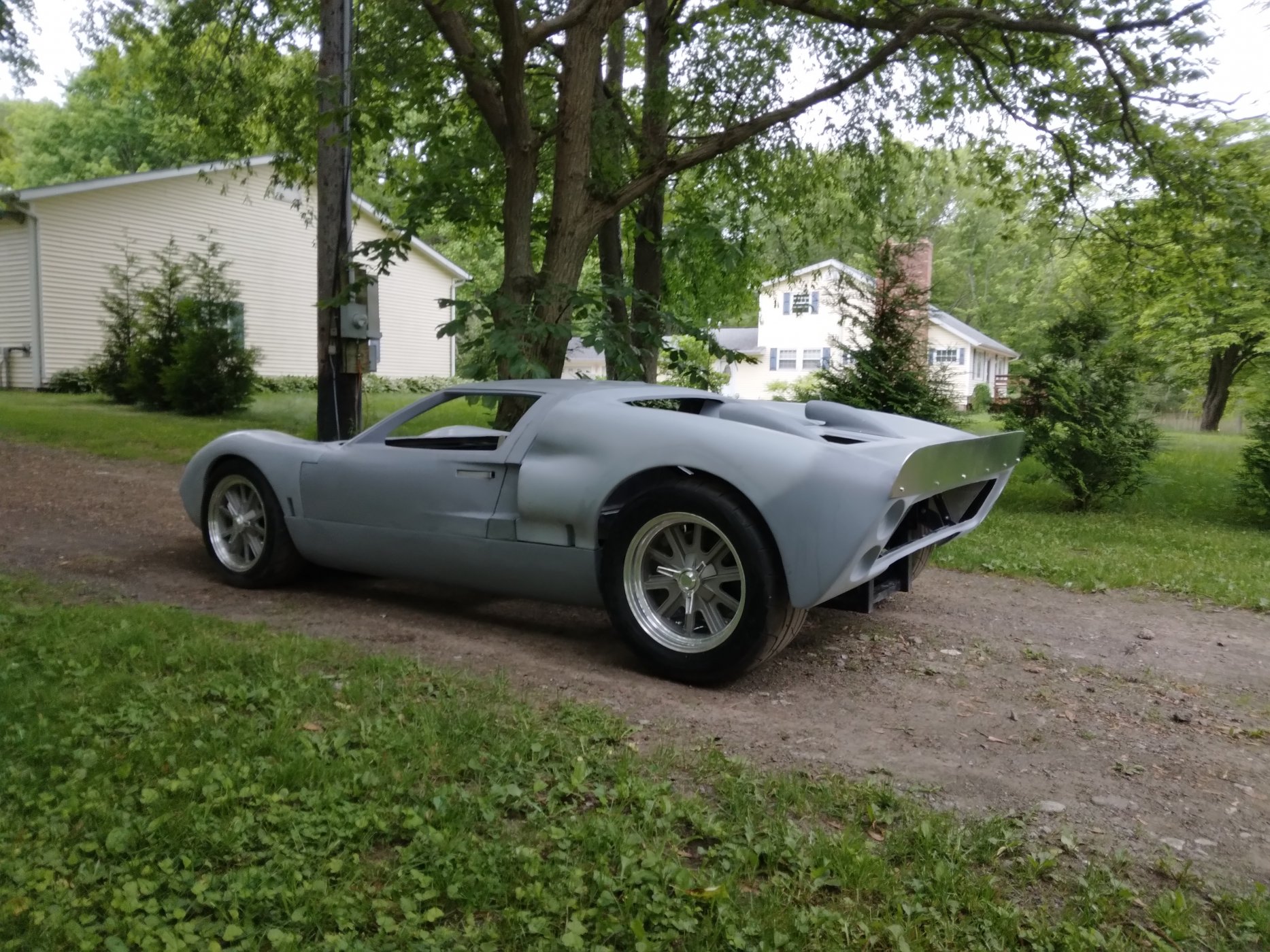

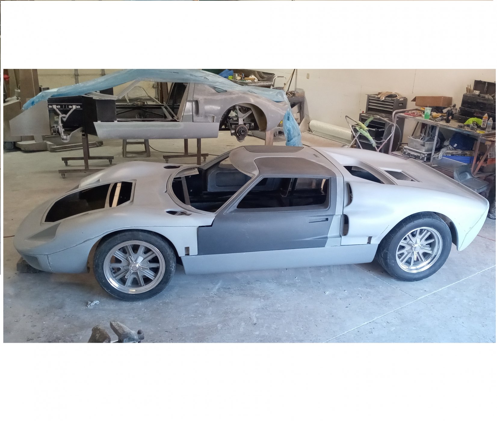

Hi Andreas
That one is going together in Texas, I'll check with the customer and see it he has any updated pictures, I know he was moving right along on it. So wait are you asking about the MK1 or the MK 2 in the picture? The MK2 is in Texas the Mark 1 is inthe bodyshop here. There are several stretched ones out there getting built. Hey any of you guys have pictures?
