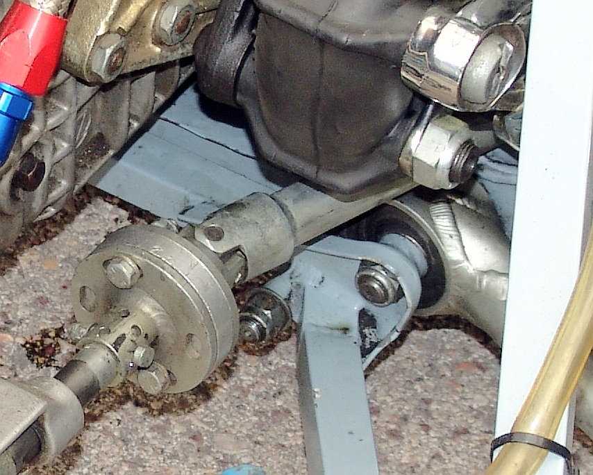

In a similar vein, I am looking for any information for how to fabricate the quick lift hand jack for the GT40 Mk I, including the JW Gulf '68-'69 Mk I's
The front of the car had a lift bar that ran across the front radiator, so the jack had to somehow have the "parrots beaks" on the jack to mate with the front lift bar.
On the back of the car were the parrots beaks, and the jack had bars that mated to the rear pick up points.
I have found the following images partially showing the lift jack:
http://www.nvsaac.com/photogallery/images/GT40/1968/68%20sebring/68seb29y%20Hawkins-Hobbs%20Ford%20GT40.JPGffice:eek:ffice" />
