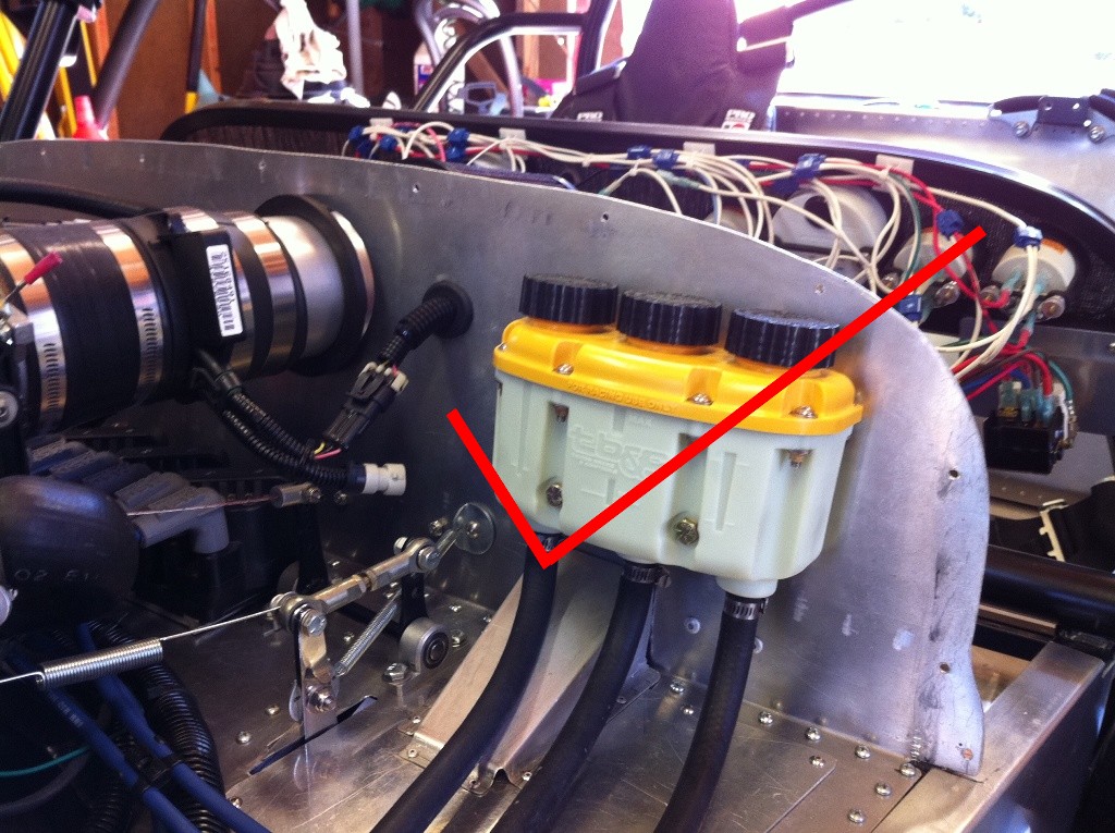

I've had Wilwood "remote" reservoirs leak on three different cars I've had - enough of the madness, my last two cars have gone with this:
Ummmmm..throw the Wilwood reservoirs on the shelf - I've wasted hours on their products in the past. As a company Wilwood does have a deep catalog and has generally decent pricing but....
