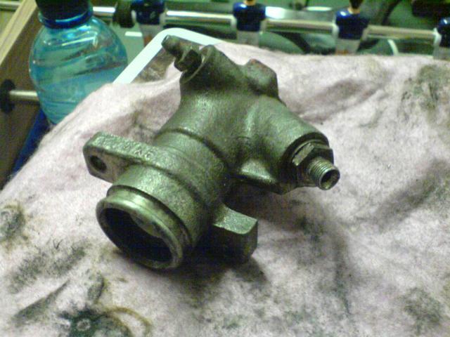

When I got back from Santa Pod, I noted the clutch fluid level had gone down a little, and detected a leak at the slave cylinder.
Since it didn't have an end boot, and there is plenty rust colour in the fluid, I may need a replacement unit rather than just seals.
Please can anyone ID this for me?
Numbers on the casting 8 XF 065 313205
The Transaxle is a Renault UN1 mated to a 302.
thanks
Dave

So far I learnt that a replacement slave is about 120 notes plus vat:shocked: (Eddie Walkers), but they had a good picture which confirmed it looks exactly like Renault 21 T. The cyl bore is not too bad, but the seal is well worn and misshapen, so if I can get a seal kit I'll try that first.

Dave, I think I have a standard piston and seal ( 28mm) which was removed when I sleeved a cylinder to 22mm. If I can find it its yours for the postage. Frank

Chris Cole is just today back off holiday, and kindly phoned me 5 mins ago, he will post a seal kit to me tomorrow.
Dave
SpecialTAuto in Texas sells new, regular rebuilt, and stainless steel sleeved rebuilt Renault slave cylinders.
He also sells seal kits for the new and old style Renault slave pistons.
The stainless sleeved slave is about $90 and comes with a lifetime warranty. Probably the best long term option.
SpecialTAuto requires either a core charge or your core returned.
DMC sells new Renault slave cylinders and does not require the core.
