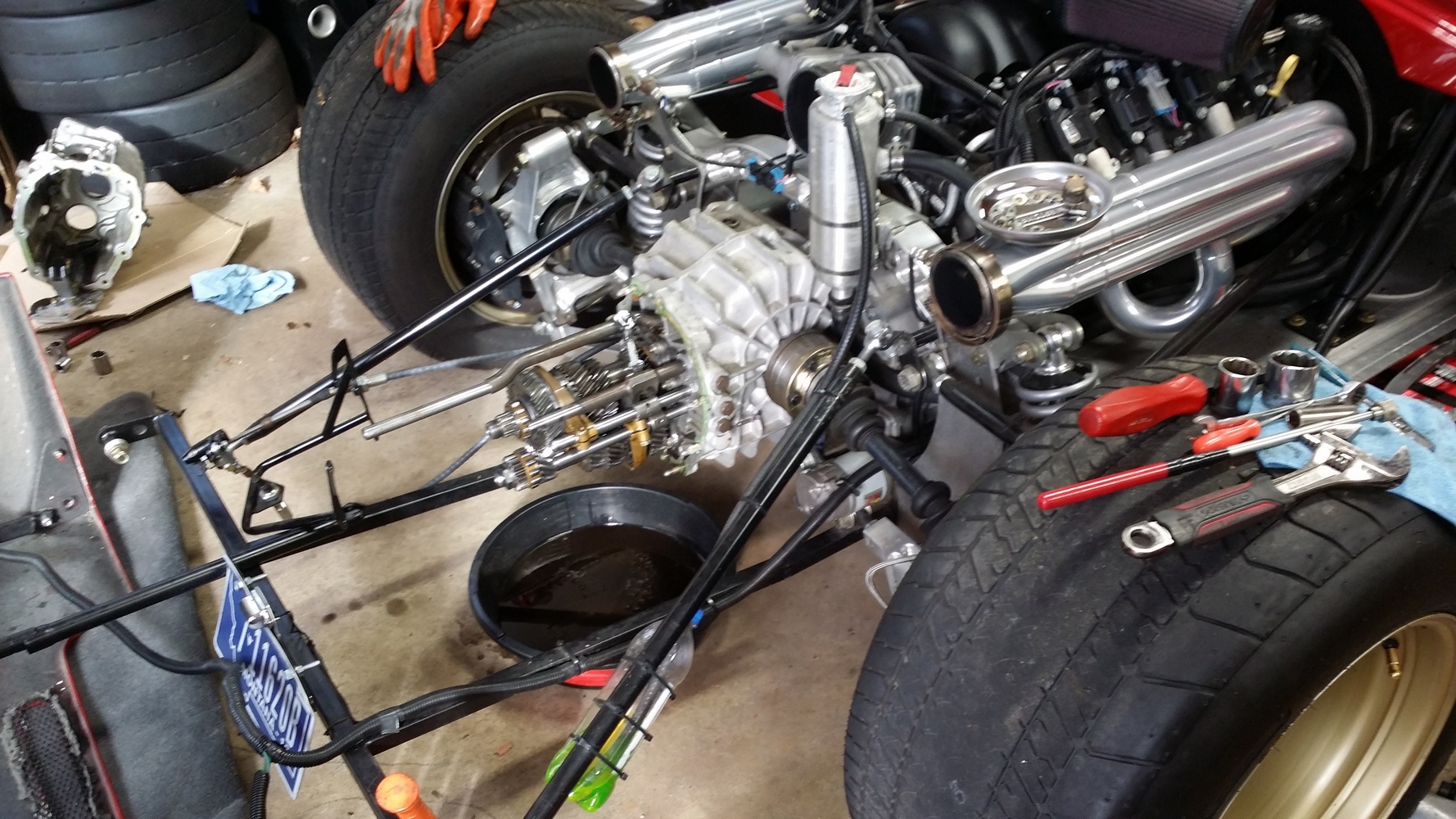

I have an RCR P4, LS3 with 930. I was driving a couple weeks ago, shifting, and the car got stuck in first gear. Completely stuck. Nothing would pop it out of first. Also, It's not a clutch issue. I was far from home and got it towed, since I can only do 60 in 1st/ would overheat. It has RCR cable shift. If you go back to the trans, you can get a slight bit of movement on the shaft fore-aft, but it really doesn't want to twist. In opening the viewing window, I can't see anything broken, and I can probably figure out how to pop it out once I get the diagram, but I'm as much wondering why/how it could possibly get stuck in 1st in the first place if nothing broke? Is there something with the shift cables/ mechanism that could be out of adjustment? And if so, would this cause a 930 trans to get stuck in 1st? I don't want to get it unstuck just to have it get stuck again soon.

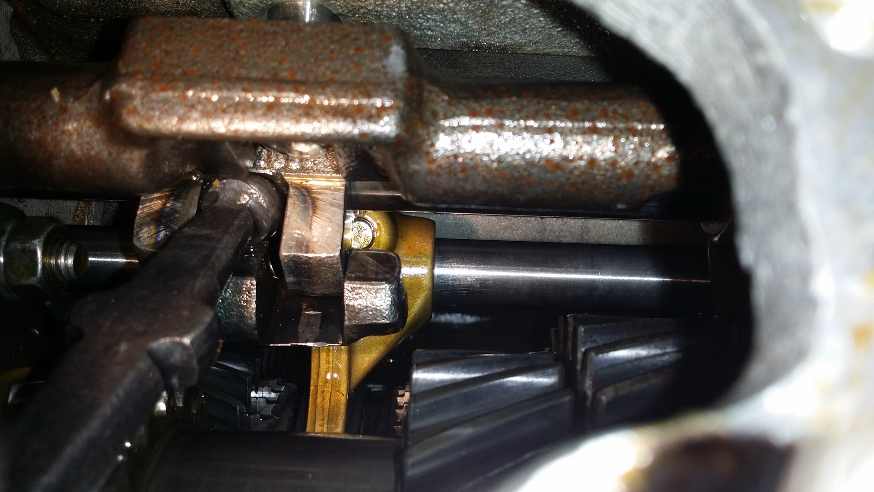

Ok, I had some time this evening in the garage. No issues with the cables. through the viewing window, it looks like the attached photo.
What you are looking at is the Top slot/rail (reverse). Then the middle rail/fork is 1st/2nd. And the bottom is 3rd/4th. So the fork for 1/2 actually rotated (along with the rail, not independent of it). downward to be between the 3 & 4 fork. Nothing is frozen, I can easily rotate it back up & out, and have all the gears again, but after putting everything back in-place and running through the gears a few times, the problem will recur and the car will be stuck in either 1st or 2nd.
I really know very little about transmissions, but I'm assuming that the 1 & 2 rail/ selector fork is not supposed to be able to rotate at all & It is only supposed to go fore/aft. Also, it rotates quite easily, I can do it with a finger. Is this an indication something is broken? Is it possible a bolt holding this rail in place & preventing it from rotating is just loose? Certainly seems like a strange problem to occur...

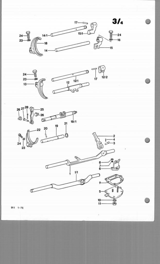

Sounds like the bolt that holds shifter fork for 1st,2nd has come loose or dropped out, pn's 24-23-13 in this drawing, not sure whether you can get this under an cover plug bolt on the case or not, been about 6 years since I was in a P-car box. Probably no one in Houston that can fix the problem....:)

Just an update. jac mac had it. The bolt for the 1/2 shift fork had just fallen-out completely. Pulled the rear and mid-case off, adjusted the 1/2 fork, put the bolt back in (with loc tite), and got it back together... Hard to see how it could have possibly come-out though unless the assembler had simply forgotten to torque it down.
Fourtunately it was all fairly easy to do in terms of access, didn't need to pull the trans.
