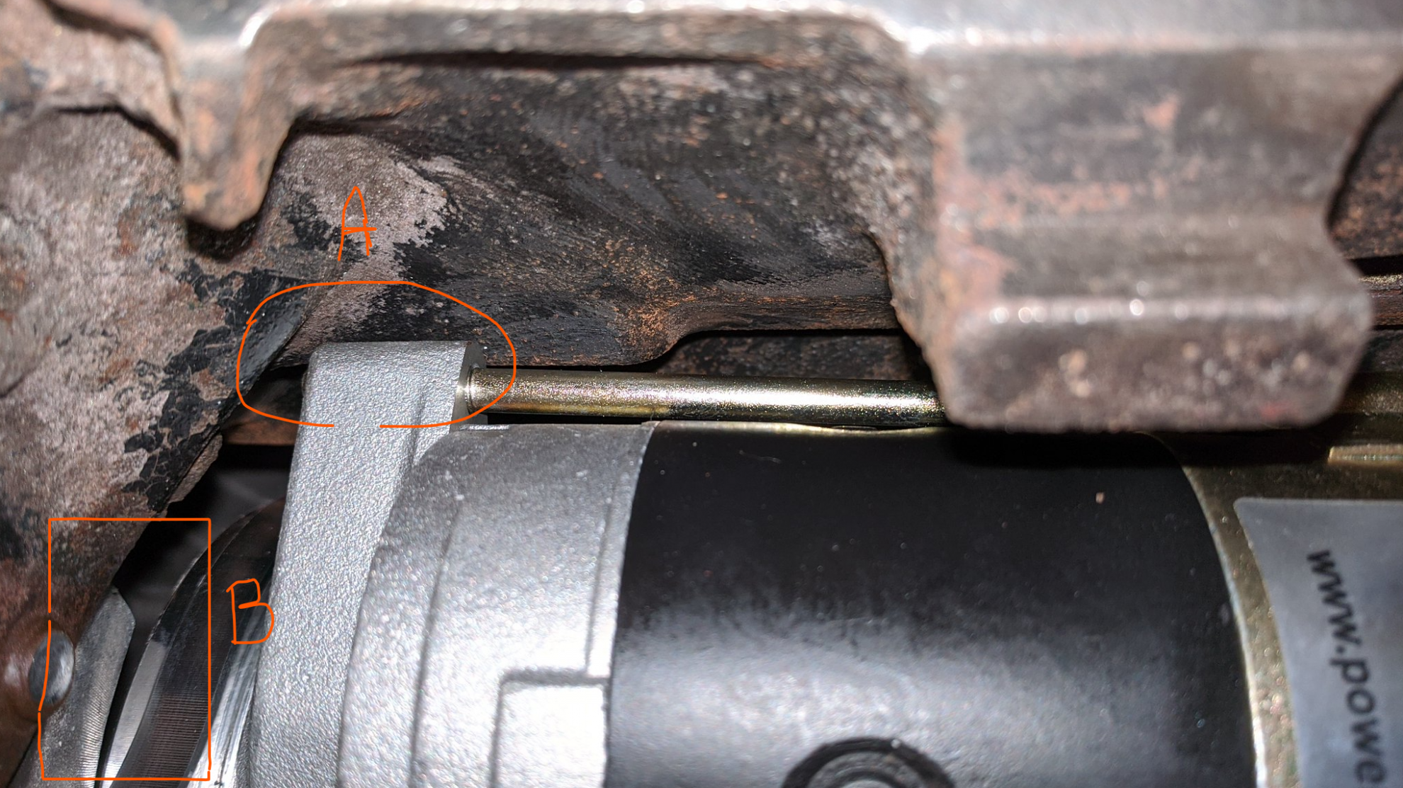

I am just test-fitting this unit to my 302 / adaptor plate / UN-1 combination, and it fouls the engine block...just slightly. I'll try and get a photo later, but has anyone else had to relieve the block to get one of these units to fit correctly?

Here's the issue - the motor body contacts the block at A, before the machined aluminium housing fits into the adaptor plate recess at B:-
Neil
It would be far easier to grind a bit off that aluminum mounting ear than off the cast iron block. You should still have plenty aluminum left for bolt thread engagement.

Bill was, of course, correct. Simply remove the two socket-head screws, rotate the starter in the aluminium adapter and replace the screws. Now I know where my starter cable and solenoid cable need to be located (currently drawing up the loom).
