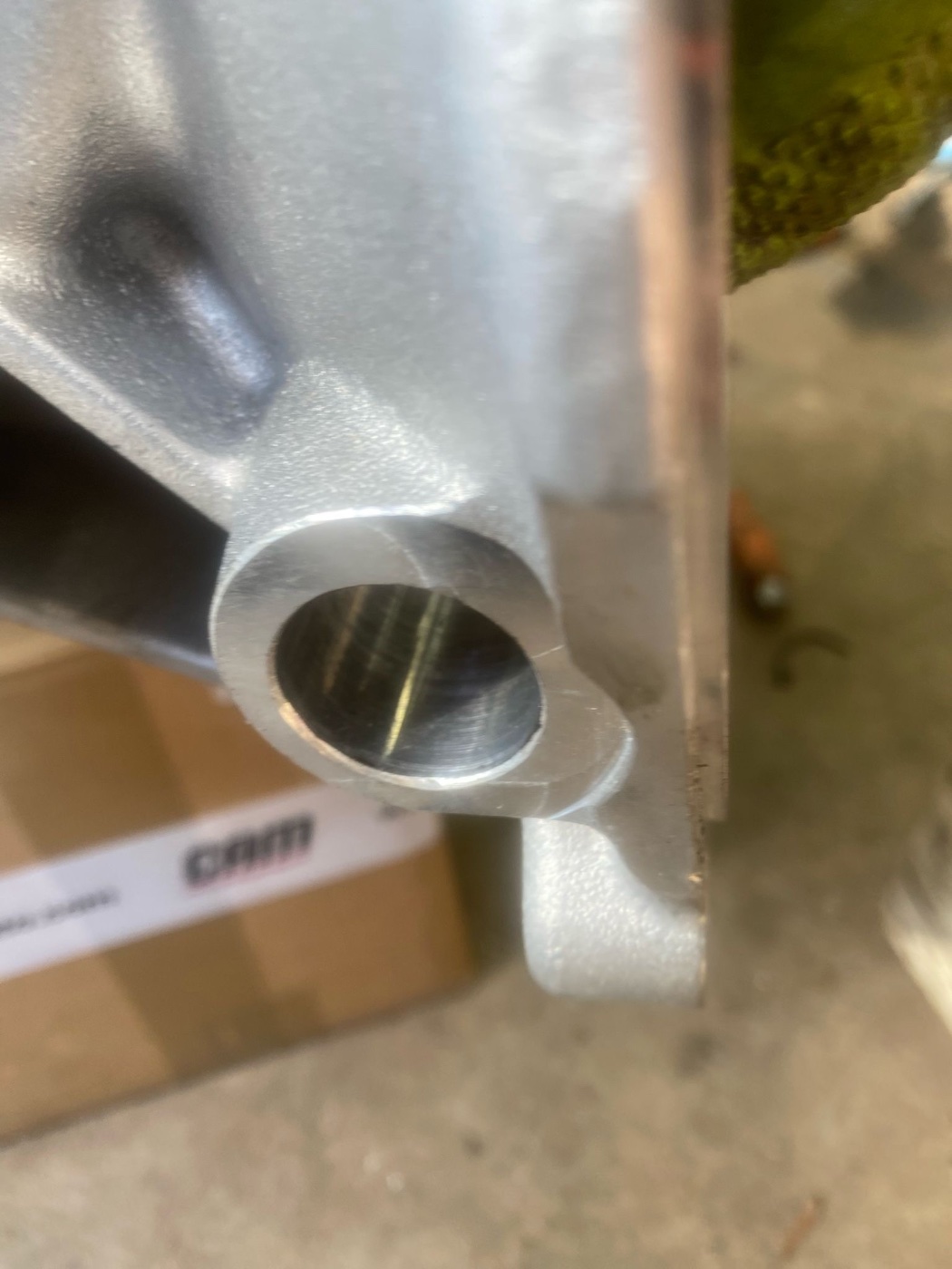

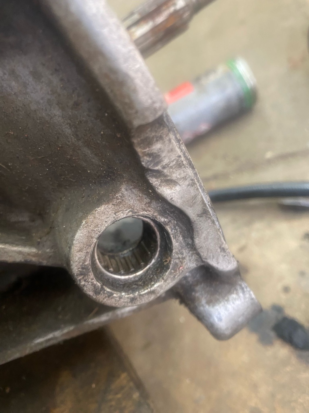

Does anyone know what the roller bearings fitment is for the clutch release shaft?
I've got a new gearbox being fitted and need to source them.
Any help, gratefully received.
It's factory built chassis 20.
Hi, tap the bearing out and get a set of verniers on it and the shaft that rotates with. Then call these chaps and they will sort it for you.

Thanks Mark, Mick kindly gave me the correct spec bearing which incidentally was different from the one Quaife gave me and my brilliant guys got the car back together within one hour of going down to the Members Meeting 82 - to see an Epic Gurney Cup race even if the GT40’s were soundly beaten by a Ferrari 206s, well worth looking up on YouTube.
