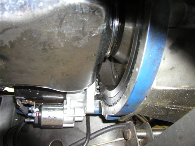

Thanks Jac Mac,
It does appear that there is a shim plate between the flywheel and the ring gear. There just isn't anything between the starter and the bellhousing. There also seems to be pinion clearance but as you suggested earlier, the starter and ring gear centerlines may be too tight.
Thanks Jac Mac,
There does not seem to be any register on that starter snout that would locate in a sandwich plate anyway. Try loosening the two/or three starter attach bolts and apply some leverage to the starter to force it away from the ring gear while you re-tighten it.
Might also pay to remove it and check that there is no part of the bellhousing touching the starter snout when fitted and therefore forcing it deeper into mesh when tightened, a bit of clearancing with diegrinder & burr might be all thats reqd.
