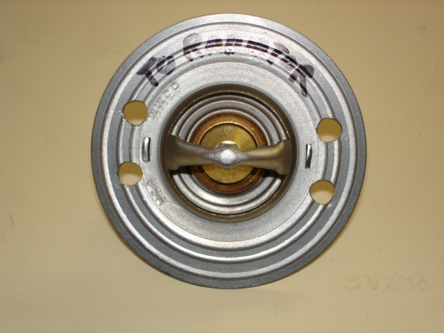

Has anyone solved their unstable temperature gauge with this modification?
