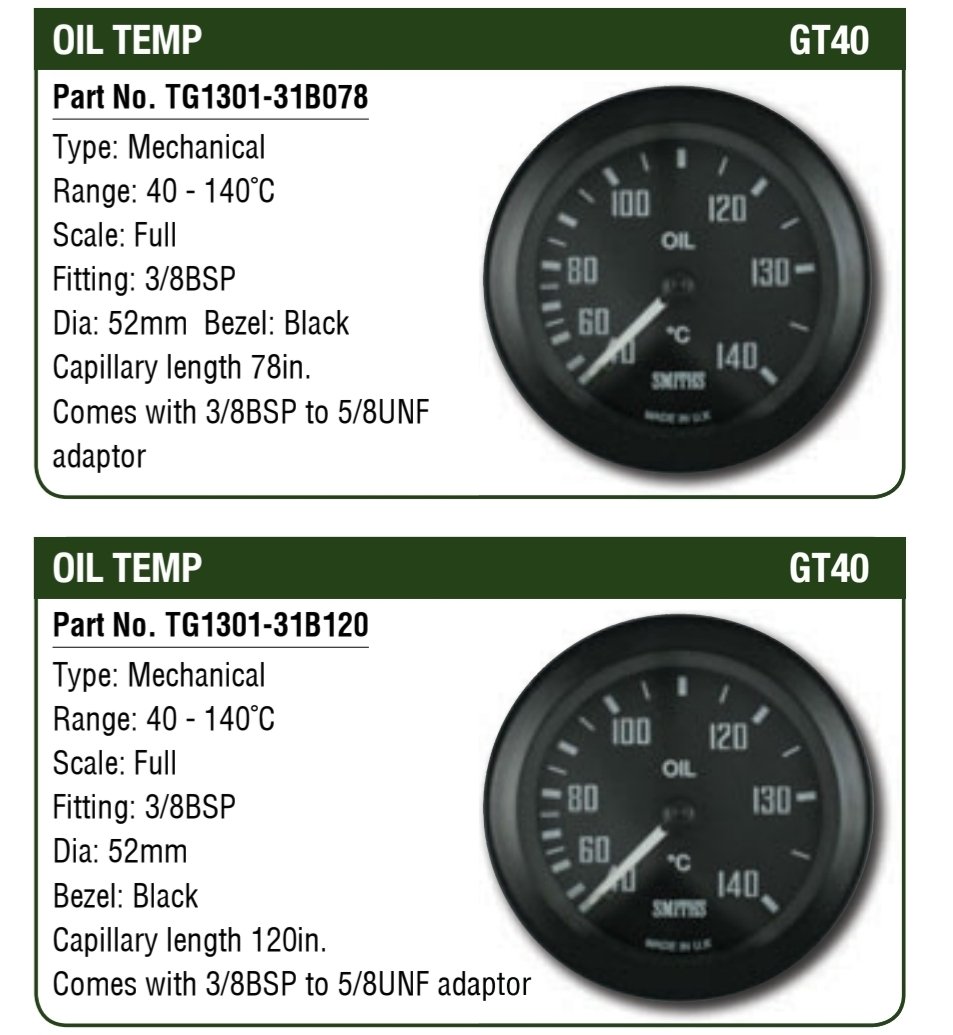

Hello all,
I need to replace the Oil Temperature Gauge on my Superformance.
Does anybody know which length of capillary tube is required?
78 inch or 120 inch?
The same question applies for the water temperature gage?
Thanks in advance.
Lee Patterson
Markus - I think the 78 inch (6.5 foot) length is correct. 120 inches is way too long. Mine came out the center spine and I had enough extra to move them to the side exit out of the tub and right into the pan.
