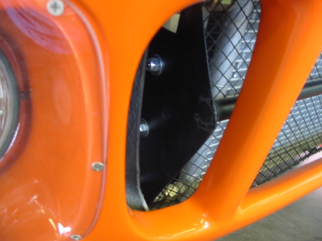

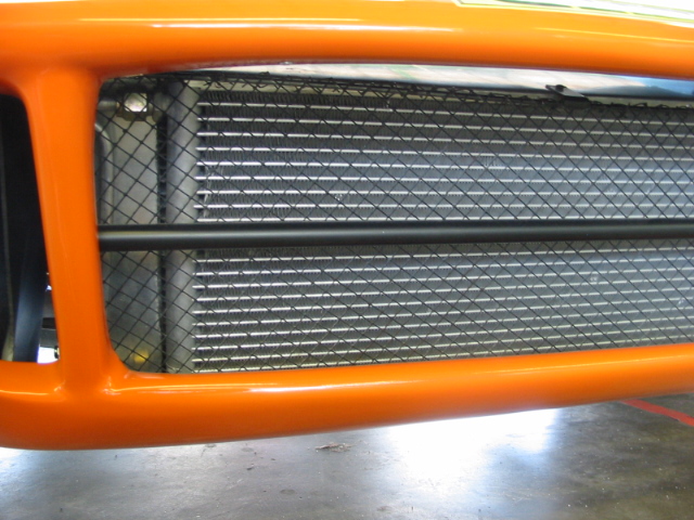

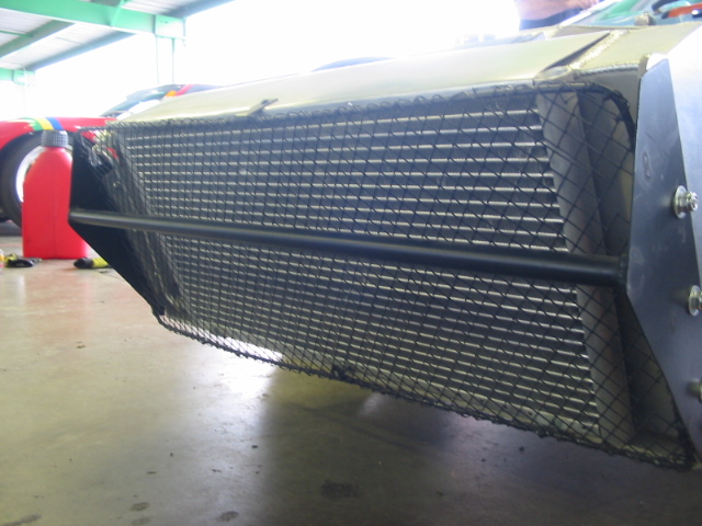

Here are a few pics of Ray's GT from Run and Gun.
Chuck

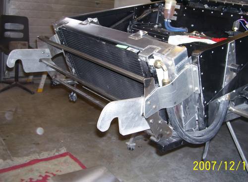

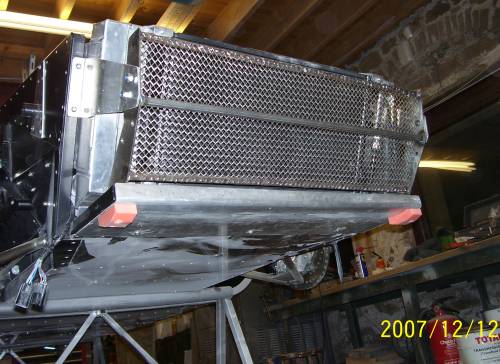

Hi Dean
Here is a picture of one I made for my MDA.
Steve
