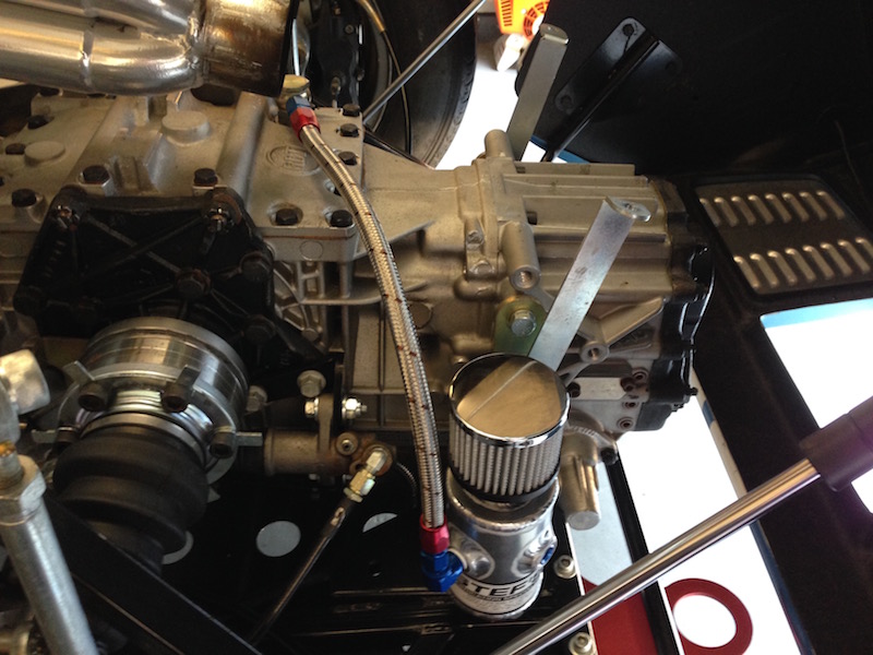

CAV180 has been blowing gear oil out the vent tube, so like some other owners, I have added a catch can. Right now it does not have a flow back capability. I'm still experimenting with the location, but the current version is shown in the photo below.
Just drained the Royal Purple synthetic that Olthoff installed and replaced with dino Brad Penn. I was having some syncro issues with 2nd gear. This seems to have gone away with the dino oil. Just FWIW, one person's experience. It's green, by the way, so you know what it is on the garage floor.

Thanks Sam - some great insight there. I like what you are trying to do with the catch can. The top plug is slightly obstructed by the megaphones, but I think I can work around it. I also just ordered the Brad Penn stuff. Will be doing a flush and replace at the end of the week.
- Jeff
