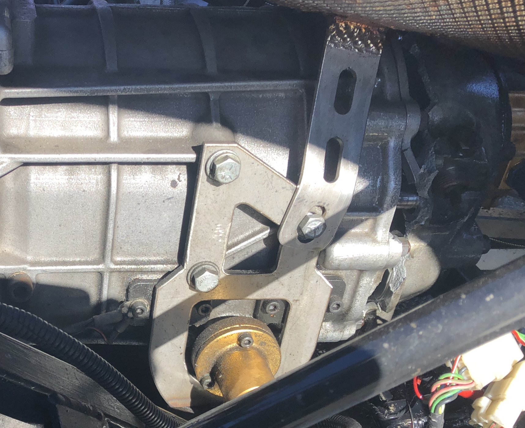

Hi there. I’m new to this forum and please excuse me if the pictures are not taken perfectly. I own a CAV with 427 dry sump aluminum engine with 610 hp and a Quaife transaxle. I purchased it from a gentleman who has really built it for track use and had done that without major problems.
I sometimes compete in quarter-mile events with my 1978 twin Turbo Cummins equipped Monteverdi and regrettably didn’t know about the rating of the Quaife when I participated in a quarter mile race with the GT 40 just for a father and son amusement.
The transaxle went bang when I shifted from 1st to 2nd and cracked the rear case. Now I ordered the billet upgraded version from Tom at momentum motorsports and must say that was a nice experience throughout. Responsible and fast communication and speedy delivery. Unfortunately my transmission specialist who’s been involved in many of my projects in the last 30 years is now retired and has health conditions so I’m looking for an ZF/Quaife experienced mechanic near by. Any recommendations???

A few items: The bracket holding the insulation doesn't have a washer under the bolt head. https://www.bing.com/images/search?...AhFNn3BBewHaFt&idpbck=1&ajaxhist=0&ajaxserp=0
The bolts used are low-grade hardware store quality, the three lines on the bolt head indicate a "grade 5" rating which is fine for your wheelbarrow, but not on a high-performance automobile.
Plus, no washer under the bolt holding the insulation over the transaxle is a crime against nature for any aero/race fabricator. This makes me question the quality of the build. Not trying to be a dick, just asking what you knew about the car before the "big bang".

A few items: The bracket holding the insulation doesn't have a washer under the bolt head. https://www.bing.com/images/search?q=bolt head grade markings&view=detailv2&FORM=IQFRBA&id=CADE0061966443E2432A98F1A75D74B36D5E1CD5&&expw=608&exph=469&mediaurl=https://d2t1xqejof9utc.cloudfront.net/screenshots/pics/7beb7031d3334e6caf3959b317a89c4f/medium.JPG&cdnurl=https://th.bing.com/th/id/R.537e5d39fb90aba72502114d9f70417b?rik=1RxebbN0XafxmA&pid=ImgRaw&r=0&ccid=U35dOfuQ&ck=1163DF82668A1F03E9FCD8B44657F510&thid=OIP.U35dOfuQq6clAhFNn3BBewHaFt&idpbck=1&ajaxhist=0&ajaxserp=0
The bolts used are low-grade hardware store quality, the three lines on the bolt head indicate a "grade 5" rating which is fine for your wheelbarrow, but not on a high-performance automobile. View attachment 142116 Plus, no washer under the bolt holding the insulation over the transaxle is a crime against nature for any aero/race fabricator. This makes me question the quality of the build. Not trying to be a dick, just asking what you knew about the car before the "big bang".
agree on the washer, don't agree on the quality of the bolts. You don't honestly want a 12.8 to be used to secure whatever to an aluminum housing ? I bought it from a gentleman who had it being built by a reputable race shop in Hamburg Germany and it was not used as a trailer queen or to show off in the neighborhood but was for. example on the racecourse of Oschersleben 1.5 seconds faster than the fastes lap with his 600 hp Nissan GTR. He tested several set-ups regarding the exhaust and must have forgotten the washer.
