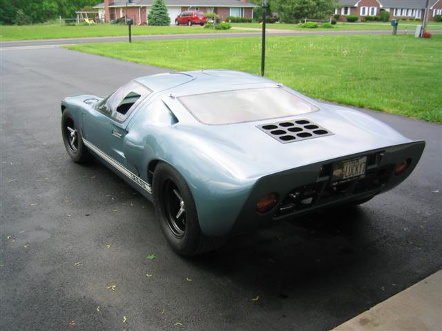

........If it's flat, are you planning to dome it and if so, how?.....
Mark,
Here's my trick to doming the rear window:
Close the rear clip and let the motor run and heat up the rear window. The warm motor will make the plastic droop in about 20 min. Open the rear clip and with a soft towel push lightly from the inside to get the desired dome. I then wedge a couple towels between the window and rear clip to maintain the dome while it cools. Let it cool down completely (the cooler the better) before removing the towels. It should now retain it's dome shape though many heat cycles. Hope that helps:rolleyes:

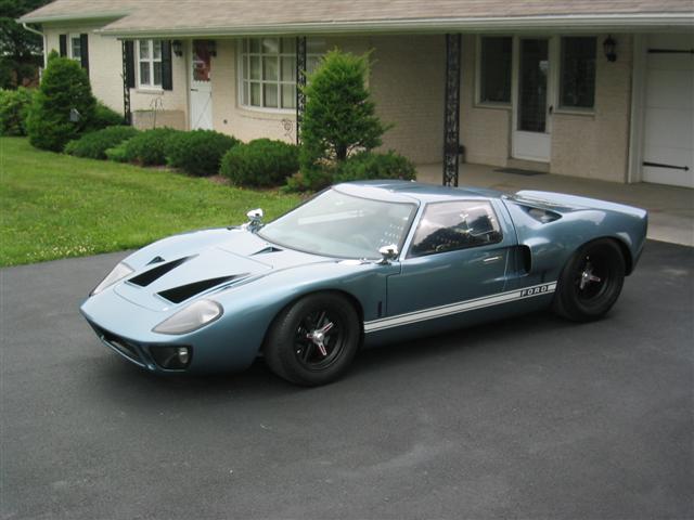

Ron McCall

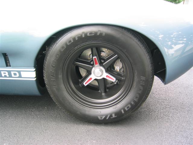

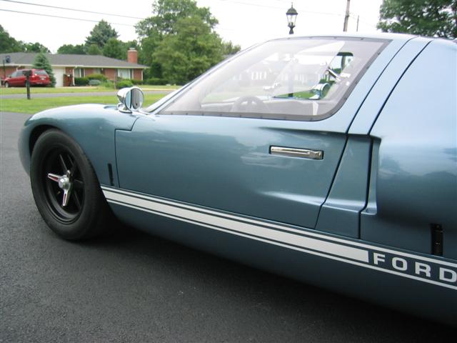

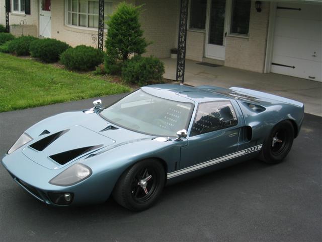

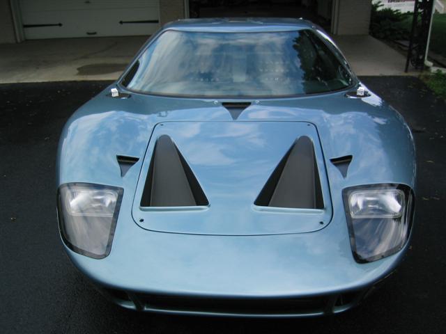

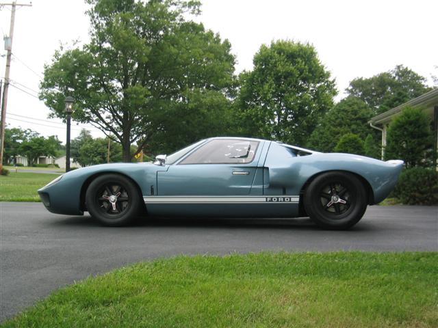

Not much to update.I have been playint catch up on work I put off to get ready for Carlisle. I have also been driving the wheels off of my Pantera!
I did manage to get the window hardware installed,install the mirrors,make leather limiter straps for the rear body section,and get the engine ready to reassemble.(waiting for the heads to return )
Here's a few pictures I took this morning.
Ron
