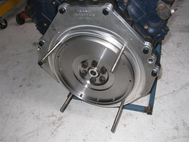

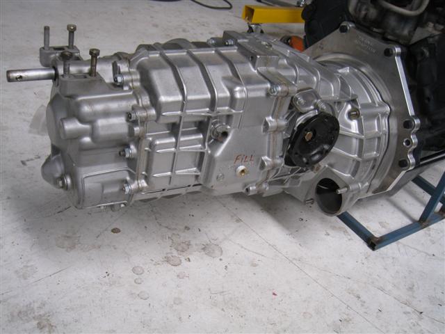

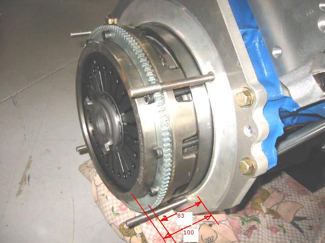

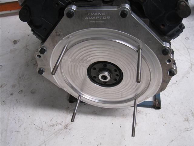

As Howard says --you need the flywheel first for Ford motors and be sure of the imbalance, eg 28oz, 50oz, or neutral.

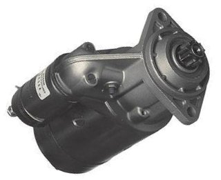

As for the starter, try and use the Porsche starter over the after market ones --it is made for the job !
Should look something like this :-
(the adapter plate for an RCR has chassis mount lugs)

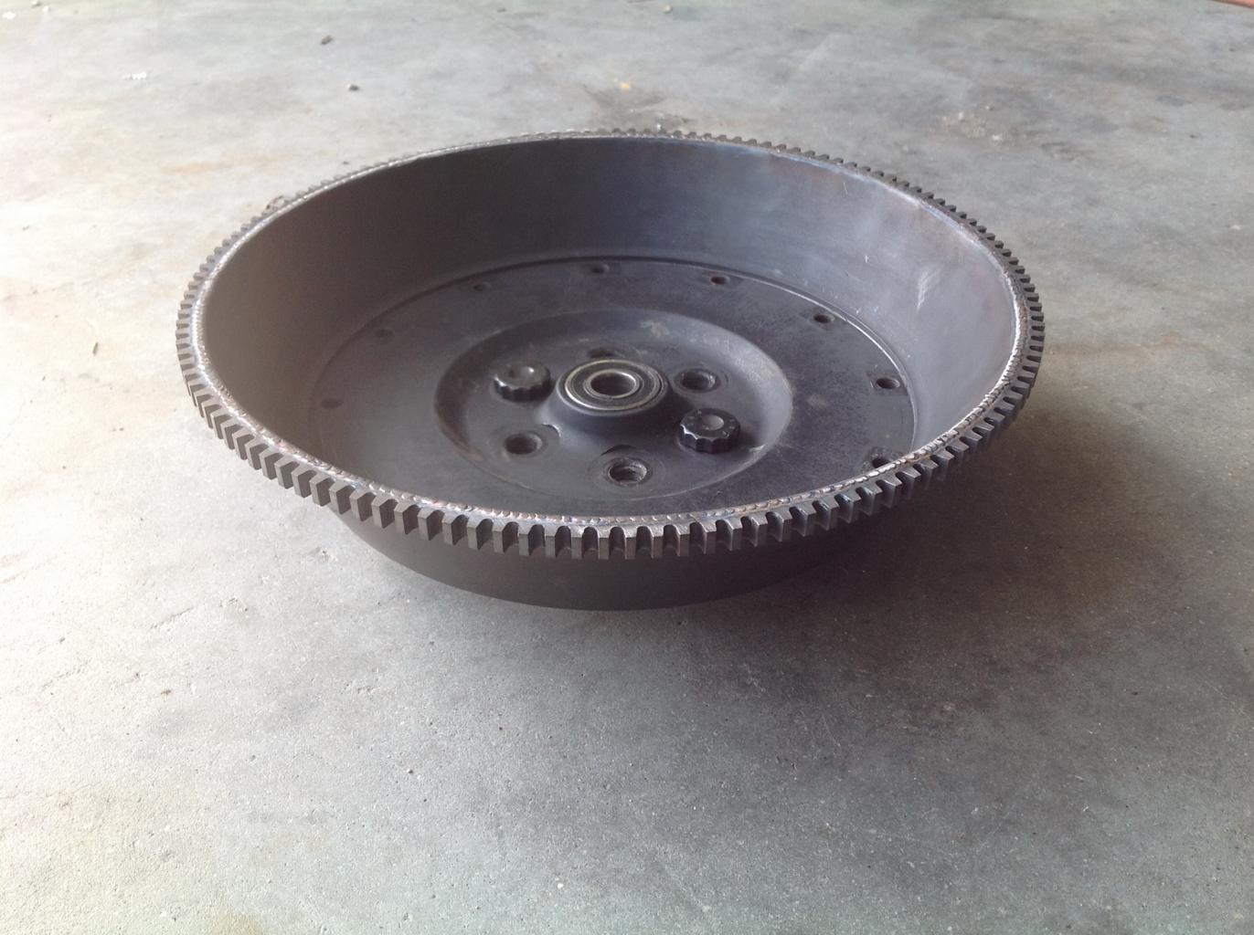

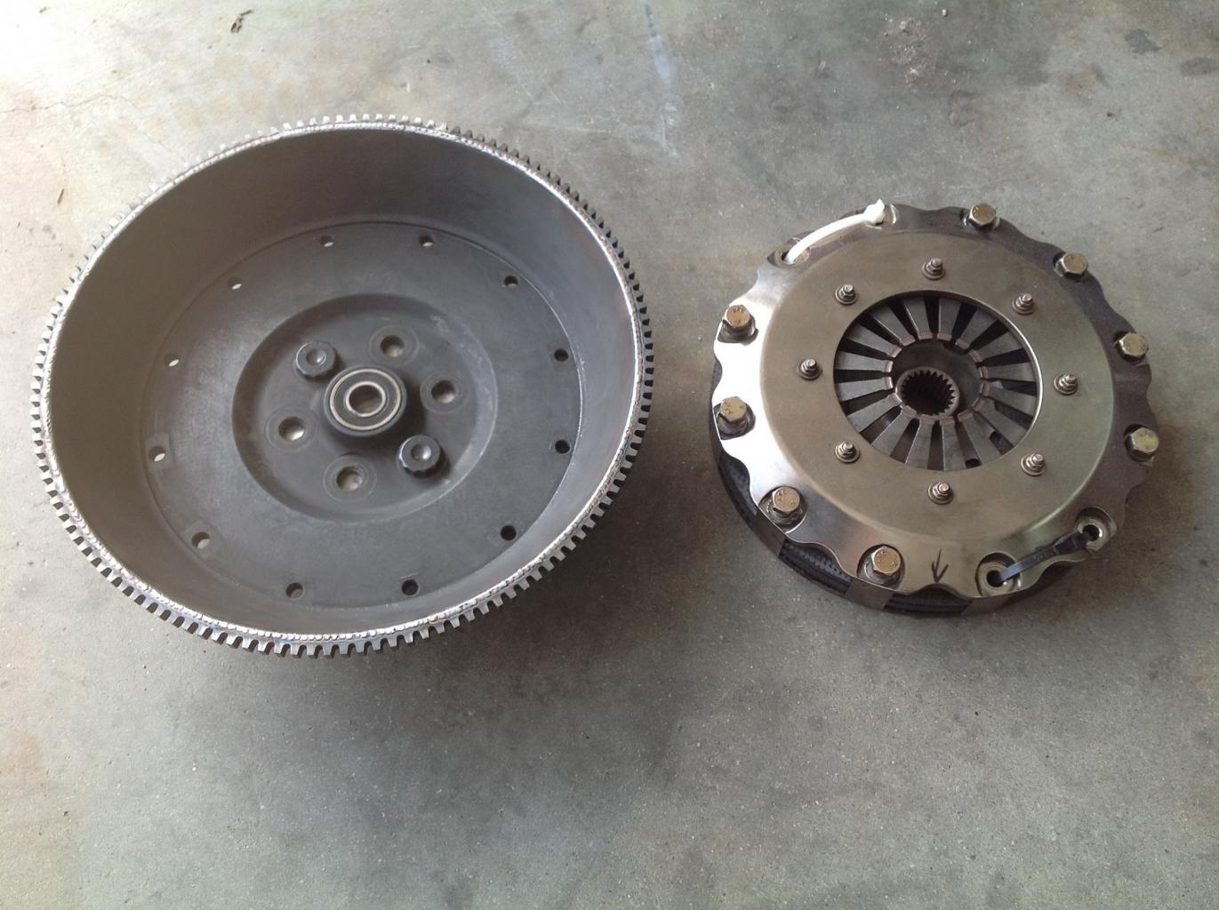

Back around 2005 when I originally had my G50/52 set up, the recommendation was to shorten the bell-housing by 1 inch and machine a small amount out of the inside of the bell-housing for clearance to use a 930 ring gear. Tilton then machined a custom flywheel / ring gear mated to a two disc carbon clutch.
I've had issues with Tilton's engineering and machining of the flywheel from the beginning (long story, but the flywheel and ring gear is a billet machined one piece unit). Finally, a month ago the ring gear developed enough damage that I've had to machine off the old teeth and weld on a new 930 ring gear.
I wasn't aware of an early vs late model G50 and what difference there is between the two but from what I've gathered, for this match up, Kennedy sells a 132 tooth ring gear matched to a 10 tooth starter. I say "from what I've gathered" because it seems no one will give me a direct answer when asked for specifics e.g. What's the difference between a 930 & G50 ring gear, nobody seems to know!
Chris, when you say stick to a Porsche starter, do you happen to know the Porsche part number? Based on your pictures above it's a short throw pinion as opposed to the long nose. I would be interested to know what tooth count your ring gear and starter pinion gear are.
Hope I'm not hijacking your thread Jim but I think this information will be helpful to you.
Tim

flatchat(Chris)
we use :- starter 911 604 101 01 , 9 tooth and 1.5 hp
ring gear 950 116 143 01 (looks like 132 tooth )
