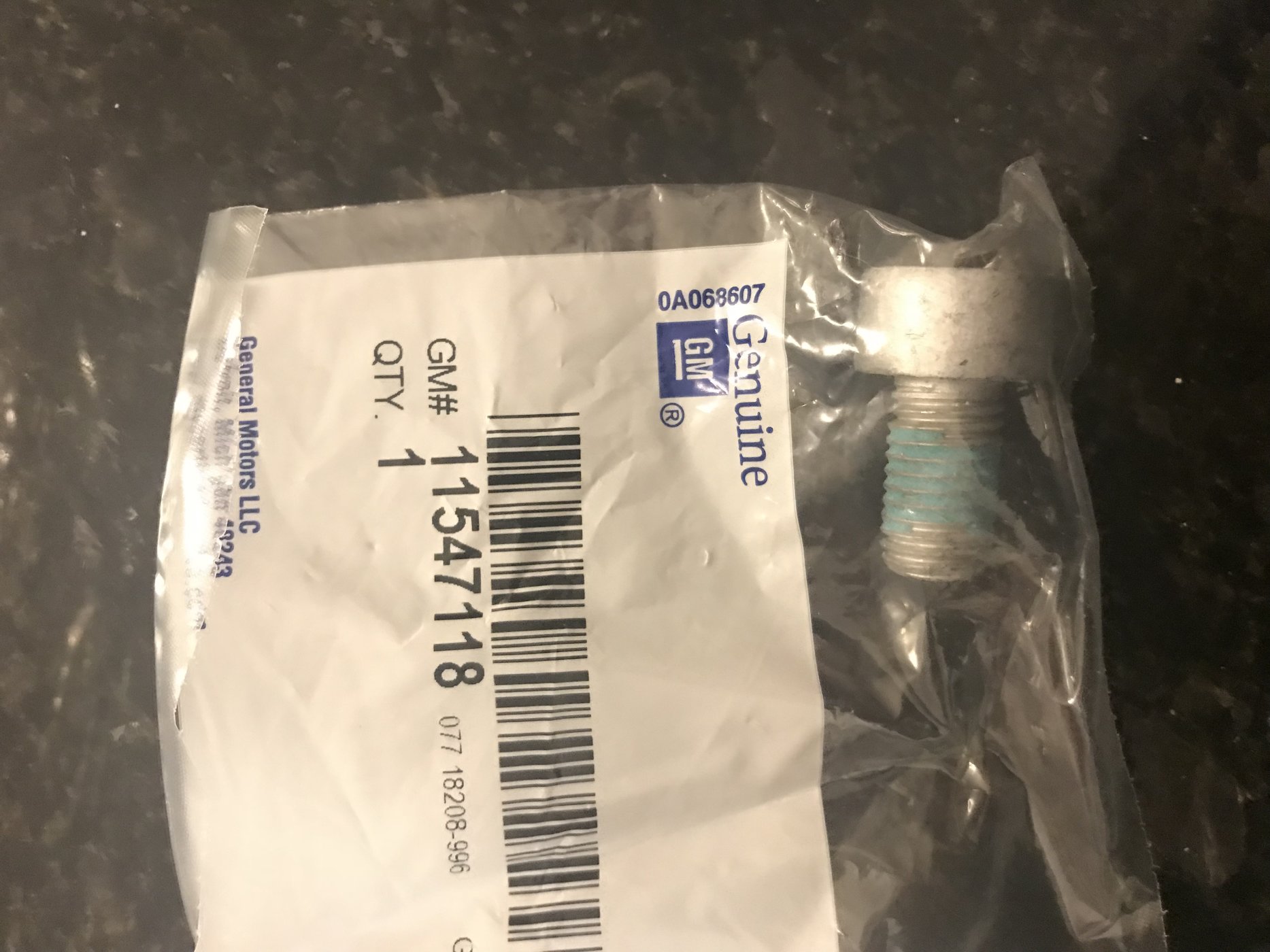

Picture of new stock bolt...

The new bolts already have the threadllocker on them in stick form. You could chase the threads in the crank with a thread chaser but don’t use a tap.

That’s probably just the remains of the threadlocker that was contaminated with oil. Were the bolt holes at the 12 o’clock position also the same black colour. Did oil contaminate them as well? Install the bolts dry. No anti seize. I’ll read my C6 Corvette factory shop manual to see what it mentions.
#5
Factory manual said to install GM #12345382 threadlocker . Tighten bolts first pass to 22ft/lbs. second pass at 40 degrees. (Torque to yield) This was for a LS7 engine though. The threadlocker is already installed on your bolts so you are good to go.

Poor advice to put them on without threadlocker (LS1tech). Especially when GM pre installs it on the bolts.
WhatI meant to convey is that they have the bolts with the factory thread-lock pre applied and were told the bolts can be installed as-is with no additional thread-lock.
