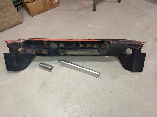

Hi Rod, Actually dashboard is an old terms for the curved wooden protector on the 1890’s to 1910’s. It keep the dash (horse poop) off of you. And this term lasted until now. Yes, instruments were added later. I am looking for pics as well as someone to talk on the phone with. It’ll take forever using these threads. I have the track day cage. I am wondering what you do with the indentation on the top of the panel. I’ve cut the mold waste and am in the rough fitting portion. The roll cage is off right now (I am working the engine). Which forum has the information and pics? It’s nice to meet you.

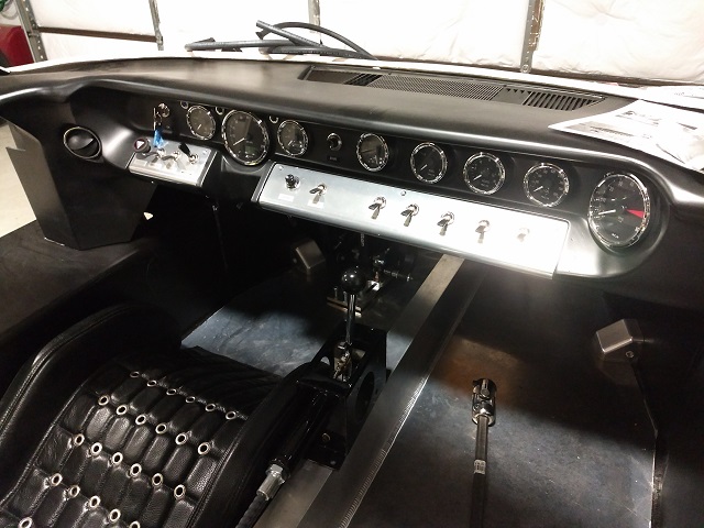

Jim & I talked over the phone and I sent him a few pics of what I did with my dash panel. Everything fits nice & cozy although it is an absolute bugger to get it in and out along with the roll cage. Your mod sounds interesting. Let's see some pics of both yours & the P1015.

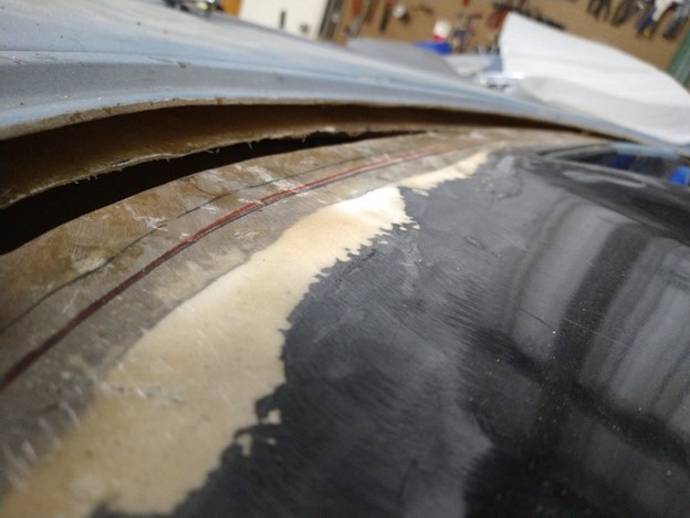

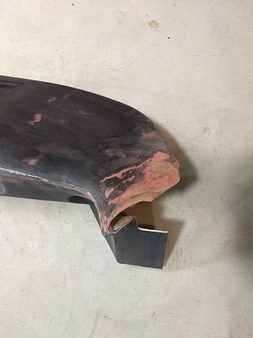

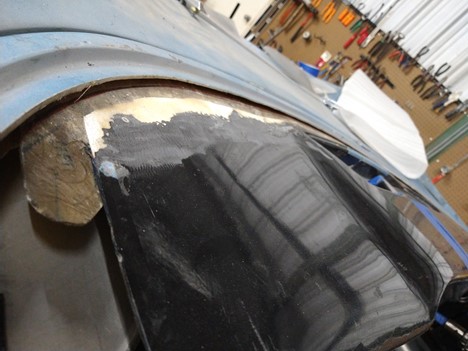

Attached are a few pictures. The first pic shows the fabricated lip on the spider and the fabricated dash extension. That dash extension slips into the lip and supports the front of the dash. On the 3rd picture you see an extension on the side of the dash. I will make a piece to fit in the space in front of the roll bar. It will be supported by the lip on the spider and on that side extension and hopefully it will all look nice with one seam. This way I can pull the dash with the roll bar in place and at the same time the dash looks like it runs from roll bar to roll bar.
