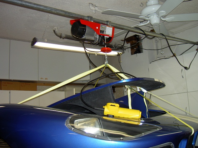

Personally I would prefer a skyhook but lacking one of those I've removed and reinstalled the rear clip of my SPF MK1 by my self but it requires mechanical help. The first time I put the rear clip on by myself I used a moving pad and a two wheel dolly. Not a process I would recommend or ever do again.
With a little preparation an engine hoist works very well. I used some lifting straps from Harbor Freight threaded through the carburetor cold air intakes. It balances very well and is a straight lift to remove it from the car (don't forget to unplug the tail light wiring). If you have the room just leave it on the hoist with some padding, if you don't transfer it to a hook hung from the ceiling otherwise you have to deal with banging it into the legs of the hoist when you put it down and pick it back up. You can ask me how I know but then I would have to lie.
