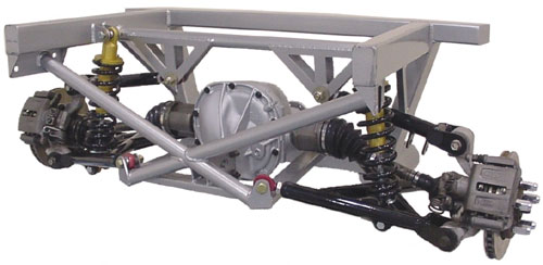

The photo below is FFR's IRS setup from their website. It uses the T-bird uprights, hubs, and brakes. I'm thinking of doing something similar.
Originally I was going to use the C4 Corvette front suspension and DRB rear uprights with the Corvette hubs and brakes. When I had the chassis design 80% or more done I made a full size wooden model to determine my body, engine, and transaxle mounting. It was then I discovered that due to the length of the Corvette lower control arms I didn't have much room for my feet. A desire to use a BRM style pin drive wheel rather than the deep backspace type used on the Corvette didn't help.
I found that the pin drive width front suspension that FFR uses on their roadsters has a control arm that's about 2" shorter than those used on the Corvette, so I decided to go that route instead. Since I changed to Ford hardware in the front, I figured that I would use the T-bird stuff in the rear to be consistant.
