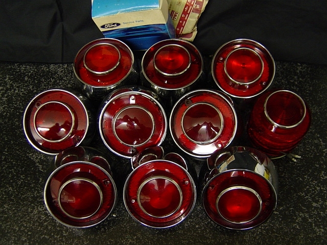

Jimmy can you give me the OD on the main body and the OD on the inner lamp body please.
Jim

JimmyMac
G'day Jim,
The chrome body is 117.5 mm O/D and the lamp body fitting is 26mm O/D
If you need any more info just drop me a PM.
JimmyMac
Cliff,
1963 Mercury Monterey tail light.
They do require some machining to get the bases flat.
Cheers.
