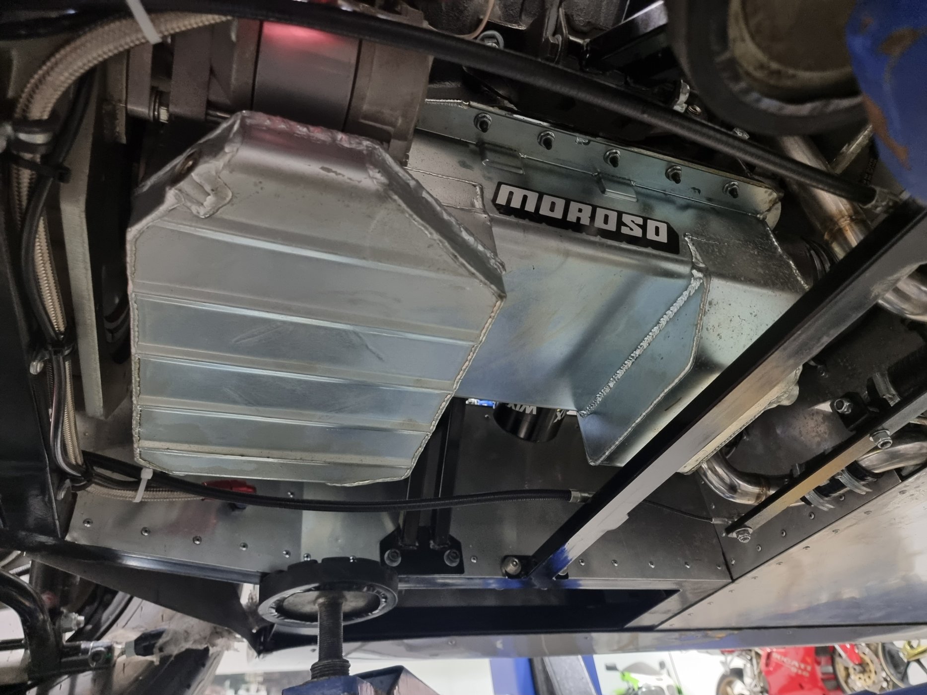

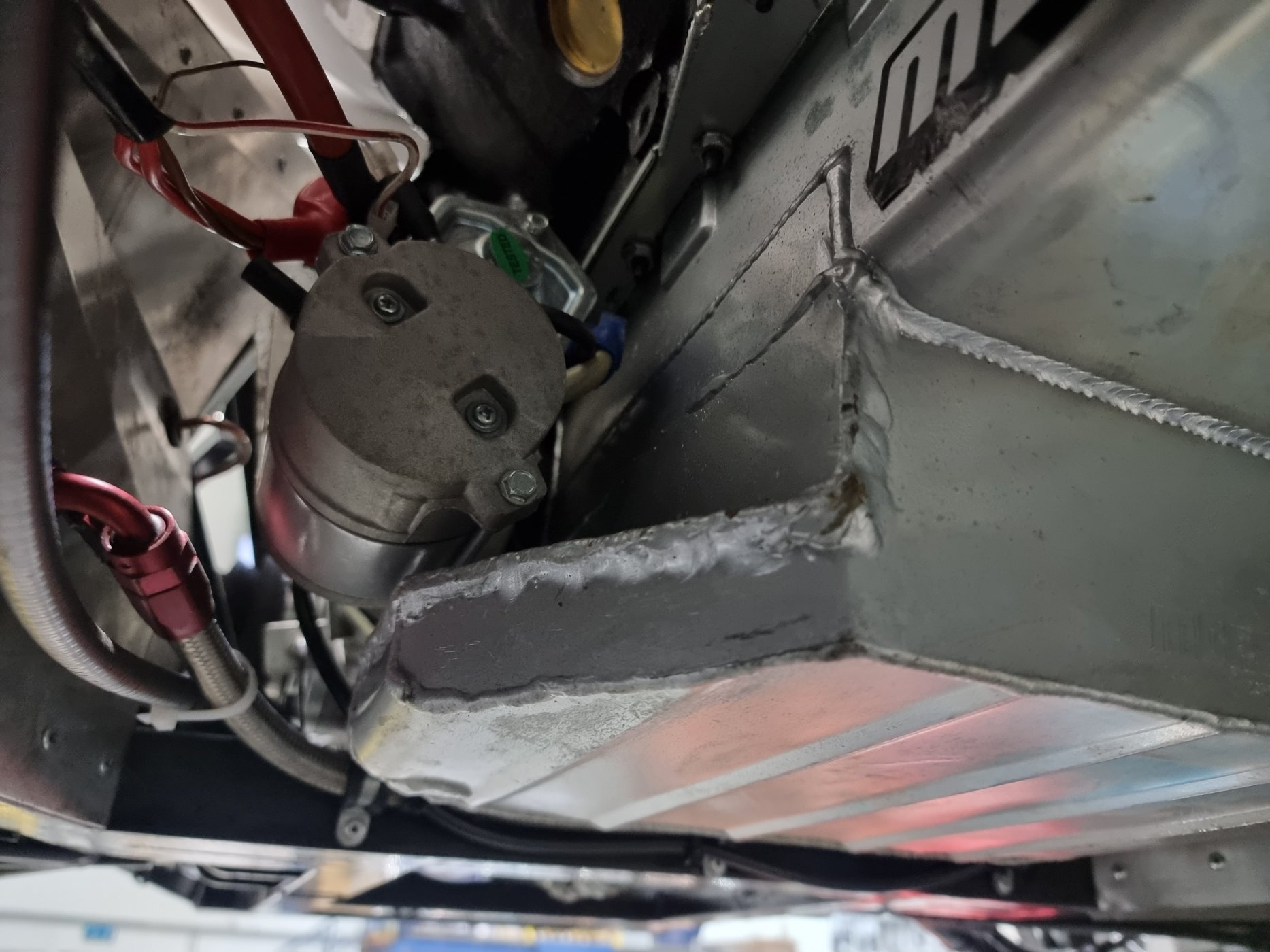

Hi, I used a Moroso. Part number Mor-20534. I Have a Renault box and it failed the starter so had to be modified slightly. Southern GT also. The cars currently on a ramp so I can take a picture tomorrow so you can see the fit. Pan/dipstick and gaskets all from Summit. Good service.

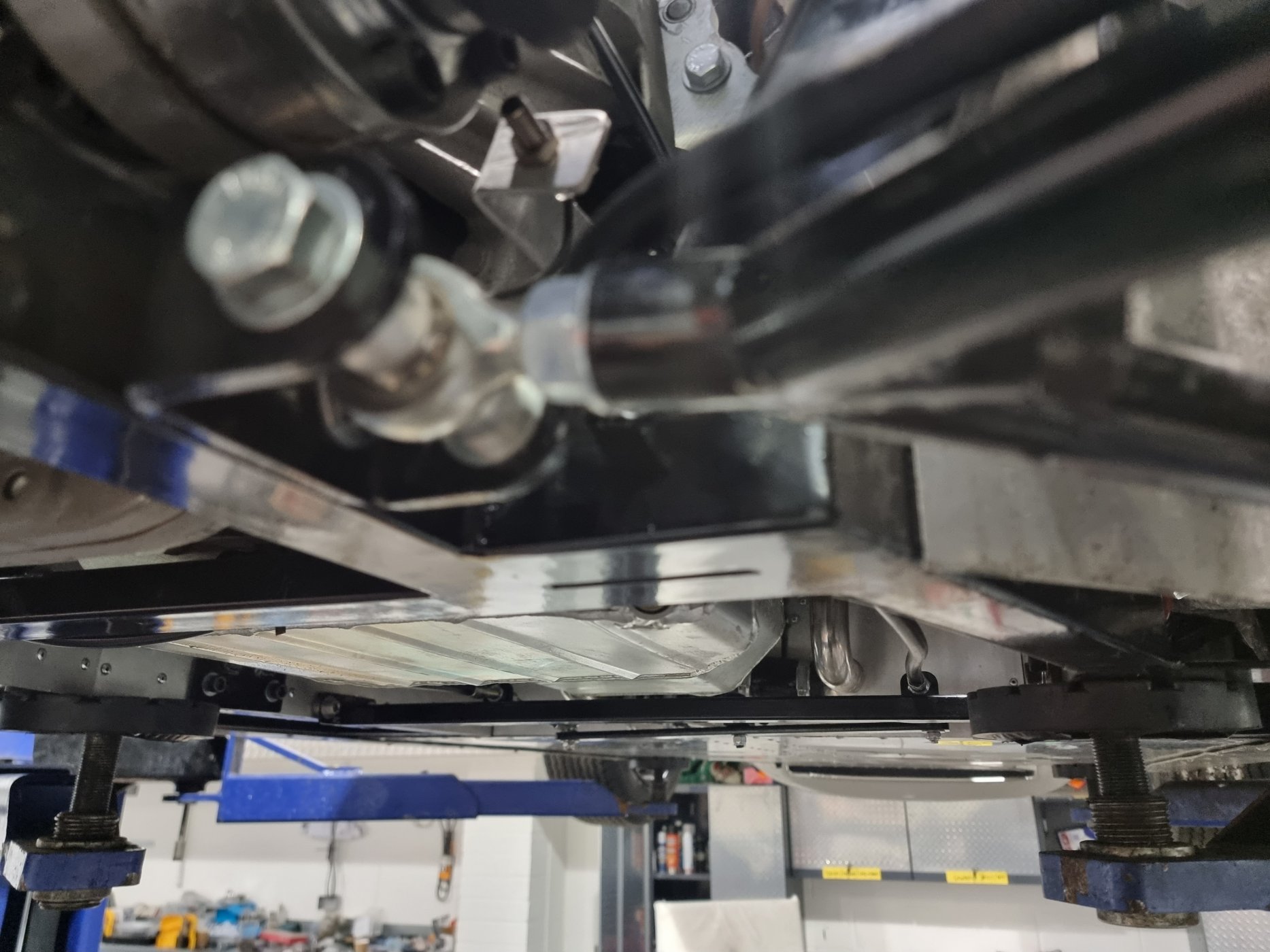

No problem. Here's a couple of pictures to show so how it fits to the car and also the notch out for the starter. I have the part numbers for the oil pickup etc if you need them.
