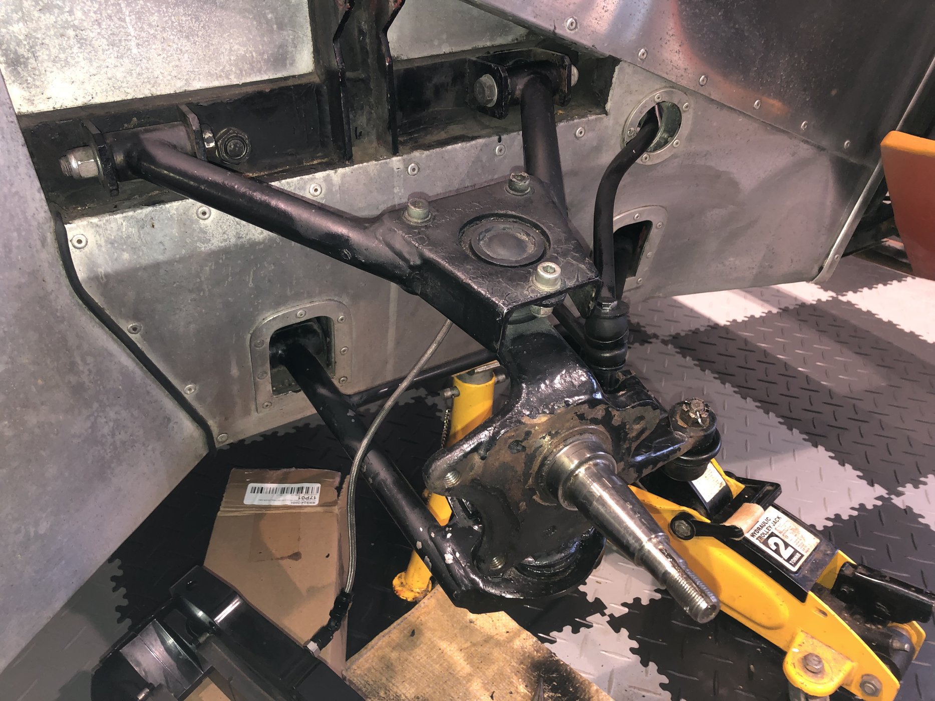

Guys. I’m looking to get all of my suspension arms removed on my GTD so I can get them powder coated. They used to be chrome and previous owner just painted over them in black rather than doing the job properly.
The lower front bolts though are hidden behind panels so before I start drilling rivets out, do any of you have the build manuals so I can tell which panels I need to remove to get to the bolts?
Help appreciated at always.

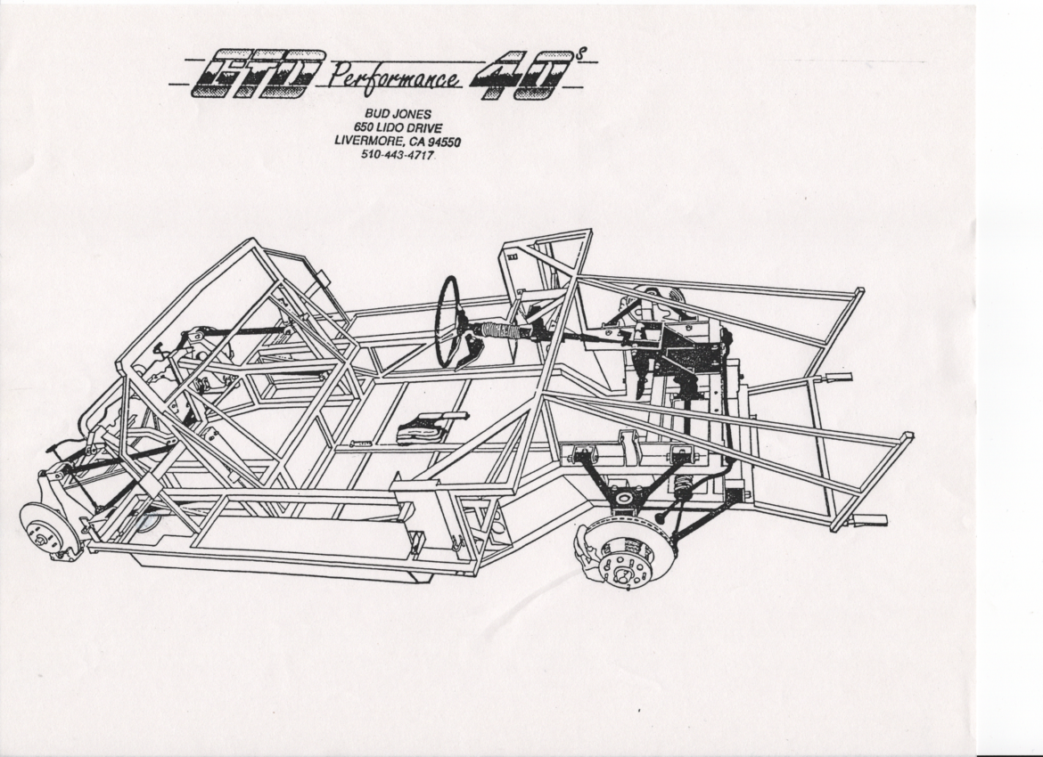

You should find the bolts when you remove the water pipe cover in the footwell and the small cover in the opposite footwell. Attached is a frame drawing with the gladding removed. I hope this will help you.
