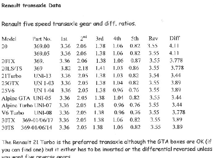

I have become a bit confused about the various sub-species of Renault gearboxes that abound.
There were the Renault 21 turbo, Renault 25 turbo and Renault 30, which presumably used variants of the box such as the UN1-08 and UN1-013.
But which car used which box - and then what ratios and final drive were fitted? Confusing?!!
Wouldn't it be nice if SOMEONE WHO KNEW brought all this information together into a table, showing which cars were fitted with which box and their gear and final drive ratios. . . . .
If only Chris Cole had e-mail!
BTW, thanks to Chris Parker for publishing the info about the UN1-013 identification tag on the recent fifth gear thread.
Tony
Hope this is of some use, dosn't come out very clear /ubbthreads/images/graemlins/confused.gif if you mail me I will send it in Word format.
Model Part No. 1st 2nd 3rd 4th 5th Rev Diff
20 369.00 3.36 2.06 1.38 1.06 0.82 3.55 4.11
369.05 3.36 2.06 1.38 1.06 0.82 3.55 4.11
20TX 369. 3.36 2.06 1.38 1.06 0.87 3.55 3.778
20LS/TS 369 3.82 2.18 1.41 1.03 0.86 3.55 3.778
21Turbo UNl-13 3.36 2.05 1.38 1.03 0.82 3.54 3.44
25GTX UN 1-03 3.36 2.05 1.38 1.04 0.82 3.55 3.89
25V6 UN 1-04 3.36 2.05 1.38 0.96 0.76 3.55 3.89
Alpine GTA UNI-05 3.36 2.05 1.38 1.04 0.82 3.55 3.44
Alpine Turbo UNl-07 3.36 2.05 1.38 0.96 0.76 3.55 3.44
V6 Turbo UNI-08 3.36 2.05 1.38 0.96 0.76 3.55 3.778
30TX 369-01/06/17 3.36 2.05 1.38 1.06 0.82 3.55 3.89
30TS 369-01/06/14 3.36 2.05 1.38 1.06 0.82 3.55 3.89
The Renault 21 Turbo is the preferred transaxle although the GTA boxes are OK (if you can find one) but it either has to be inverted or the differential reversed unless you want five reverse gears /ubbthreads/images/graemlins/grin.gif
Tried to attach a scan of the Word doc
