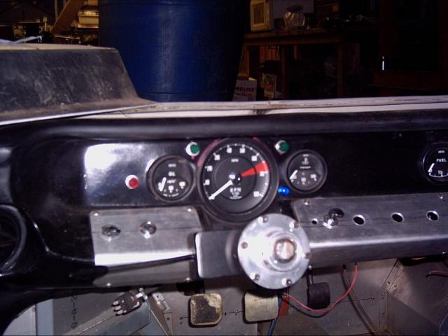

Here is a photo of my mounting, I had to fab an adapter hub to take the aluminum hub supplied with the removable coupler. The column in my chassis is an aluminum tube with bearings at either end, and a 3/4" steering shaft. I simply welded and pinned the adapter to the steer shaft, it was drilled and setup beforehand to take the NRG hub.
The photo isn't the greatest, but it shows what I have with the alloy hub bolted to it, and the outer hub simply connects to that.
I can tell you that wherever you mount the wheel it just needs to be turned until the keyed sequence of balls and detents meet, it always locks in the same rotational position, and there is absolutely no play. In fact if you really stress it by pulling or pushing the wheel the wheel flexes and not the connection. I got my piece on EBAY for $30.00.
I am sure there is someone near you that could make up that part. I am not familiar with the steer column in a Tornado so I can't advise you on the connection.
If you want some clearer photos just let me know.
