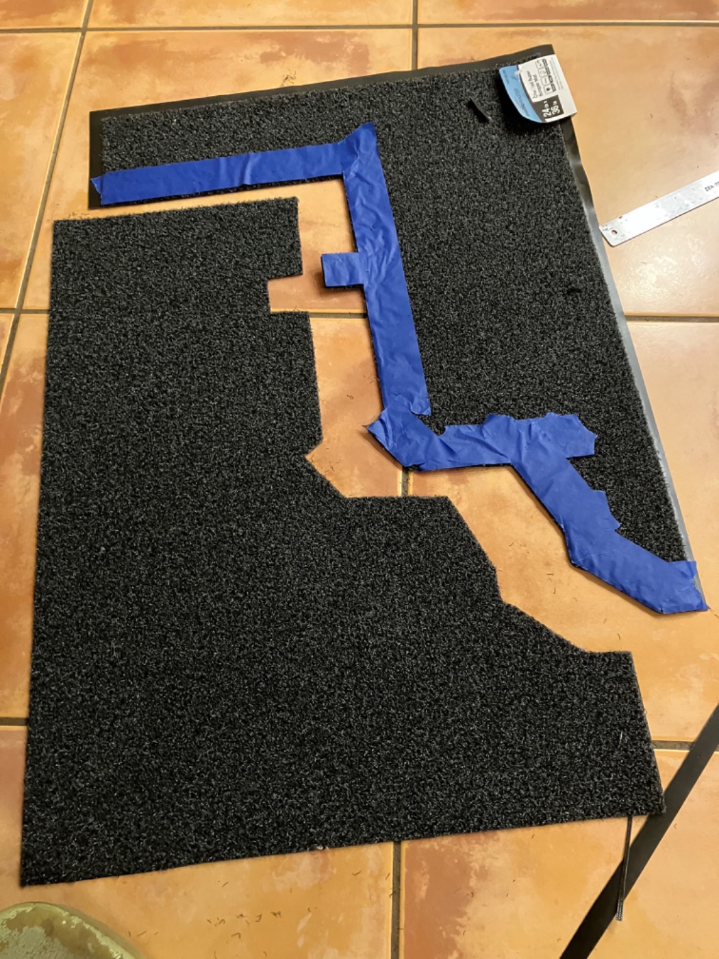

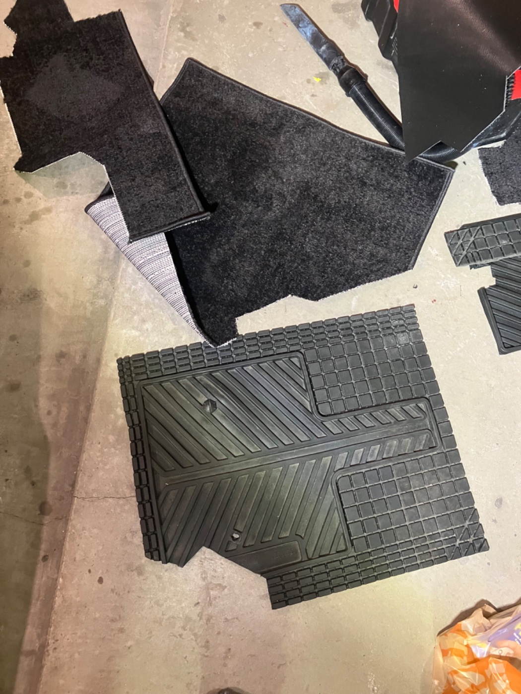

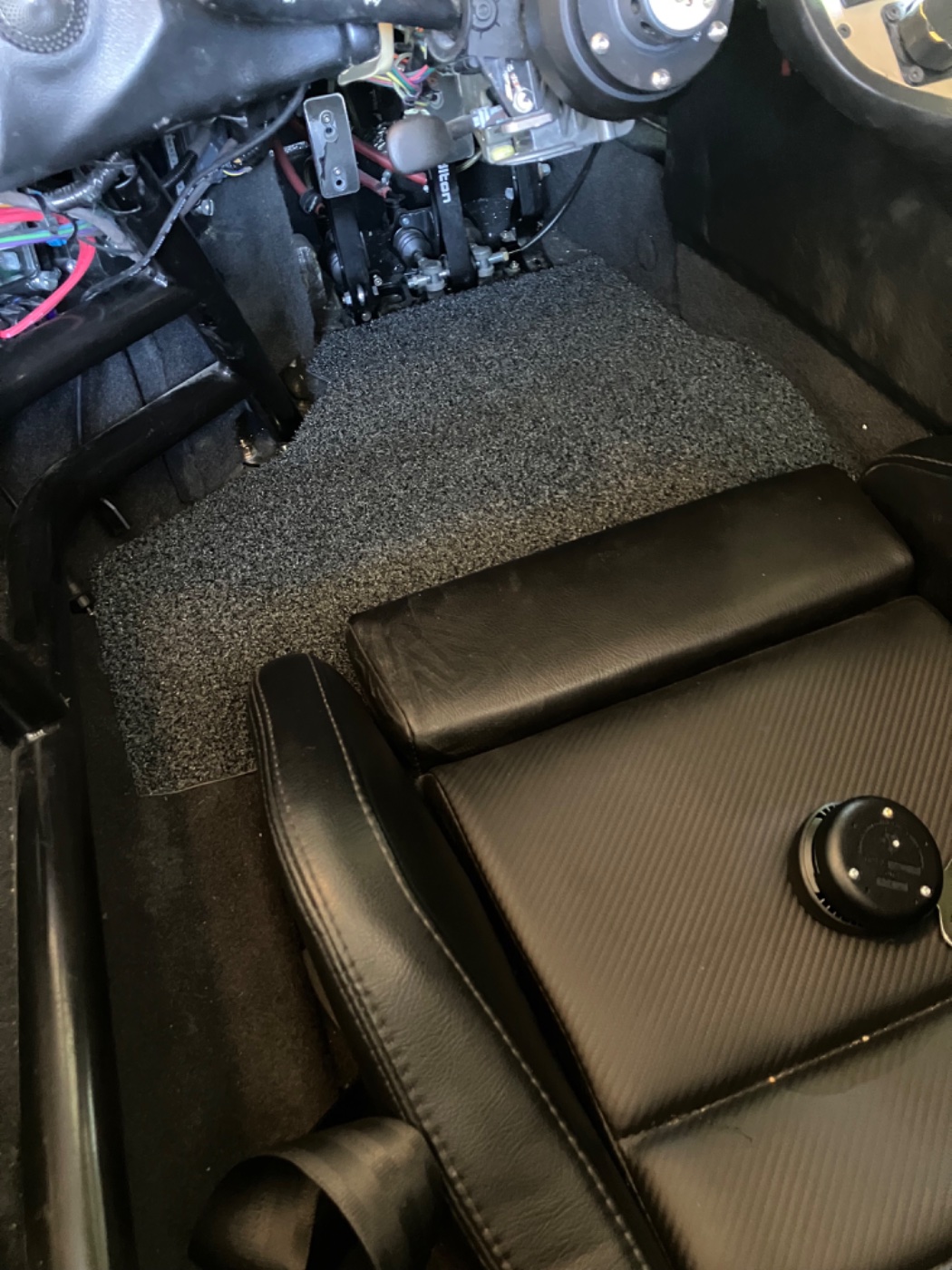

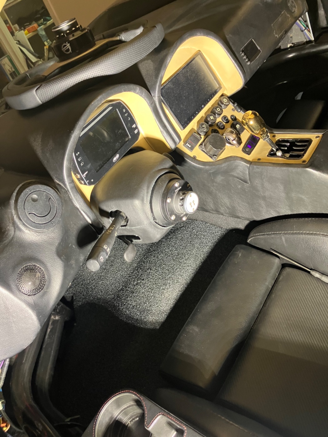

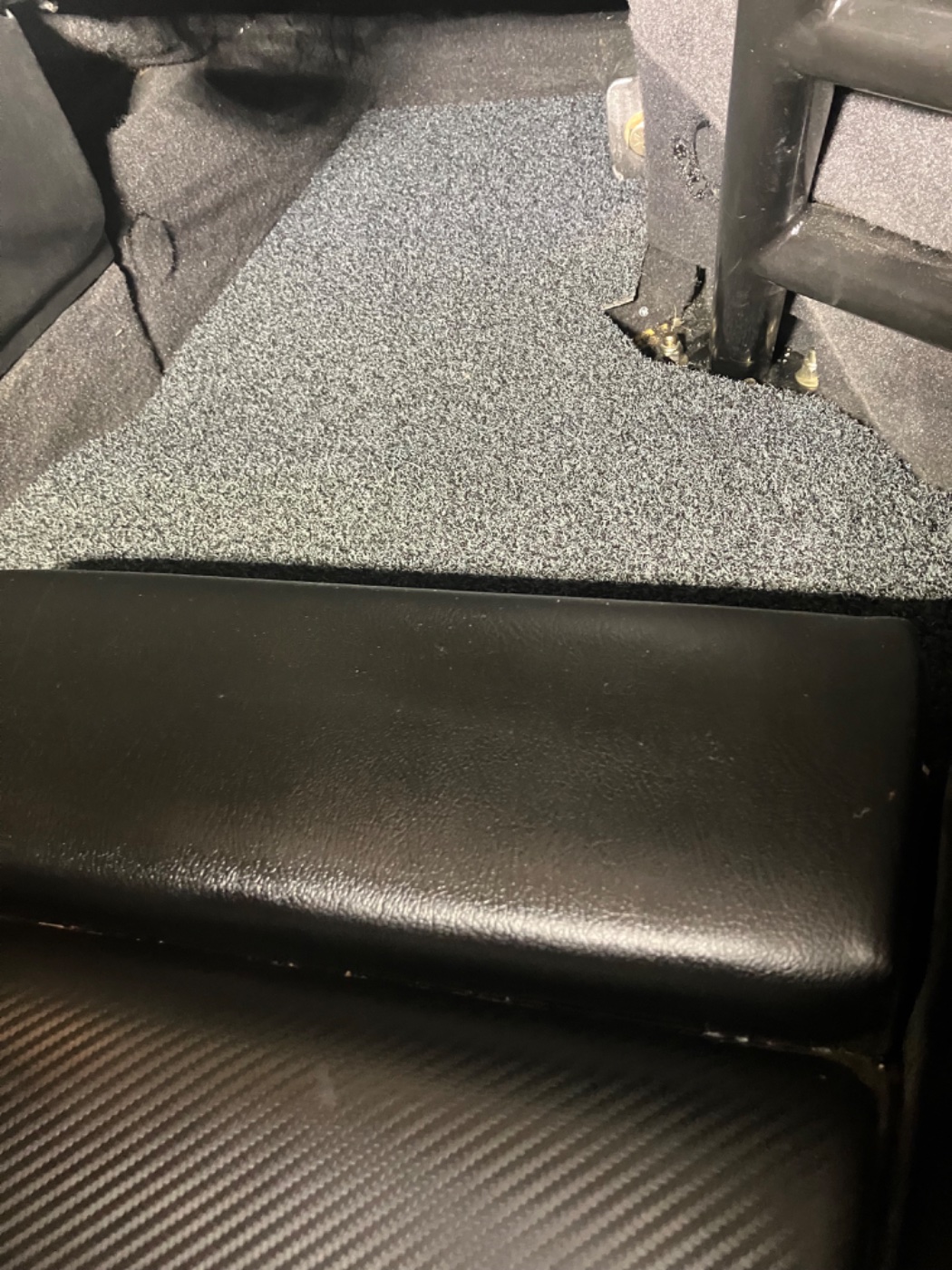

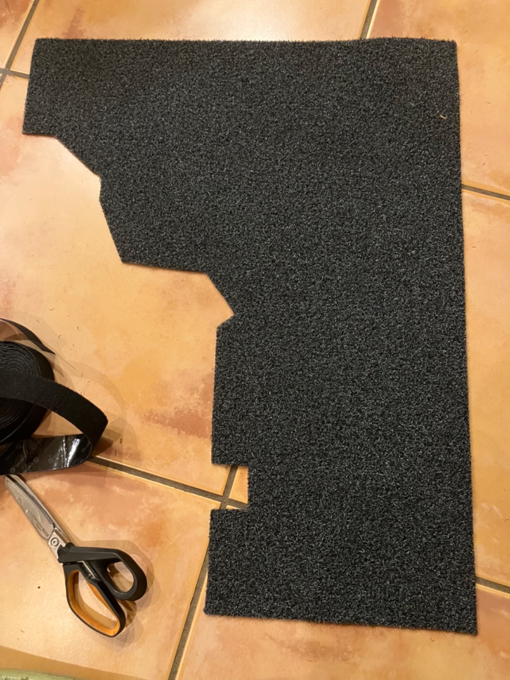

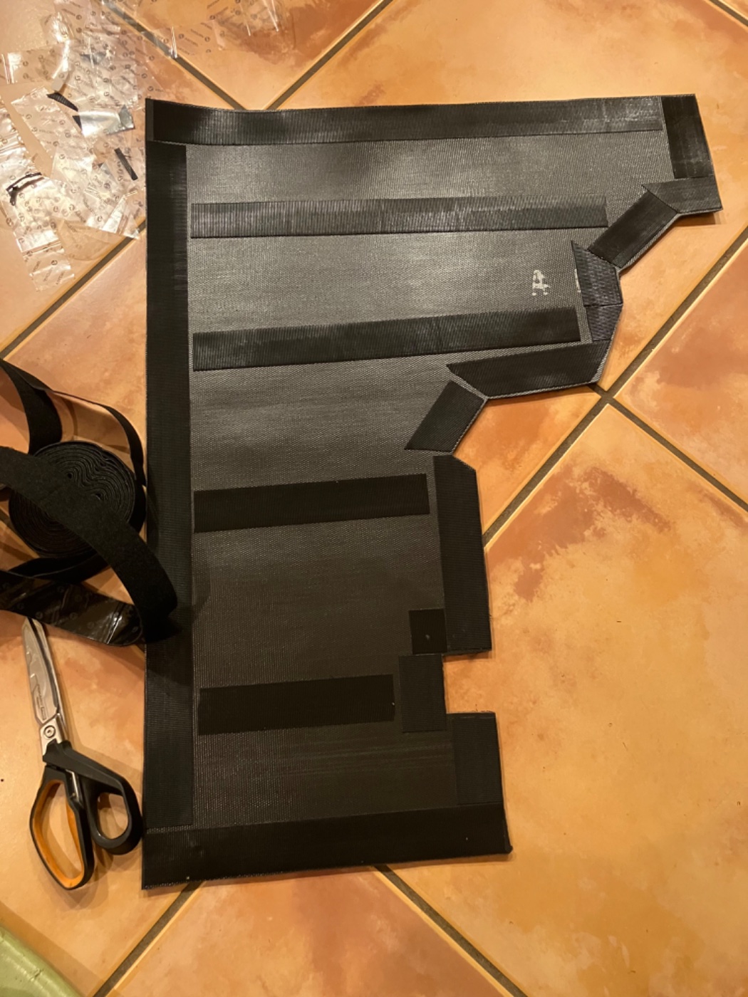

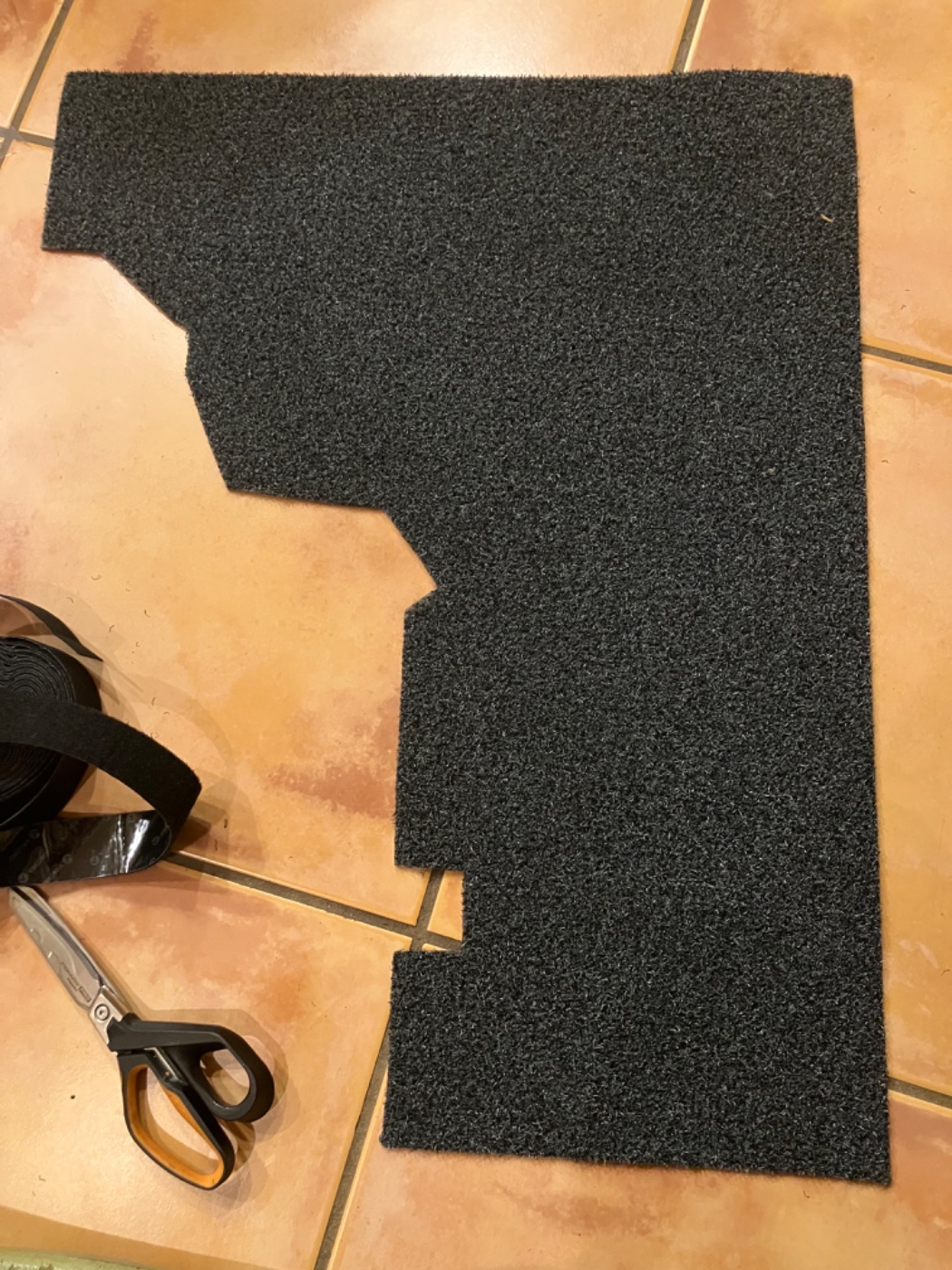

I tried 3 different sets of floor mats before I found a set that i liked , first a rubber one with ribs, then a carpet one , finally found the prefect one , is attached to the carpeting with velcro, it is a high traffic floor mat form home depot, cut to fit perfectly

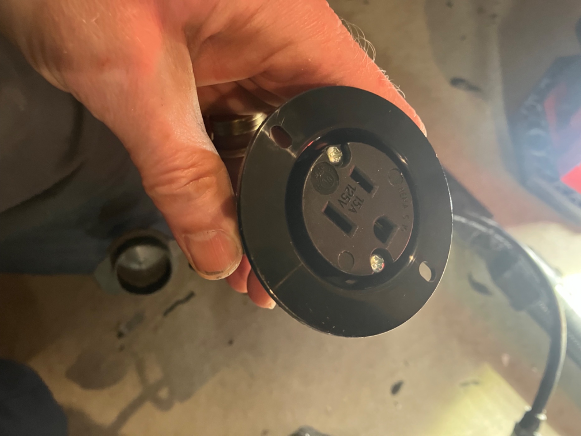

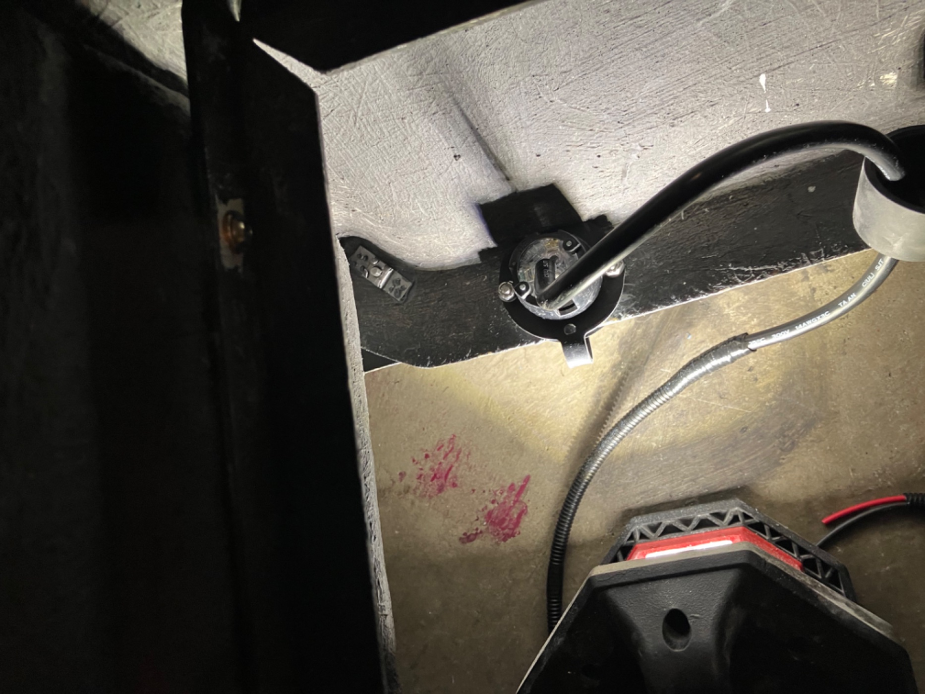

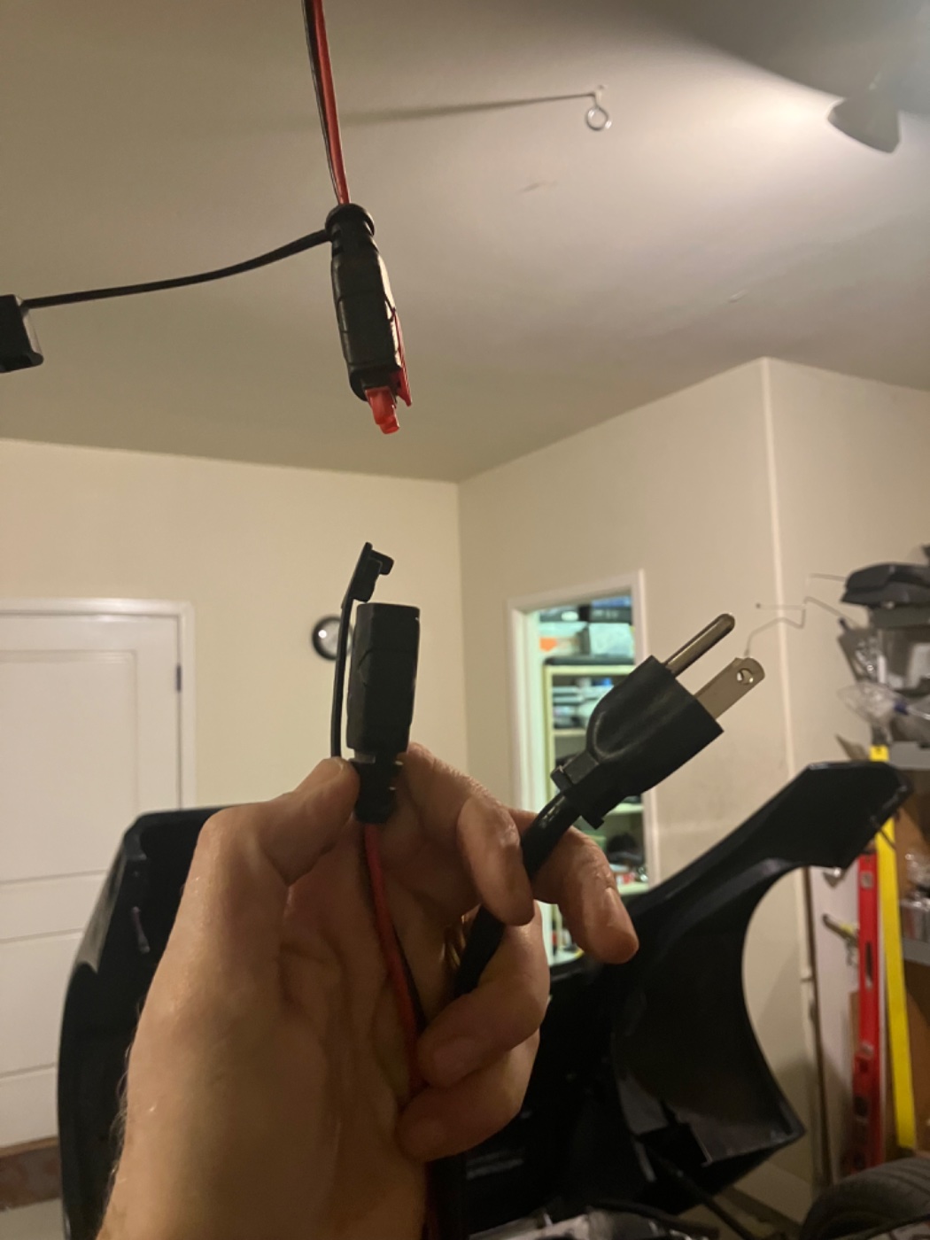

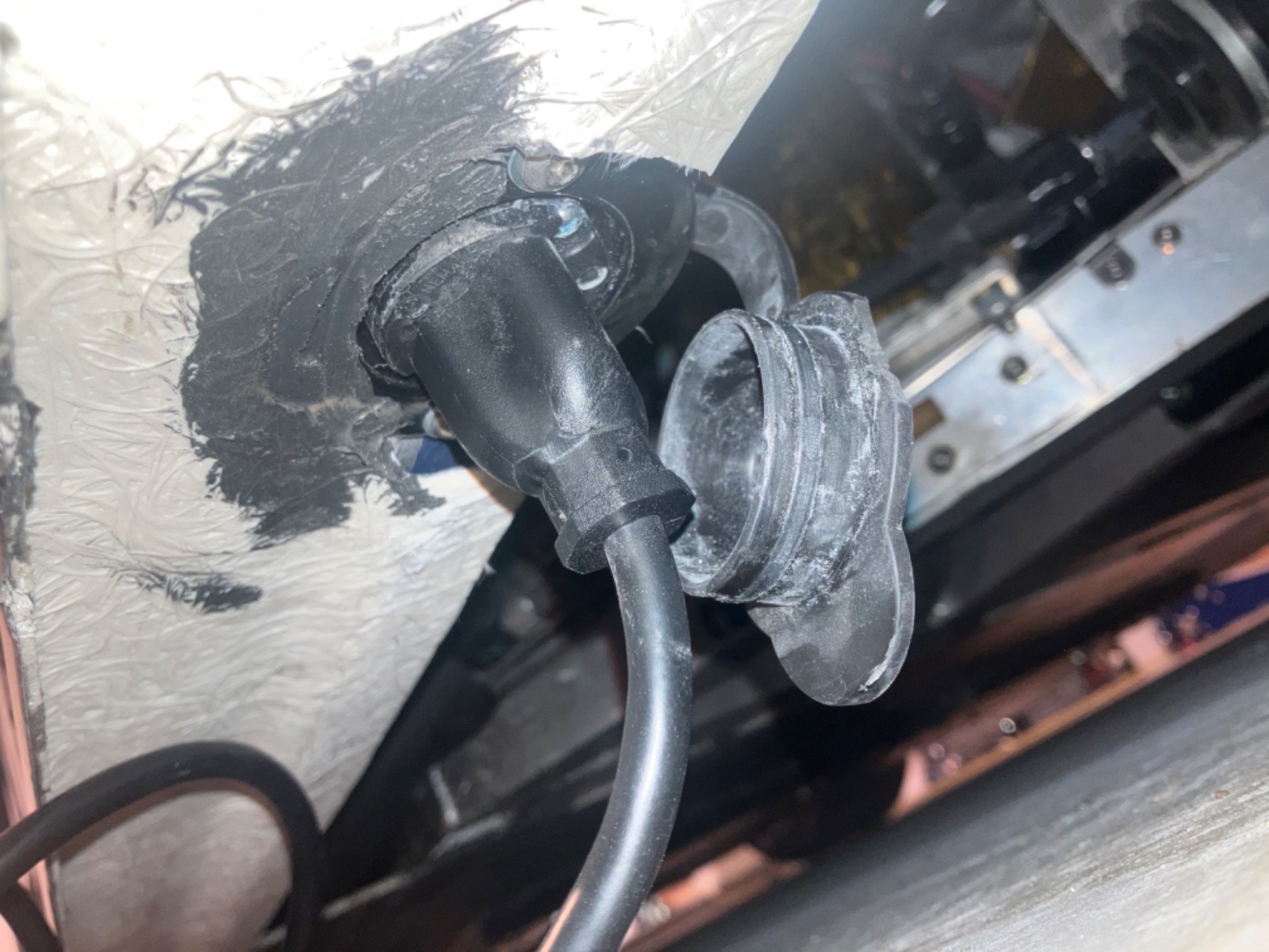

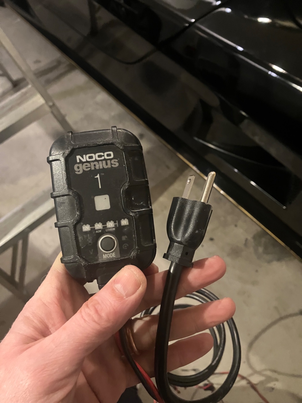

It was a pain connecting the trickle charger to the battery terminals , plus I had to open the rear clam . Solution: a fixed outdoor plug with plastic cover connected to the side terminals of the optima battery. the plug is easily accessible at the bottom of the spider, Works perfectly

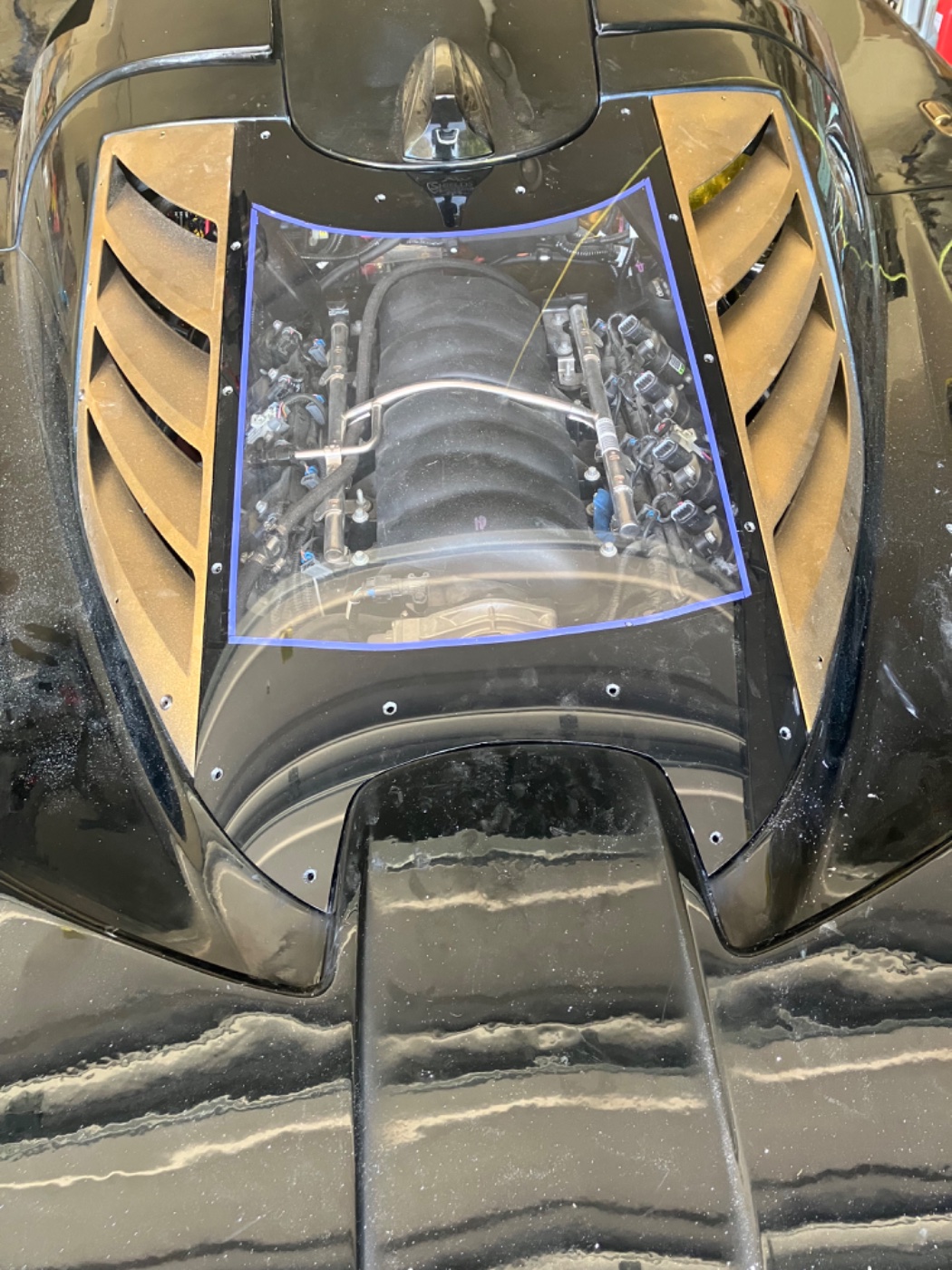

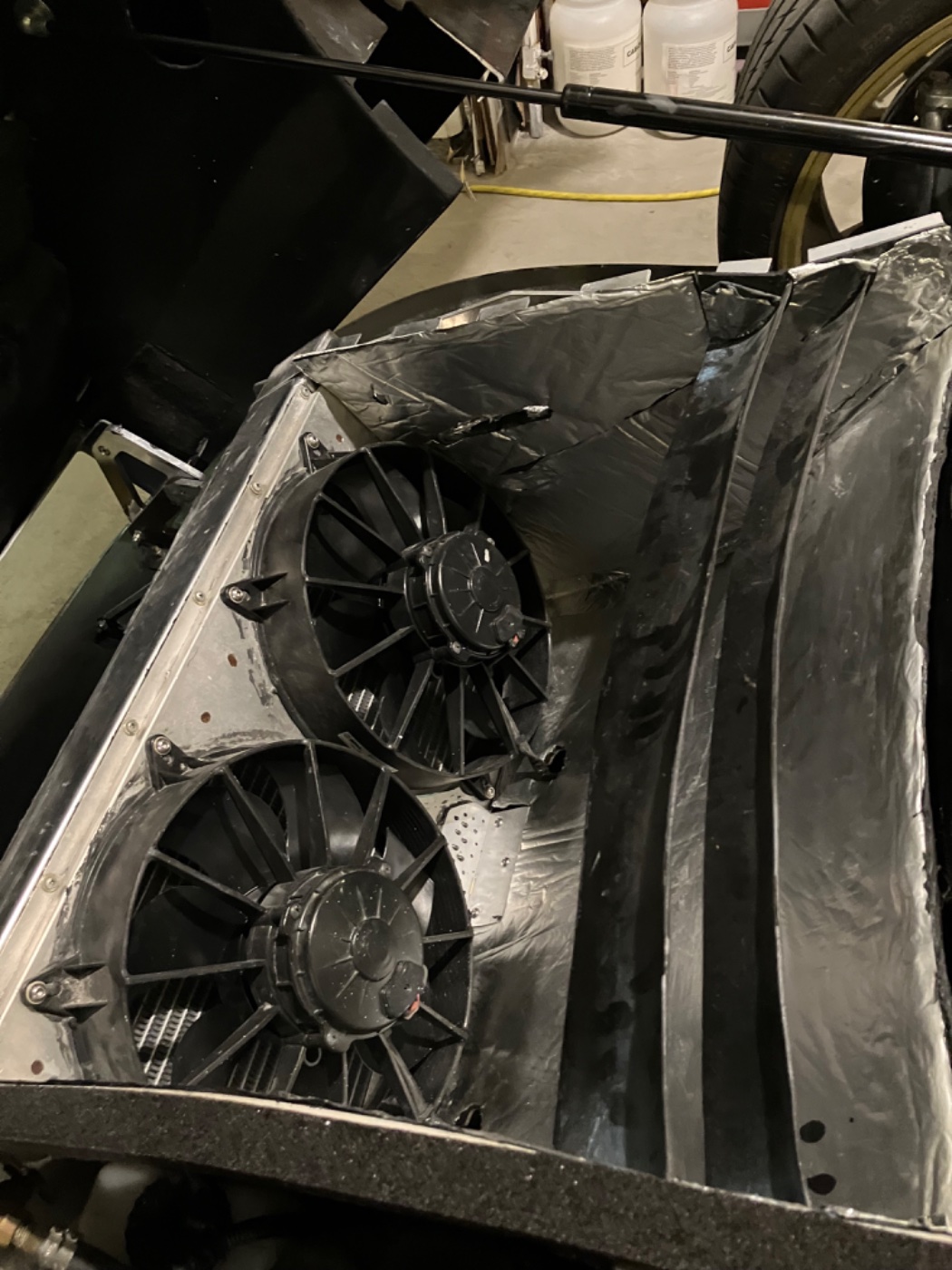

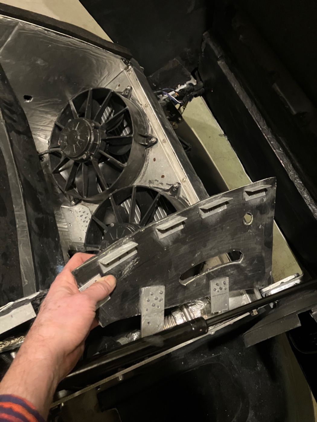

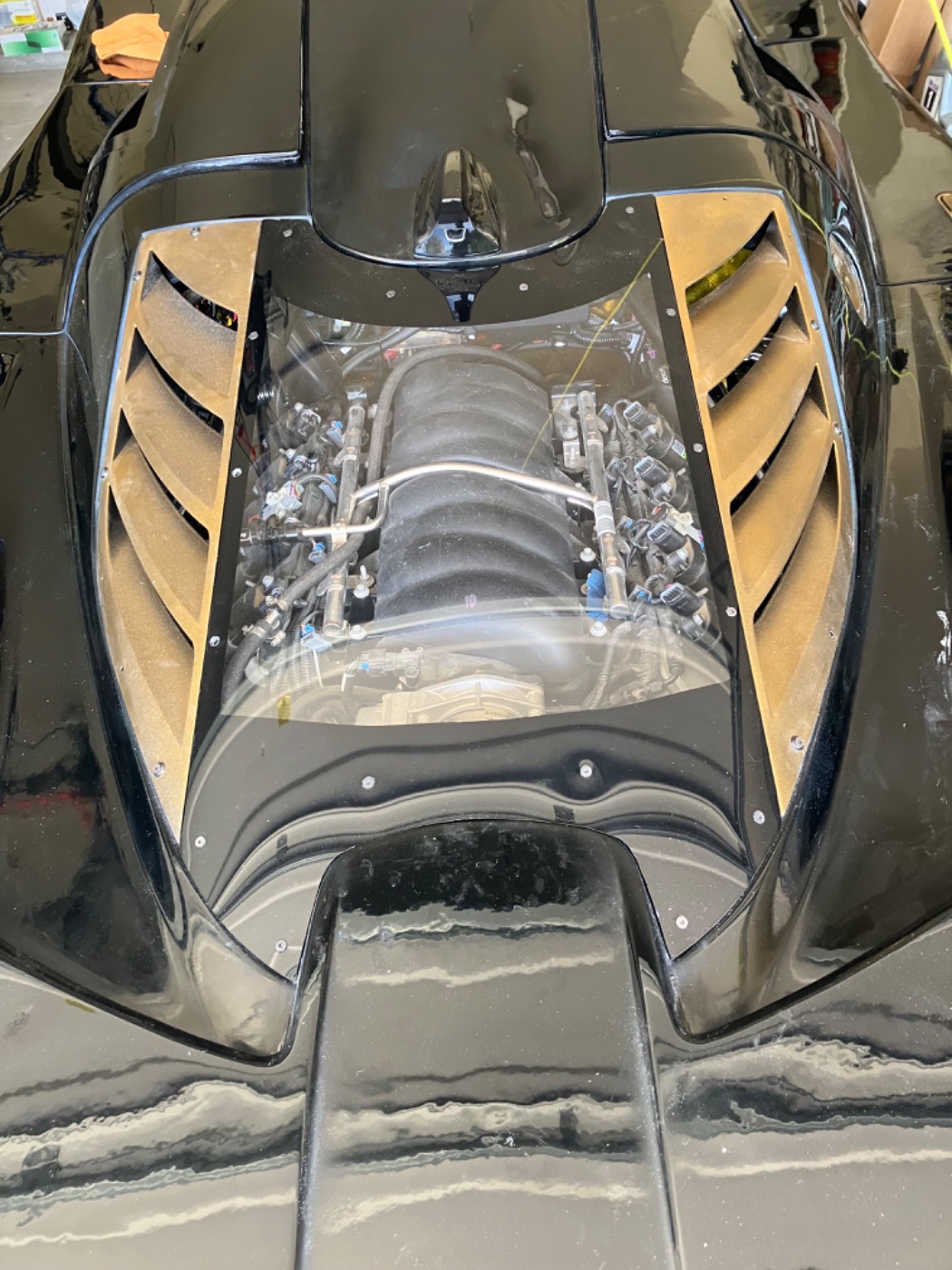

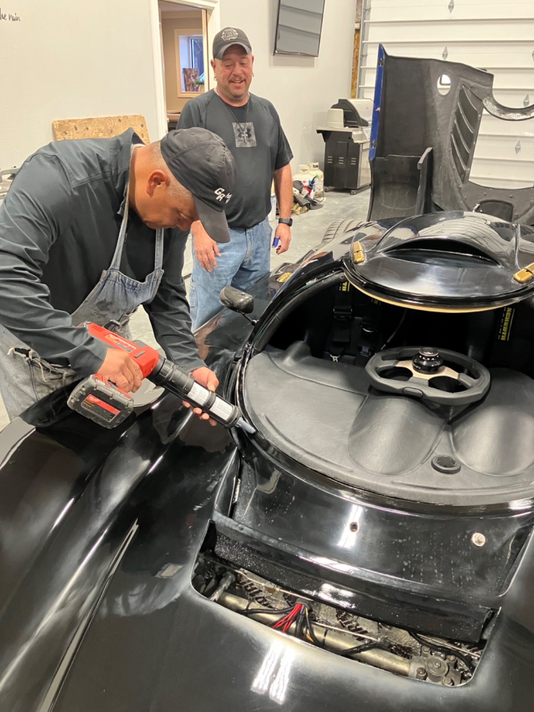

I added expandable foam tape to seal the air duct against the front clam

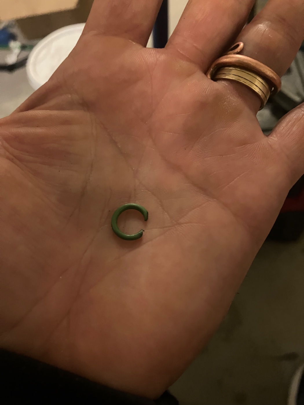

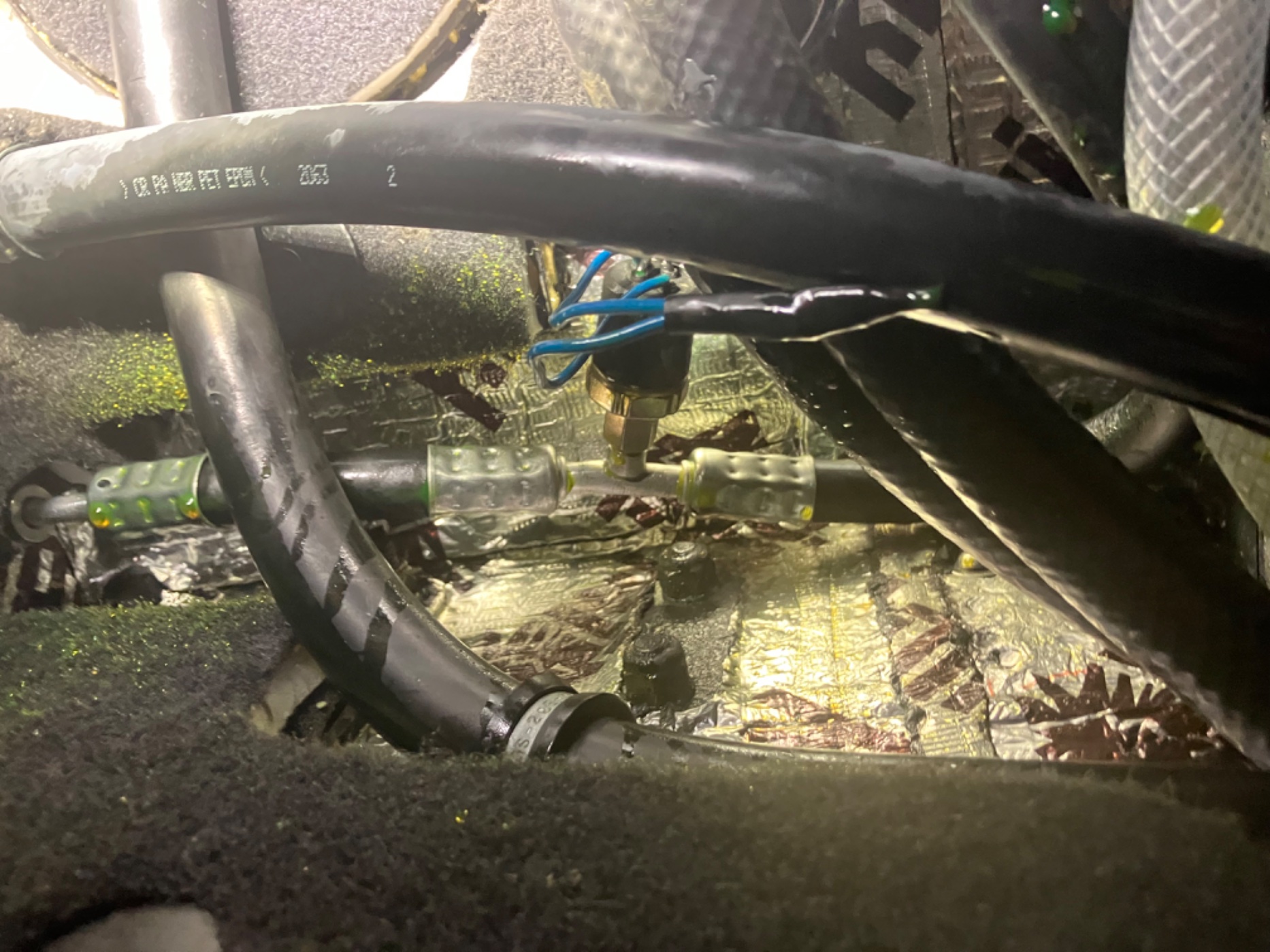

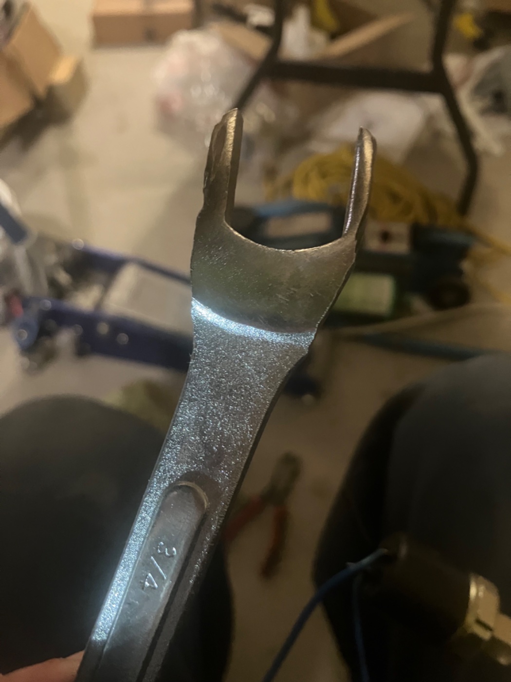

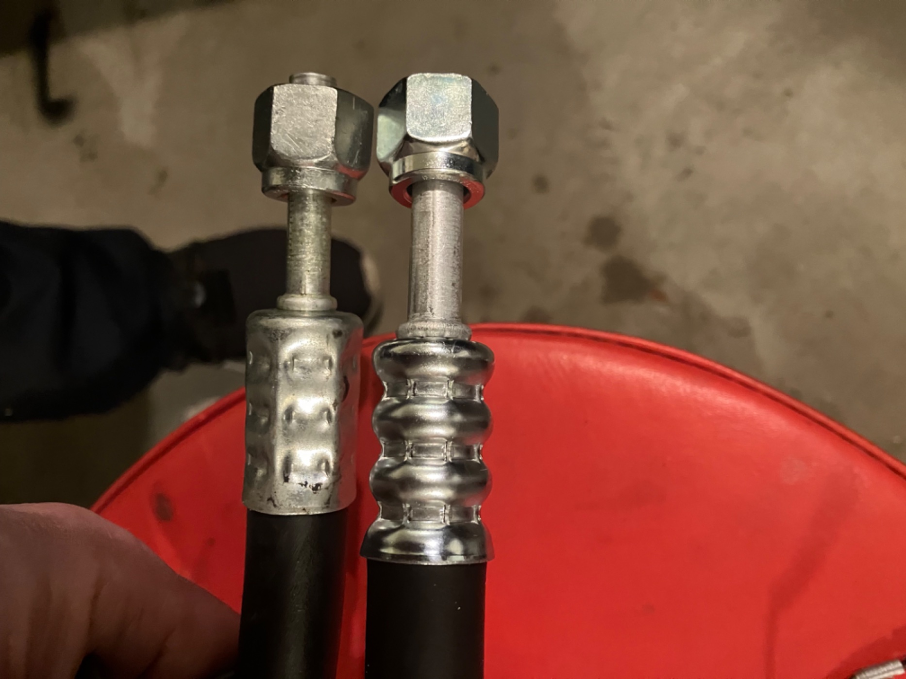

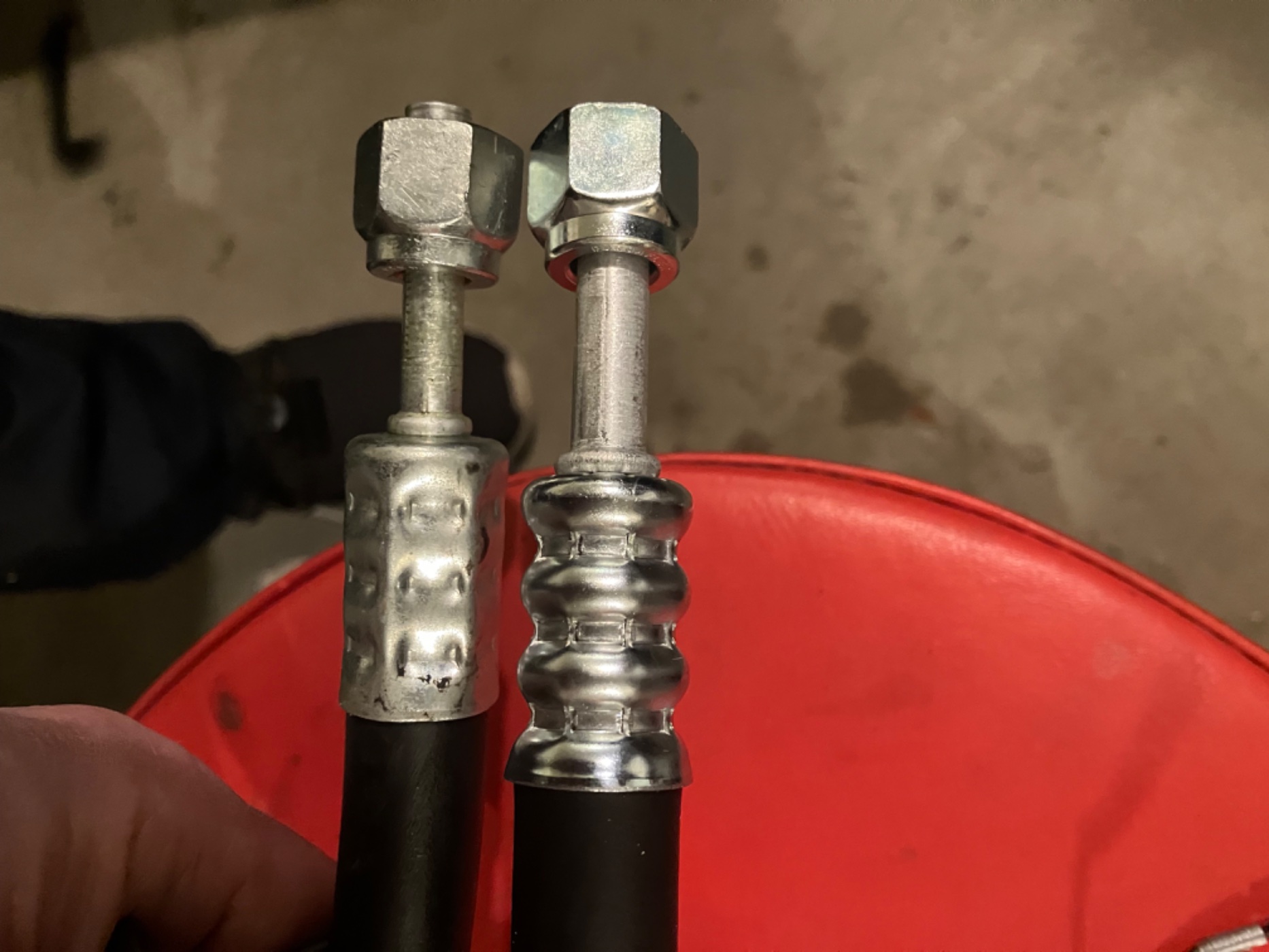

When I was driving around I noticed that the a/c was no longer cooling properly , I recharged it , and blew a large leak , I thought it was one of my crimps that failed, but when I was installing the new hose I discovered a pinched and broken O ring , darn!!! And of course it was the hose with the trinary switch as well , Murphys law, and the most difficult to access inside the footbox.
Well I found out that vintage air offers free crimping for local customers , the new hose is really nice . I also found out that you have to replace the dryer as well .
I am not exaggerating, it took me two weeks to install the new hose inside the passenger foot box, upside down and with one hand only. Both shoulders would not fit at the same time . That was brutal , Also had to cut a wrench to make it fit .
Well, my a/c blows super cold air just in time for spring , yeah!!!

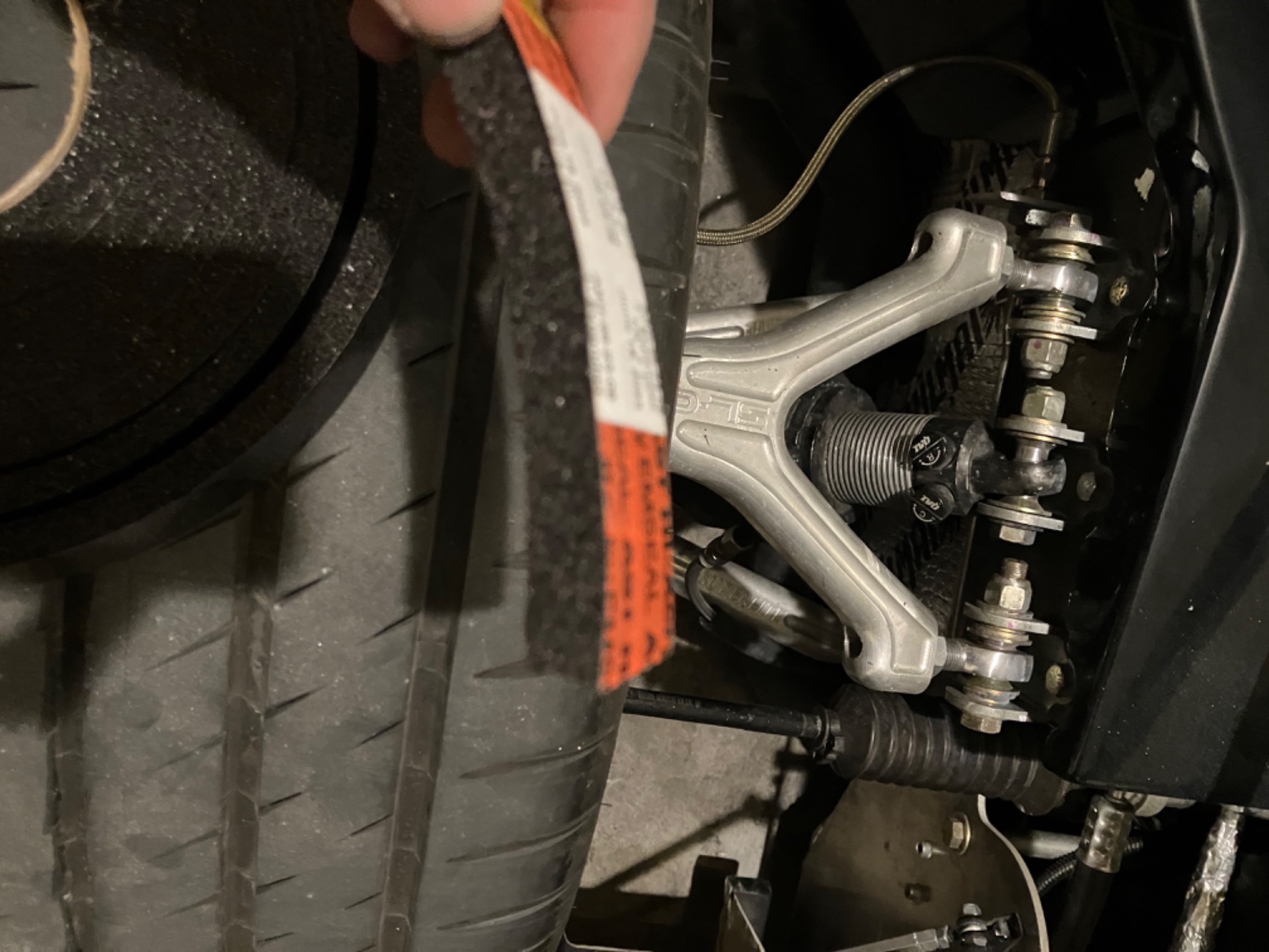

Hector

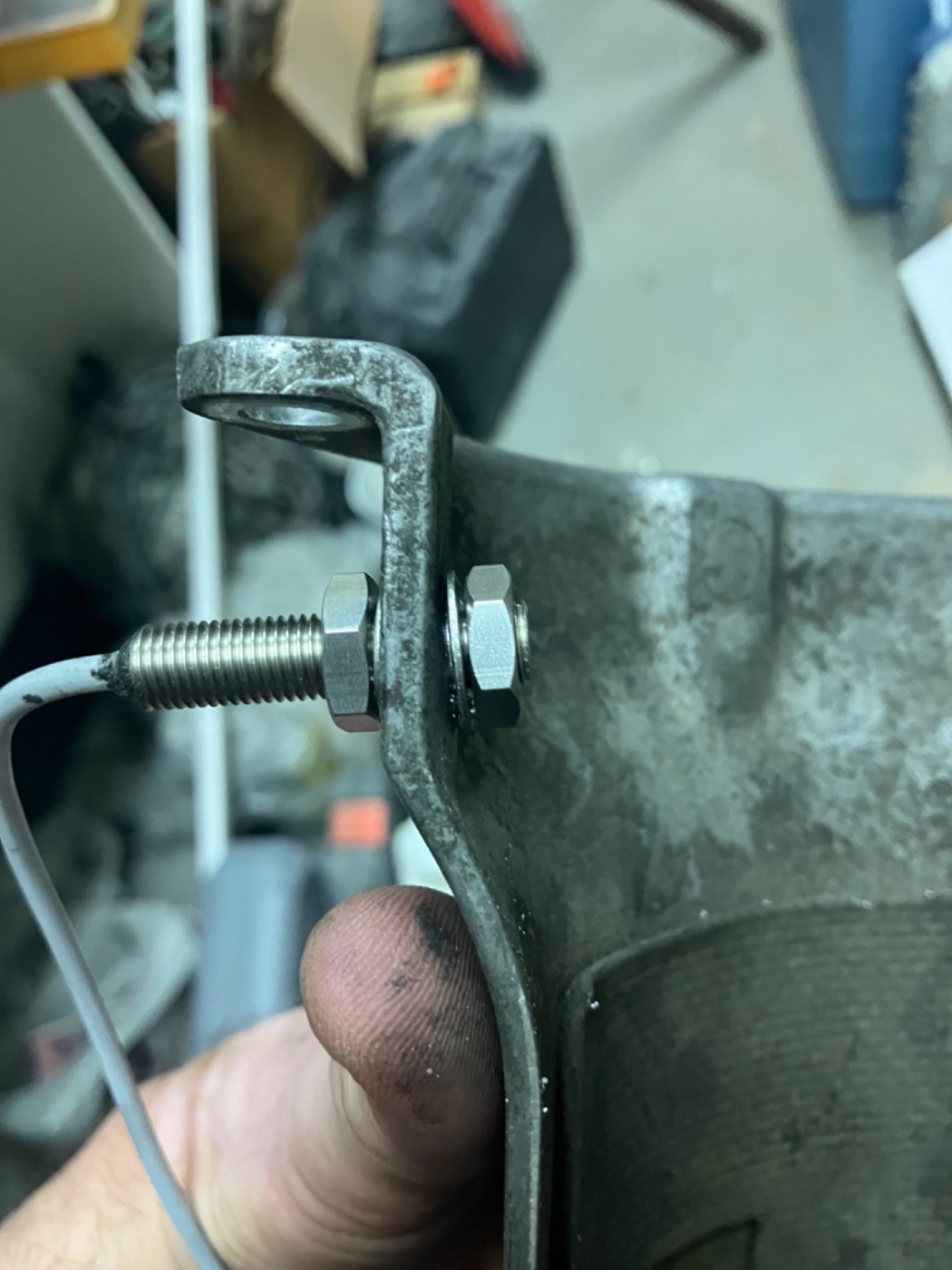

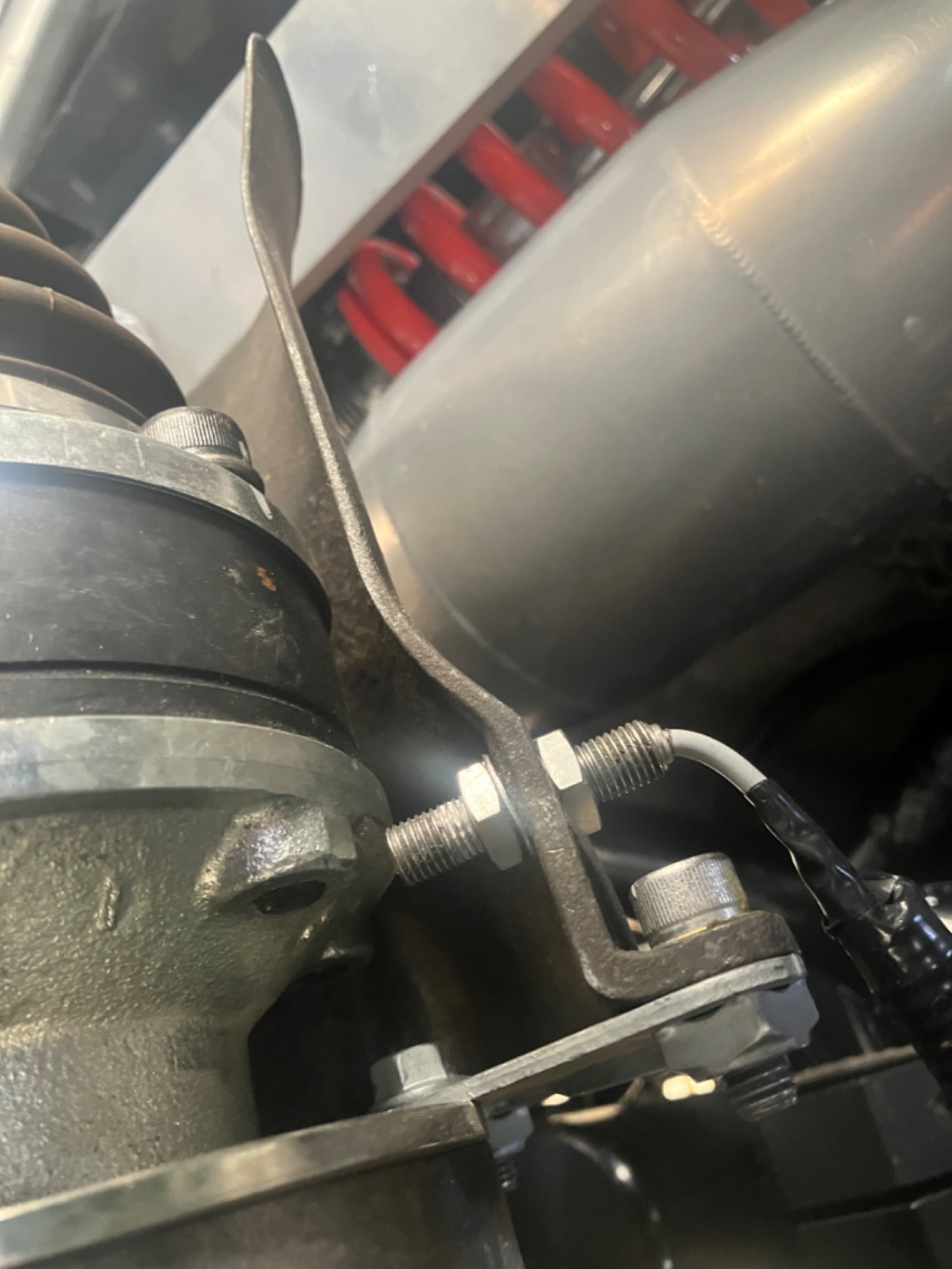

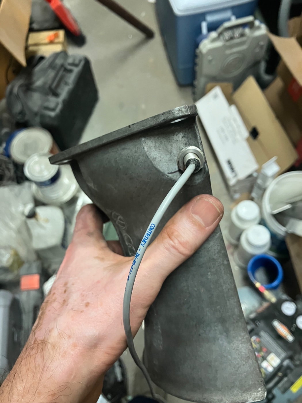

I installed rpm sensors for the traction control unit on each rear tire , I used the half shaft heat shields as the mounting surface and the back of the drive shaft mounting bolts as the triggers

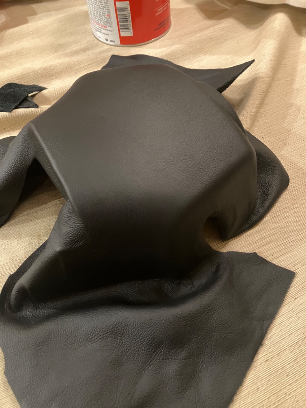

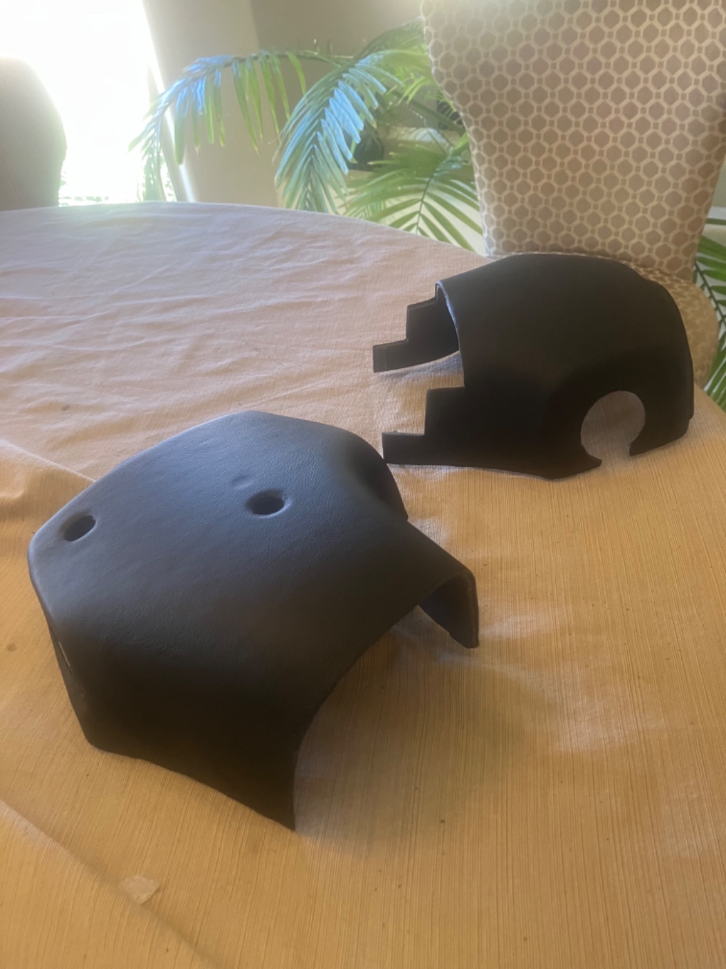

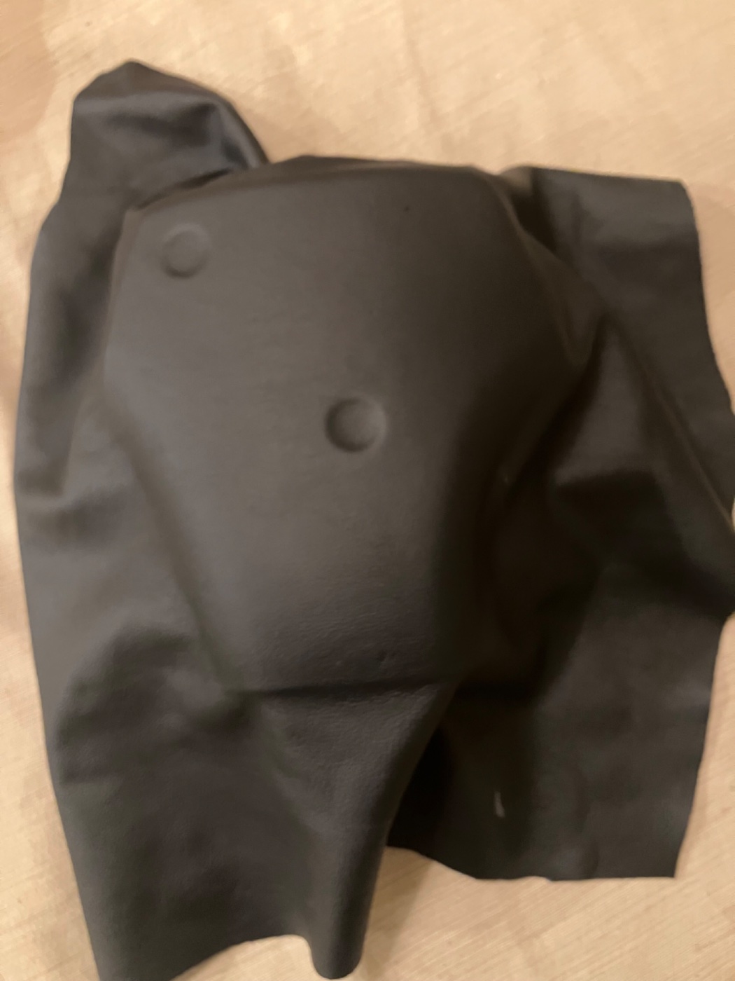

I wrapped the steering column cover in black leather to match the interior. Getting good at the leather thing :-)

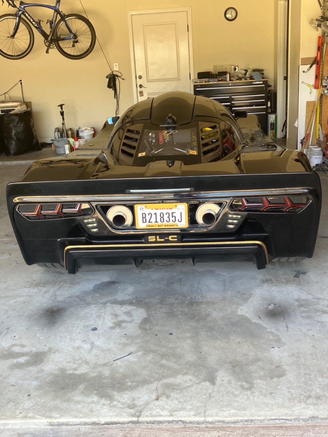

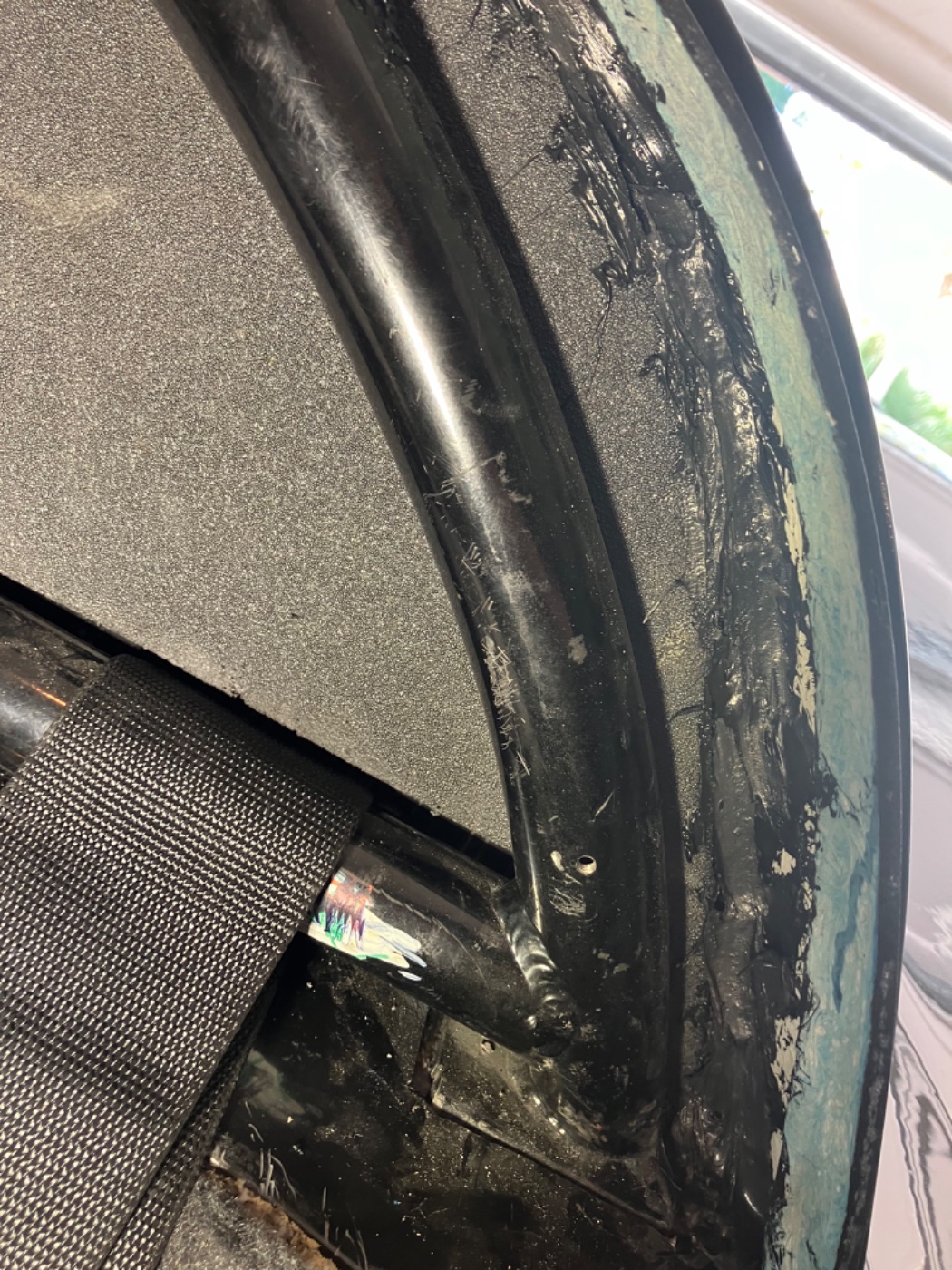

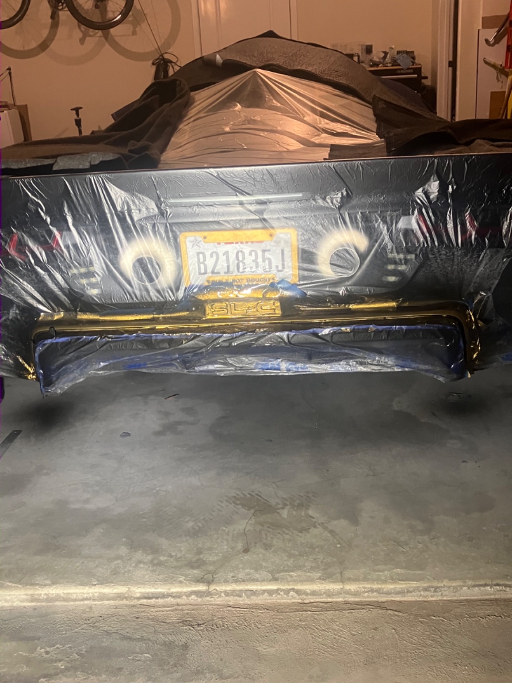

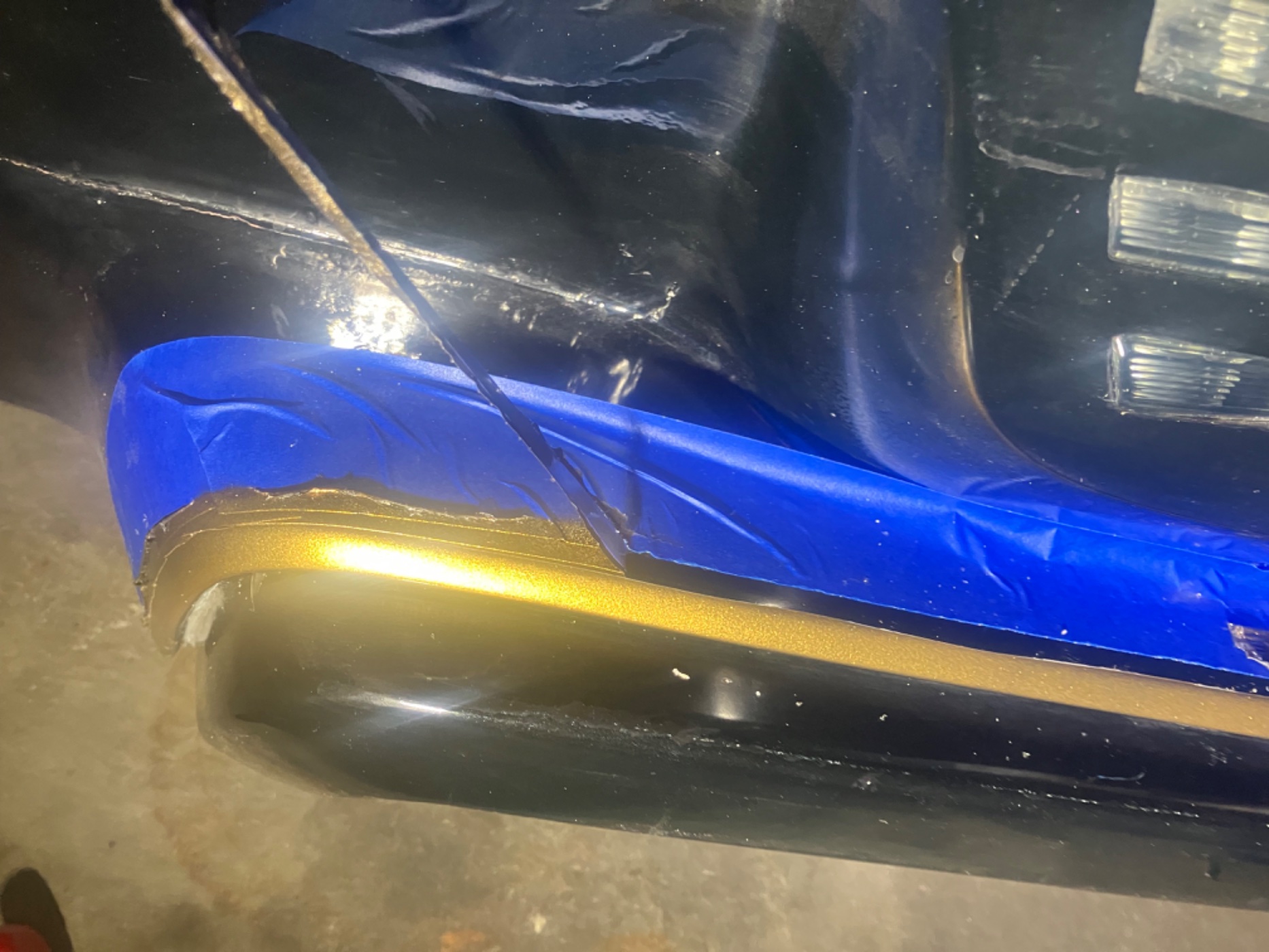

To put final touches I added a gold stripe to the rear clam as well as plasti dipped the SLC letters gold to match, and added 2K clear coat for protection . Really love the gold touches on the black paint

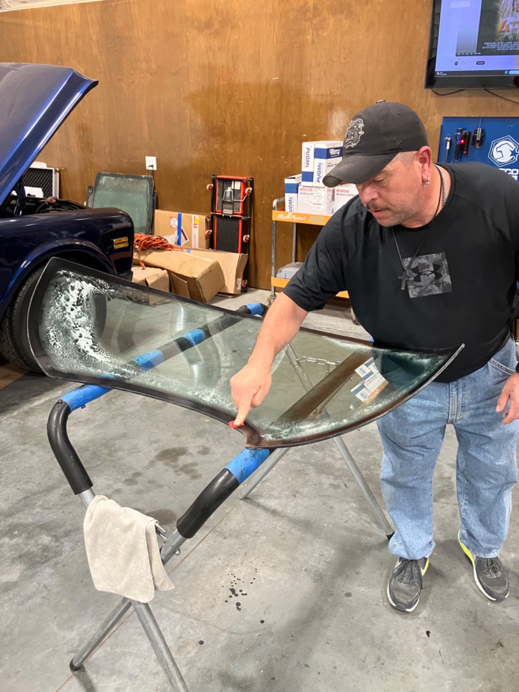

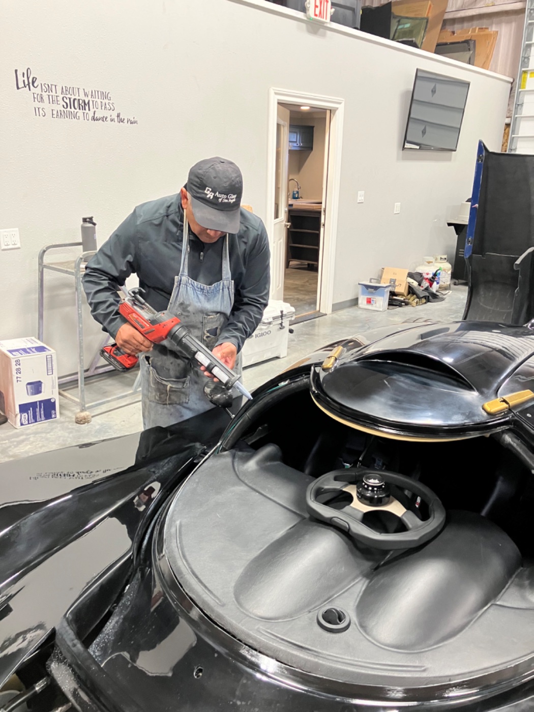

Hector

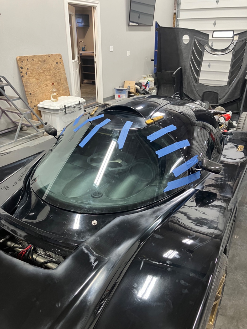

It was time to install the windshield . Decided to let the pros do it, only charged me $125. Totally worth it . The owner ended up doing it , super cool guy who loves cars

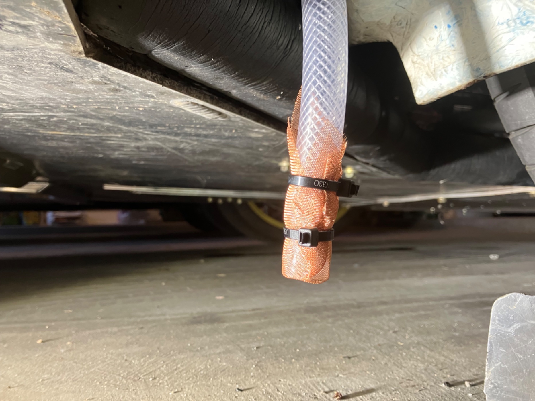

added some mesh to the a/c drain to keep bugs and debris out, it comes through the floor and it is secured

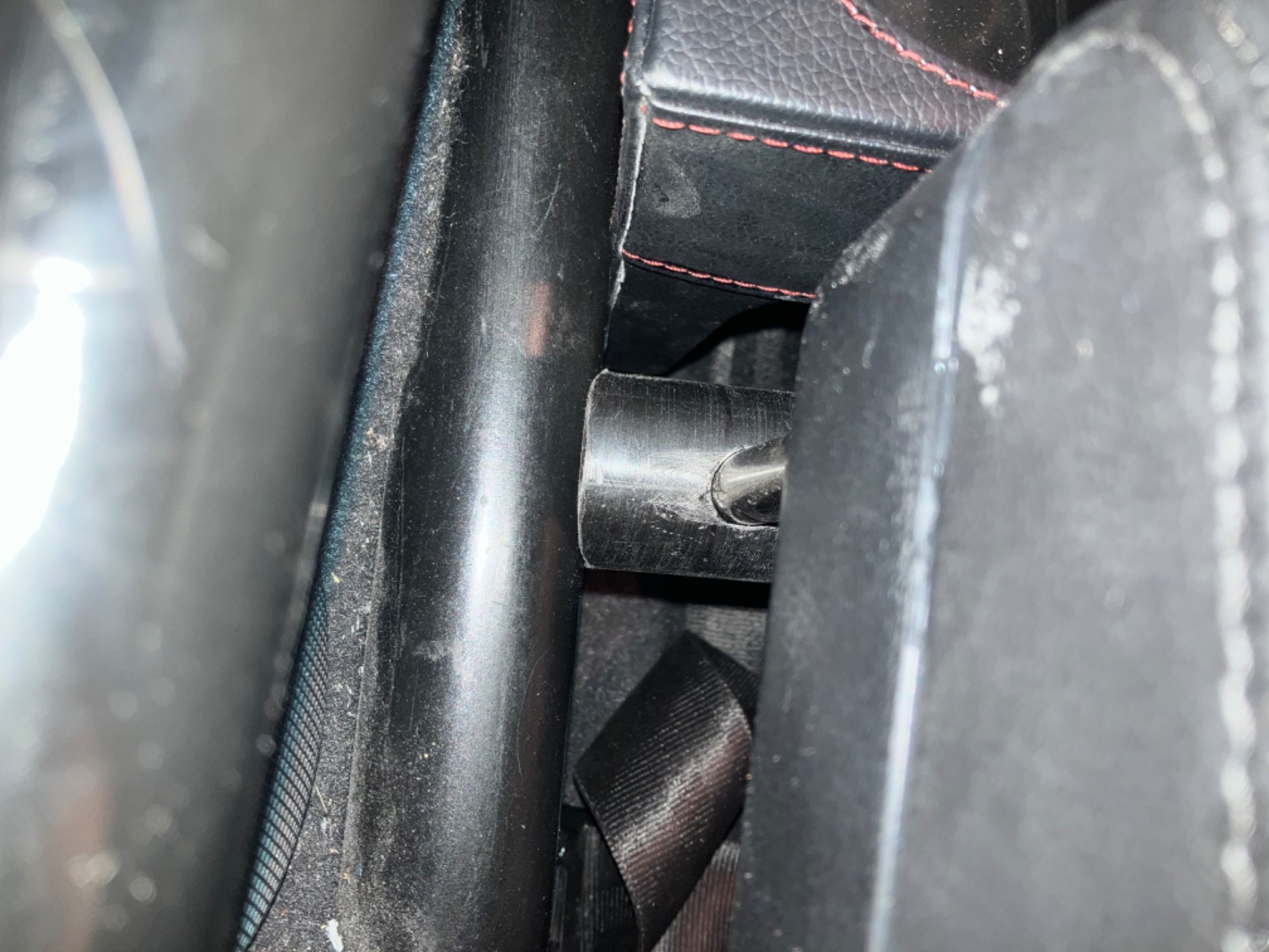

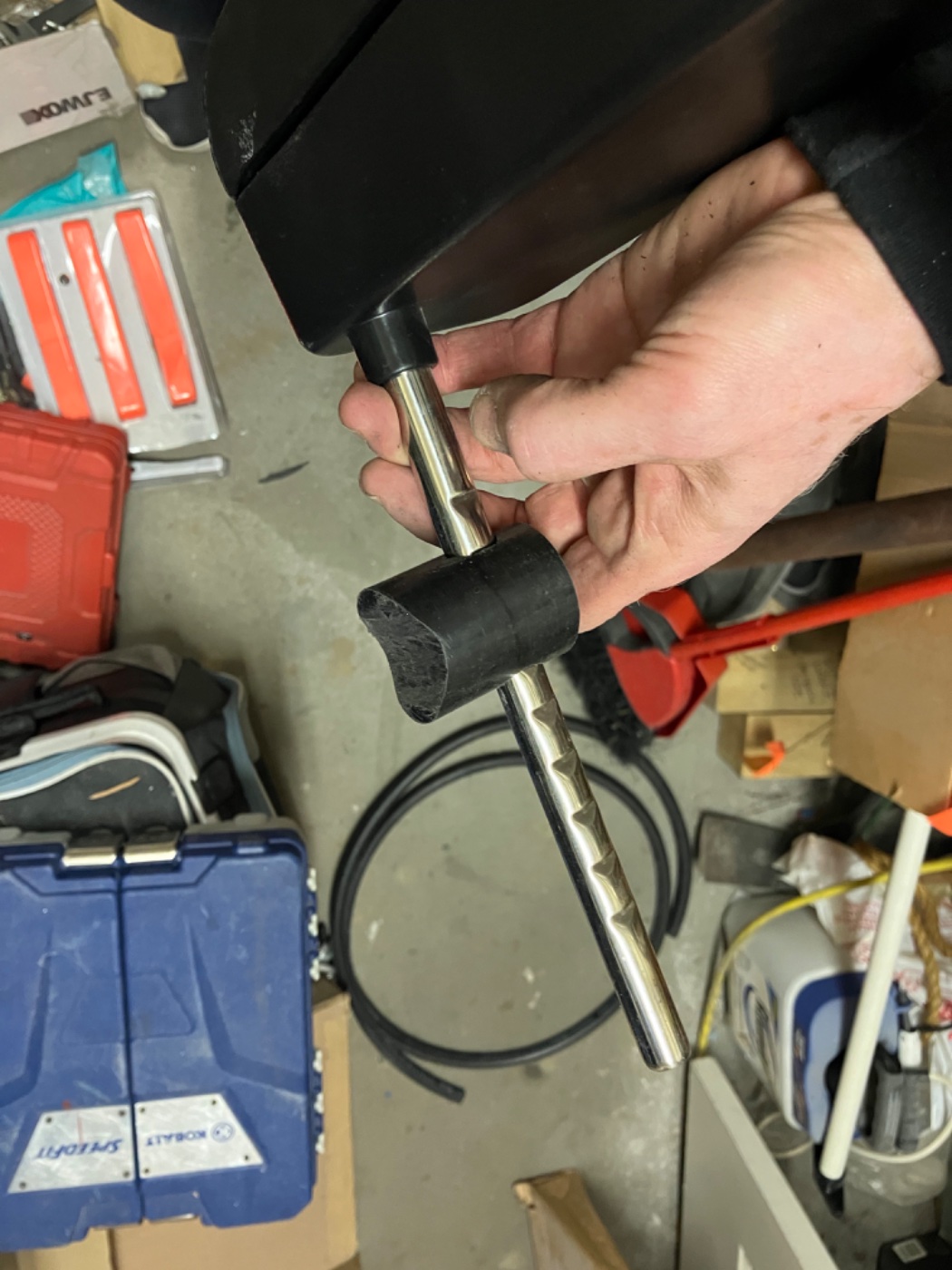

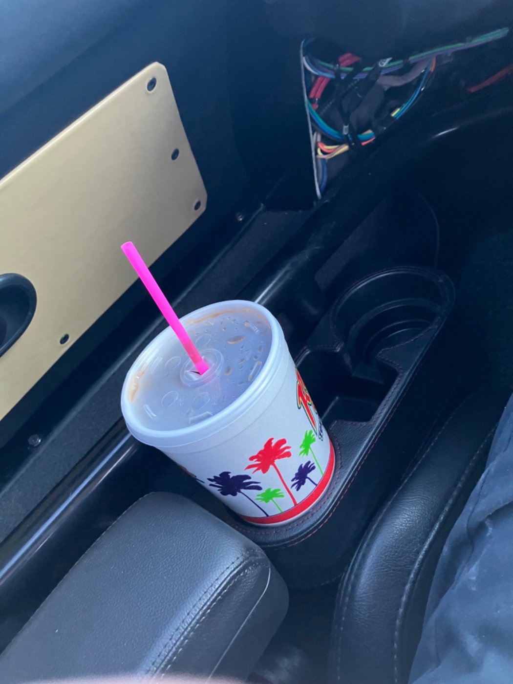

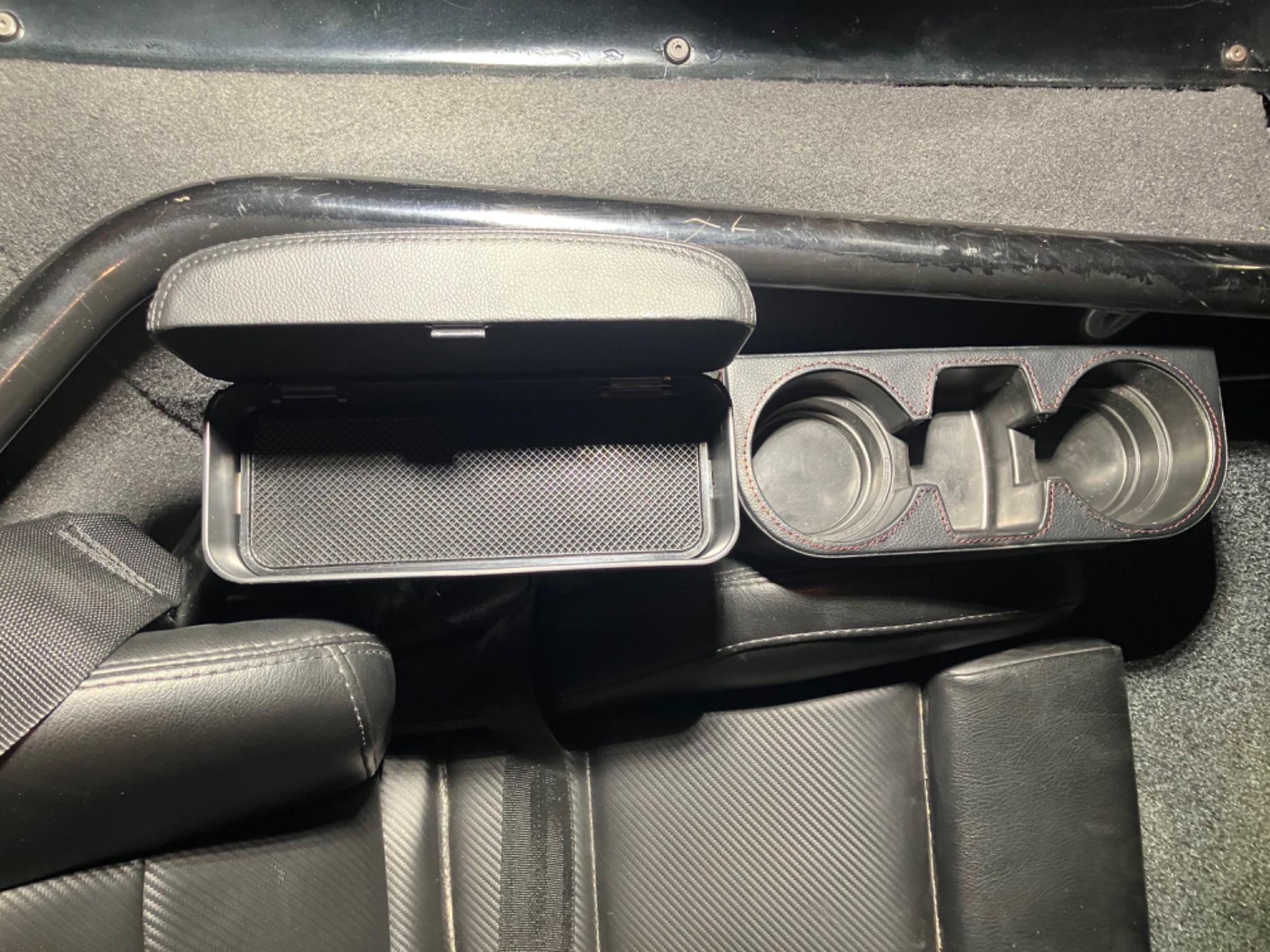

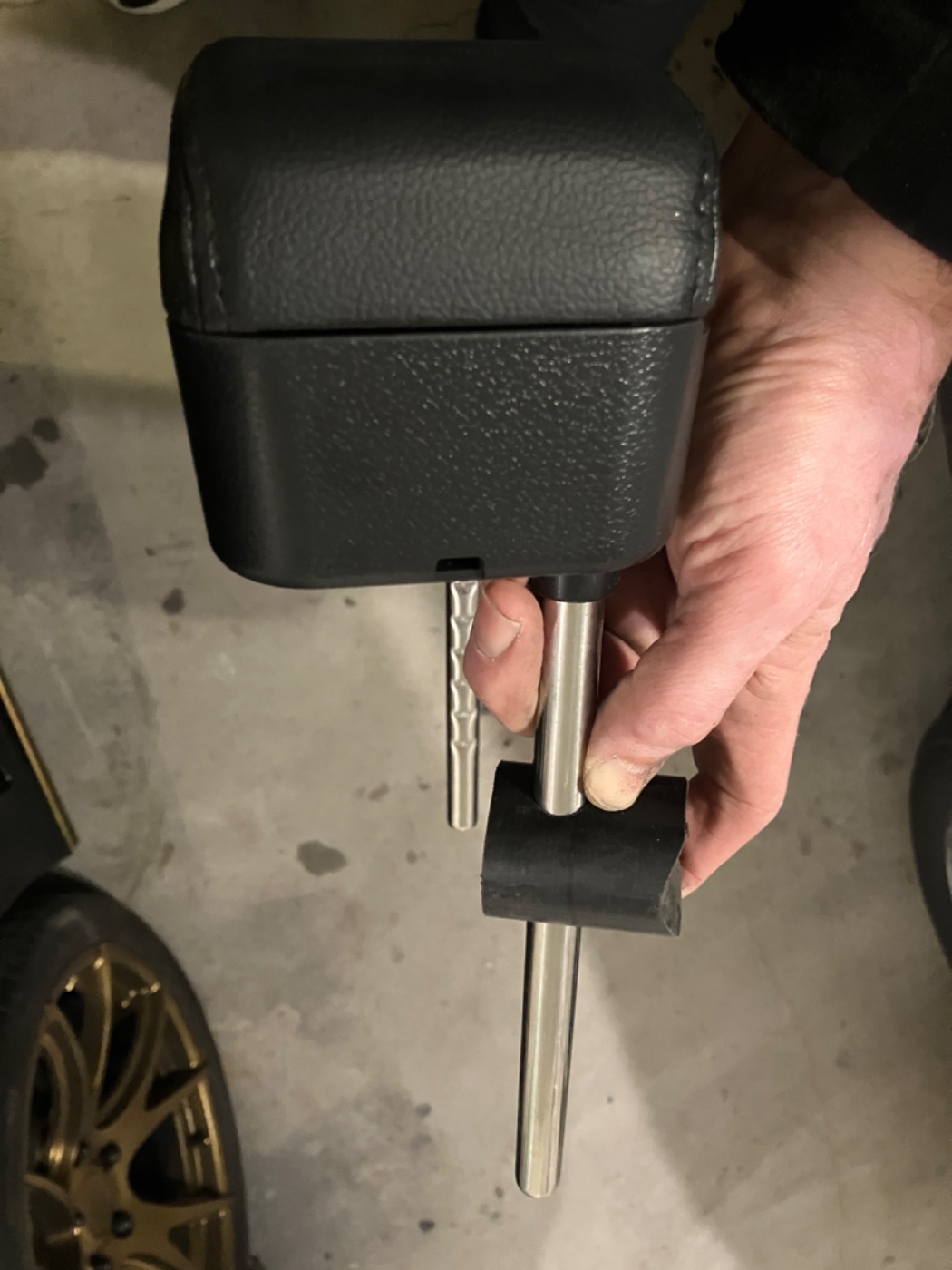

added a cup holder and an arm rest that has a storage area as well, attached them to the side impact bars using the plastic rod I had leftover from the dashboard spacer . Turned out very nice and very practical . It is as practical as you can get for an slc :-)
Of course I made a food run to Rosas to test the cup holders .

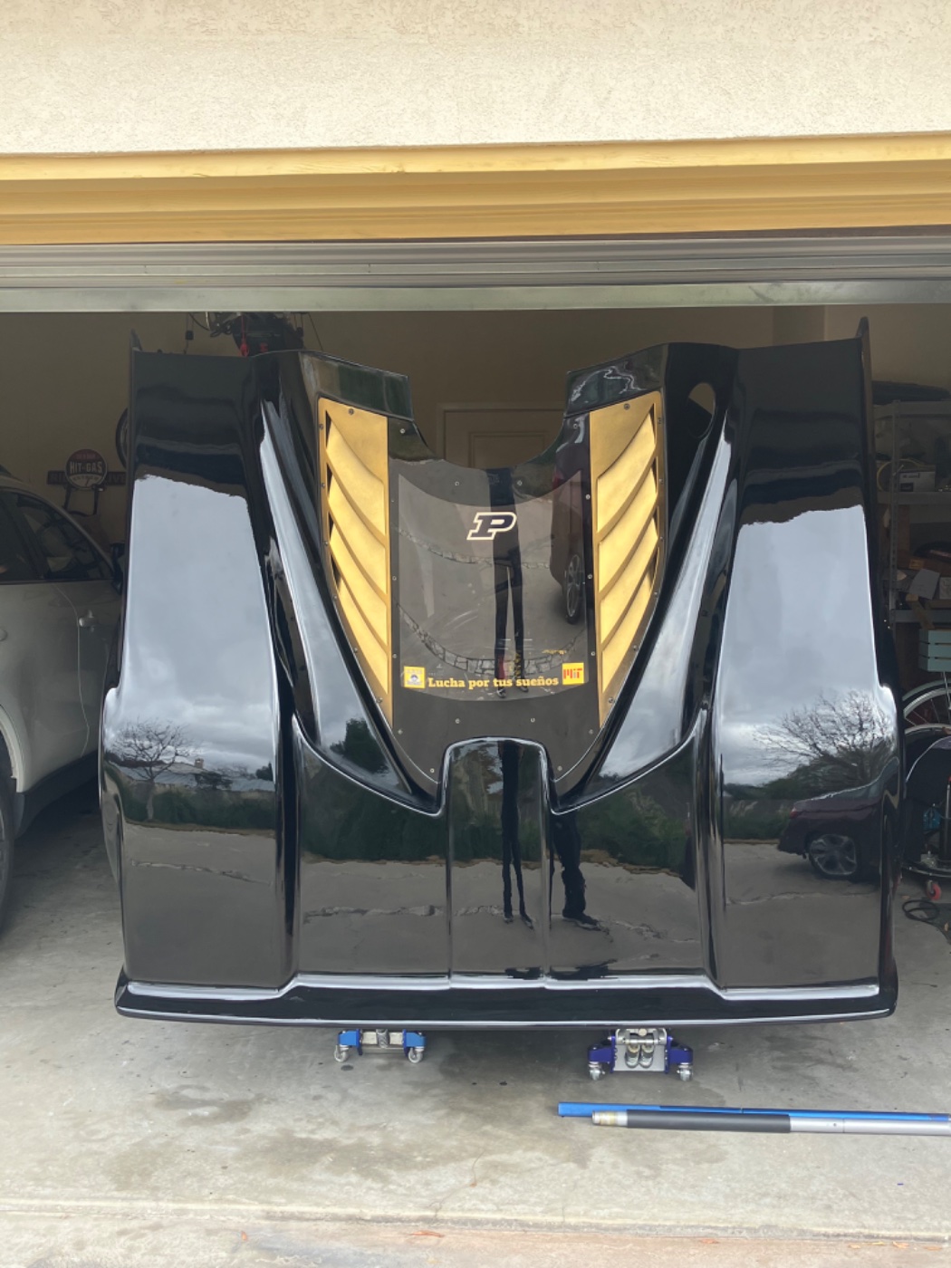

And to finish up my mega update , added a few touches to the rear clam window
Fight for your dreams in spanish with gold letters. the P for Purdue , my alma matter , and Rice and MIT stickers where my kids go to college.
